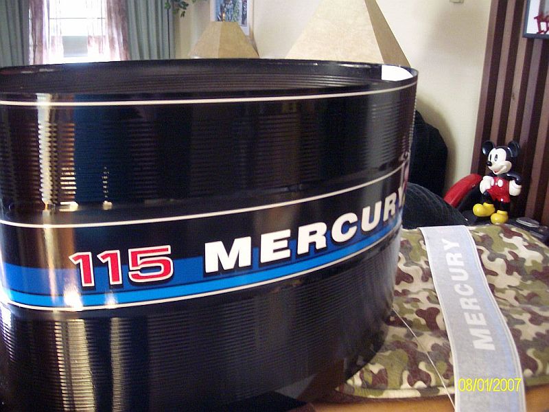

I used my heat gun to remove what was remaining of the decals on our 115 tower and removed any adhesive residue with acetone. Prior to removing the decals I took my hood in to a local sign shop that replicated them for $34.00. They even printed off an extra set for me. They look nearly identical to the originals and if I should need another set for any reason they have everything on file and can print off another set or any portion that needs replacing
