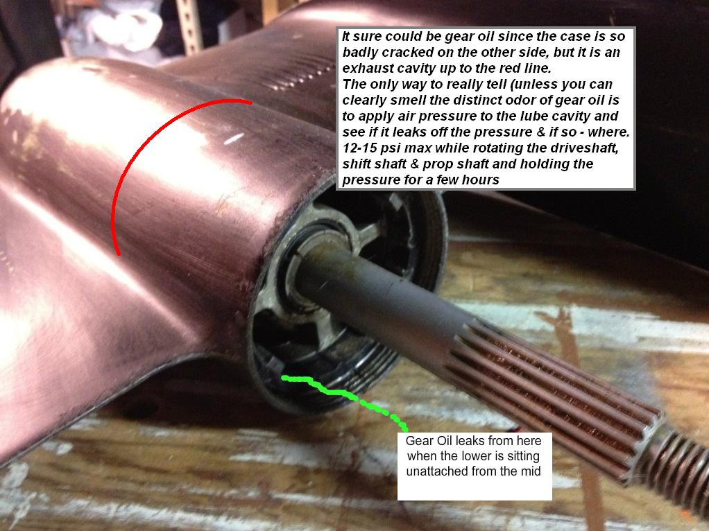

Often, the oily ooze found dripping from the lower unit is just fuel mix and carbon goo wicking its way down the exhaust and out the prop-shaft opening, but given that you have found water in the gear oil it does sound like it needs to be re-sealed.
This is a typical failure on the older lower units because they have a steel driveshaft & propshaft. Consequently water stands and rust forms at the seal positions, causing the seals to leak.
Unless you find fishing line spooled around the prop shaft and propshaft seals area, the most common failures are the driveshaft surface and related seals found under the base of the water pump housing, and the shift shaft's seal surface and related shift shaft seal. These can be R&R'd without much dis-assembly, but to R&R the prop shaft's seal surface if found to be at fault will require extreme disassebly. A (4) hammer job at minimum.
If your gear case was in better condition, I would recommend pressure testing it and simply re-sealing it or at the most a full disassembly to re-seal and install speedi-sleeves to the seal surfaces & re-assemble.

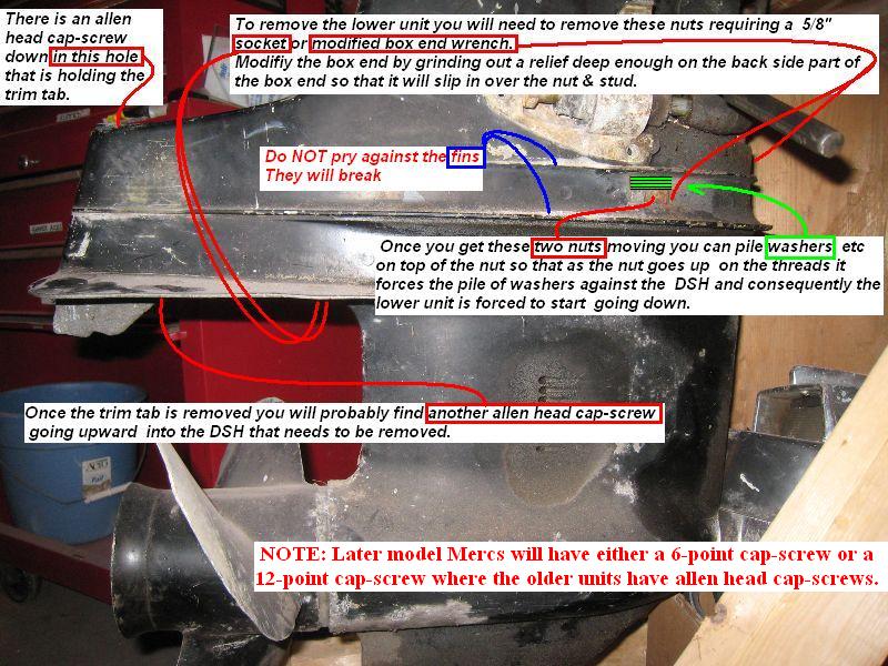

I have attached a picture explaining how to remove the lower unit.
Thom
Re:New seal for the Lower 15 years 3 weeks ago #47974
Here's a few pics of the lower unit - all the "issues" are really not important, with the exception of course of the leak

Peter good luck with the lower but you really should consider spending some time finding a replacement.... I have found then really cheaply with some patience and research.
Thom...THANKS so much for that great tip on using the washers to break the lower. I consider myself a pretty resourceful guy and have worked myself thru a great many issues with older motors and that is one more tool for my tool-box.
