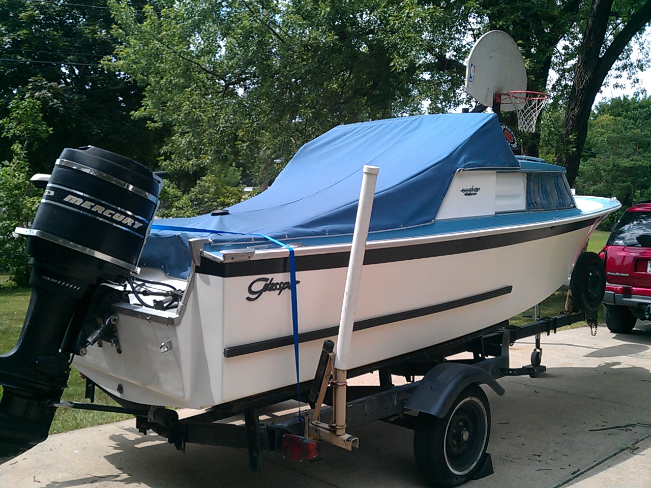

I hope all turns out well with the old girl. Nothing like the looks of an old black 1000 hangin' on the transom.

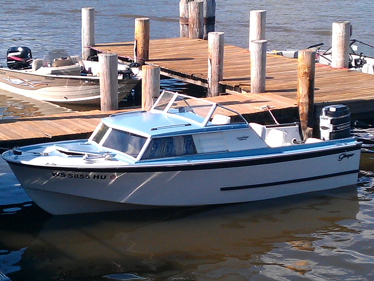

That is a really nice boat you have there. Love that vintage. Good luck with her!
