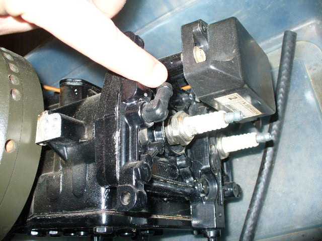

Is this the fitting that you are talking about?
Re:Merc 9.8 water pressure guage??? 15 years 3 weeks ago #47521
No
You need to look where the hose comes out of the block ( water jacket )
Re:Merc 9.8 water pressure guage??? 15 years 3 weeks ago #47696
Hi,
Should this still be needed, I took this picture of a 1984 model showing the cylinder block Tell-Tale fitting. The Tell-Tale hose connects here and routes to a nozzle on the bottom cowl.
Regards,
Joe
www.fergusonpoolemarine.com
Profile Picture:
