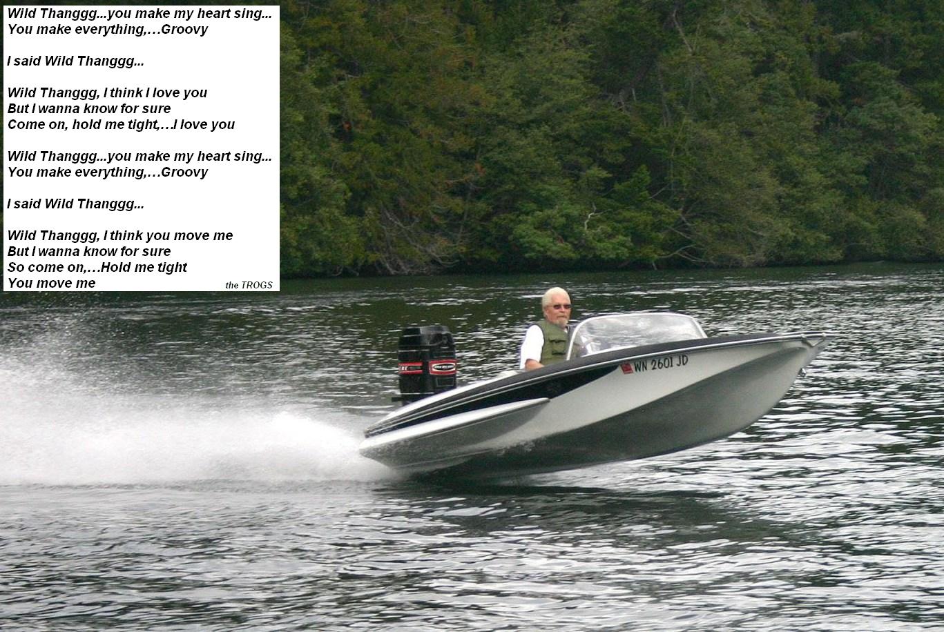

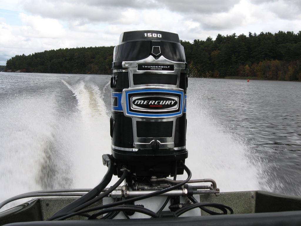

Finally got the Hydrostream running perfect, GPS at 68.2 Thanks to the prop Jim Melanson(g3jim) provided. Here's a shot at about 50, didn't want to turn around and snap a pic after that. Wish I could taek a video like Jim just did.

That is a pretty Merc Randy!!

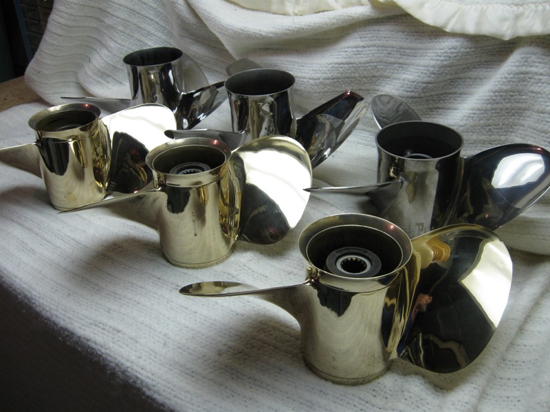

Jim had a stock 26 pitch Merc chopper, small ear for an in-line. He had a shortie mid and lower that had this prop on it when he found the set up.
This gave the 68 plus speed at about 6000 RPM, it's easier to read the GPS speed than an exact RPM as the display graduations are not the fine on the tach, the GPS is a digital display. Exact RPM is not critical as long as it is in the neighborhood of 6000 for this motor a WOT.
I tried a stock 24 Chopper both a small ear in-line and a modified V-6 24 Chopper (big ear) that had the blades reduced to inline size, this mod was done by Jim Titusus in FL who raced for Merc in the 70's so he knows this stuff cold and what works. It is not an expensive rework and perf V-6 props are easier to find. Overall the modified 24 ran a bit better than the stock 24 speed wise, stock topped out at about 64 at 6300 RPM, the modified at about 66 same RPM I wanted to back down on the RPM a tad so the 26 pitch was perfect, picked up a few mph as well, I think the 1500 porting starts to run out of breath at about 6300 so best to keep just below there.
I think what I'll do is run the 26 when alone looking for max speed and if I am taking people out for a joy ride I'll swap on the modified 24. Not surprisingly, weight slows the boat along with RPM so a little less pitch will be perfect with people on board. The 1500 is sensitive to detonation and it's best to have it spin up on RPM rather than load it down.
Nice looking in-line you have there, What are you going to run it on? I think the ADI 115 motors are probably the best Merc made in that flavor, smooth, torqey almost the same power as the 1500 but not as fussy. They also have better corrosion protection on the water jackets, better trim/tilt no distributor etc. I wanted to stay correct vintage (74) for the Stream so I stuck with the 74 1500 with all it's foibles. It is a great running motor all that said. I run XS style carbs, no backdraft tubes on the bowls and run the slightly richer .082 XS jets. These carbs were only used on the early 1500 long shafts and all the Shortie and XS's. Lean out is certain death on these. Timing has to be held to 21 degrees total, premium fuel only and I run a water pressure gauge and watch it like religion as a dropp in cooling is also a very good way to ruin one of these. The Stream has a stock transom of 23 inches so even stock, the motor is high. I do notice a drop in pressure at max speed if I over trim, but when the boat is set right where it runs the fastest water pressure remains solid, but worth keeping an eye on.

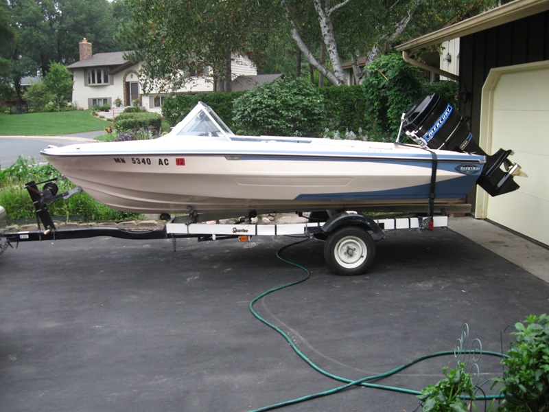

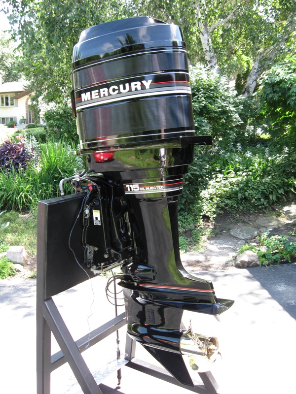

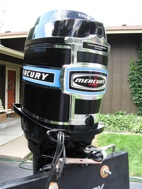

Randy, you asked what boat the 1988 115 HP Merc is to be mounted on. I bought a Glastron V-153 new in 1971 with a 80 HP Merc that would do about 44 MPH and replaced it with a 1974 Merc 115 HP in 1987 that increased the speed to 52.9 MPH GPS with a 2-blade cupped 21" Mercury Quicksilver prop. In my quest for speed, I acquired a 1988 115 HP Merc last fall and touched it up cosmetically and will do the motor transfer next spring. The Glastron handles the present motor well and I expect no problem with the increased actual HP on the 88 Merc 115. Plan to raise the motor off the transom about 1" to start and experiment with props. Have the 21" 2-blade bronze (running 5,500 RPM with 74" Merc but with 88' Merc can increase RPM to 5,700 to 5,800),21" and 22" Ballistic stainless steels, a 21" PowerTech RAF, and a 22" small eared Chopper. Hope to reach 55 to 58 MPH.
Thanks for the information on your boat and motor, which I consider the ultimate speed combination.

David,
That is one gorgeous '88 115!!!
That is the best of the bunch of any and all inline-6s Merc produced. Granted, in stock condition, the earlier 1500xs will outrun it, but other than that it can't be beat IMHO.

Thom, when you go to look for those WMK14's I think you will find I have em B) . Can,t get that damm Trogs song out of my head now. Its all your fault.

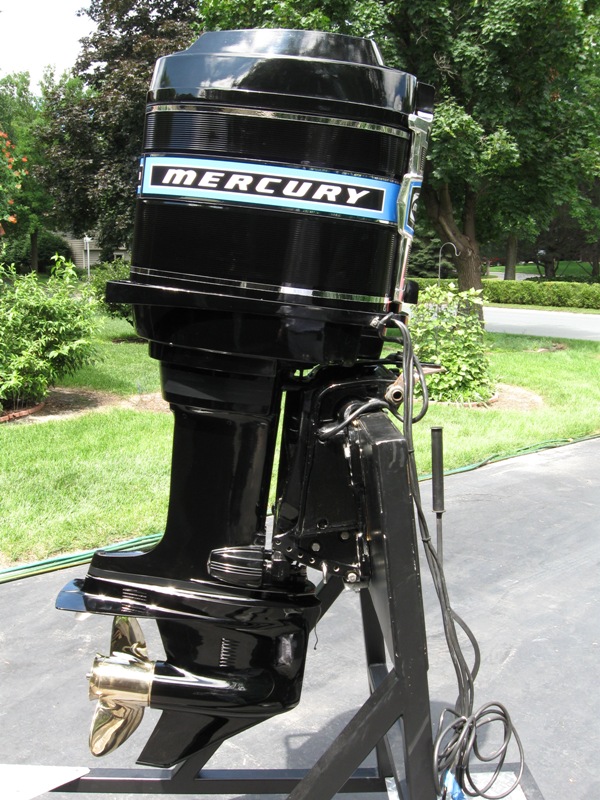

Here is the 1988 115 HP Merc dressed up as a 1974. Midsection piece was not exchanged but could be (reason for the electrical tape over that decal).

Great looking motor David, the mid 70s dress code for the mercs is my favorite and how I have my Tinkermerc dressed. Wish I could paint like you! Stunning finish.

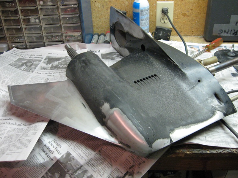

On the 1988 Merc, the lower unit was painted 3 coats by an auto body shop, and on the 1974, the cowl and faceplate were painted and clearcoated. All other surface scratches on both motors were touched up by dipping a fine artists brush in Mercury paint and dabbing on, buffing out, and waxing and polishing.
