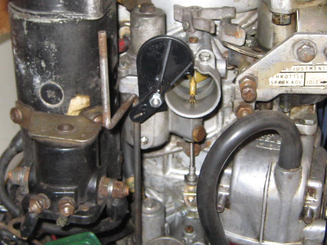

Here's the new choke shutter, All of a sudden I can't post that photo message coming up to reduce image .. The first image I posted I didn't change anything >> Don't know wha now ???
aaaagghh MY camera somehow went to movie setting ?? Here's the plastic choke
