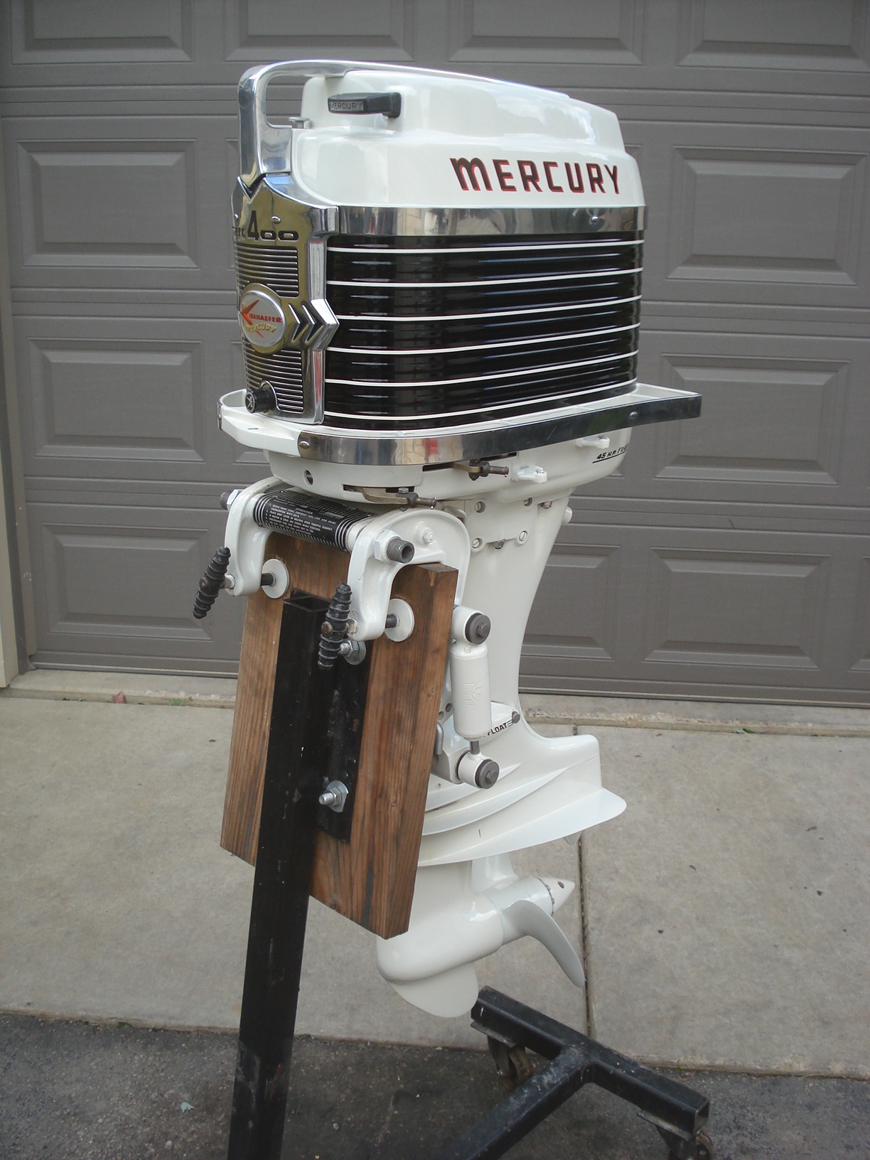

Real nice 400.

I am starting to think that you have a little Mercury factory going there in your shop!!
Every motor looks absolutely brand new. You are truly preserving history.

Where did you get the 45HP four decal? I have the other decals. Also where exactly on the wrapper do the white stripes go? Mine was painted all black in the past.
I am going to keep your picture for a reference.
Re:1961 400 15 years 1 month ago #46691
The decals came with the kit from nymarine.ca
The way we have done the wraps was paint the stripe on every other raised rib. The entire wrap gets painted white first, then fine line tape is used where you want the white to be, then paint the balance black, then clear coat.
Darrell

sweet merc perfection. I love these 400's. peppy!!
Re:1961 400 15 years 1 month ago #46703
Might be a 1960 400 actually. Faceplates that were screwed on typically are 1960 motors. In 1961 they went to the 1/4 turn fastners.
Beautiful. I really like it.
Conrad

What type of paint did you use? I have looked at spray can and also engine paints. Any recommendations?
I have the exact engine and love it to look like that.. Also, where did you get your paint? Costs? Thoughts of just a universal white?

Darrel that is really sweet. I restored a 60 300 which I thought was pretty good but oh dear...yours looks brand new.
I want to know all your secrets besides the wrap painting. Can we see a before picture? I have to assume it was in pretty decent condition to start? Like the emblem on the front plate, the chrome all around and even the shock bolts etc all look new.
How much did you actually have to replace?
I know that you might want to protect your trade secrets but I think it would be great to learn from an expert like yourself.

That is, indeed a 1960. I have two of them, one restored the other original. Sweet engine but watch the cylinder bores. Make sure you measure them carefully and don't build the engine with more than .005" out of round without boring and oversize pistons installed. Any more than that and the engine will have idle issues in the best case scenario and broken piston skirts in the worst. Other than that very straightforward to build and run.
