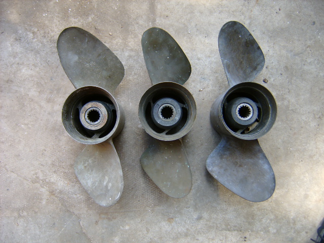

I'm searching for the right prop. My motor is fresh with just two hours from being broke in, so very soon the operational restrictions are lifted, and I get to run a normal fuel mix.
My setup is a short shaft Merc 850, mounted on a CMC where the motor is mounted 3-1/2" above the stock G3 transom top. The cav plate is just shy of 2" above the keel... The CMC sets the motor back about 5" behind the transom. I took a lot of time to fair in the final 24" of the boat's bottom, so its perfectly straight.
Of the props I've borrowed to test (24P, 23P, 21P, 19P, 17P); with my 2:1 gears, I am happiest with a Michigan 19P non-cupped prop... I am seeing only 7-8% slip on flat water, which i understand is very good... and am in the mid-5000 RPM range. I may be zeroing in on the optimum pitch, but the available prop styles are still really confusing to me.

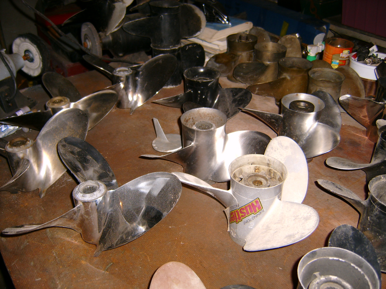

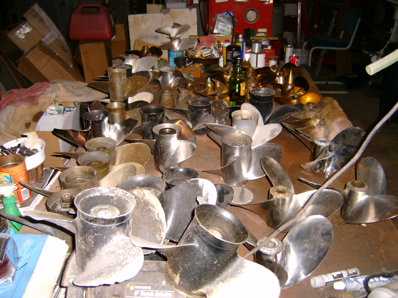

Jeff, WOW do you think you have enough props there? You're just a little too far out (I mean in miles...heh) to come and try your collection. :laugh: I am going to try your recommendation however.

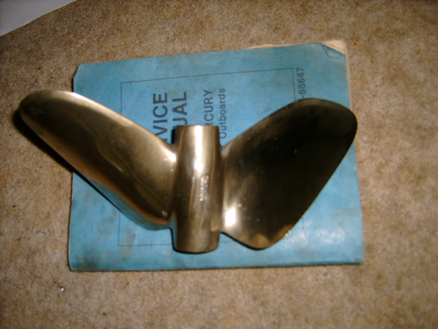

Conrad & Dpanky, I had tried an old Kiekhaefer two blade 19" bronze prop I borrowed from Thom, but it was not cupped and cavitated easily on take off and while turning. I had better luck with his Michigan Wheel 19P aluminum (no cavitation and two more MPH)

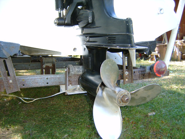

I found a 14 x 18" Chopper that I picked up... Mercury part# 48-75766-18, I am going to give it a test this weekend and let you know how it goes.

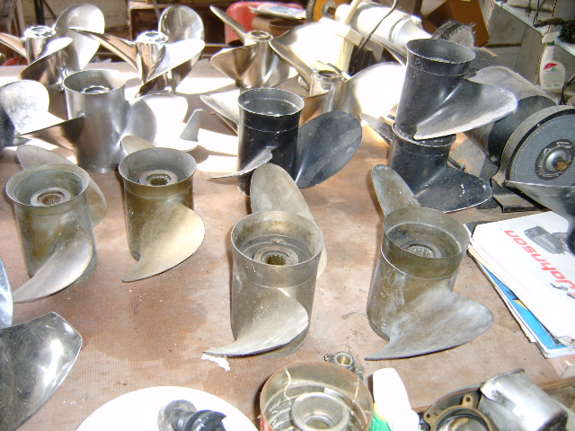

Nice shiney chopper......MMMMMMMMM. LOL. remember they like LOTS of air, and hit it hard outa the hole then back off after plane is reached....if ya wanna....lol, see the movies I posted for explanation of take offs! though they will work at a slower hole shot it strains the engine more......or maybe it strains me? remove the trim tab also as the chopper has much more rake than most any other props.

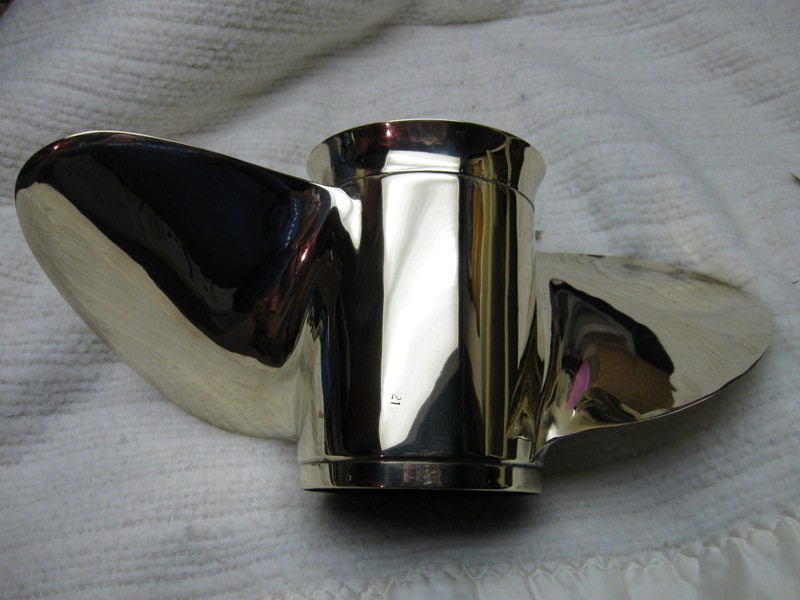

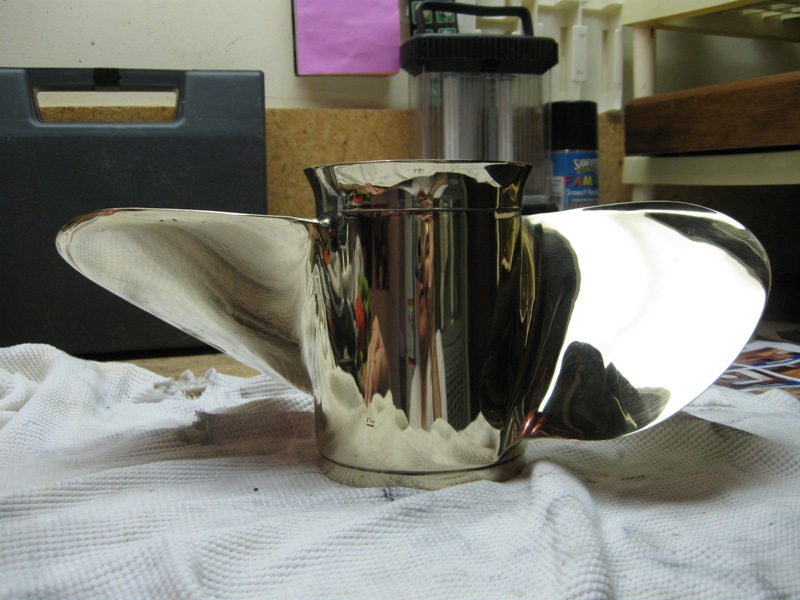

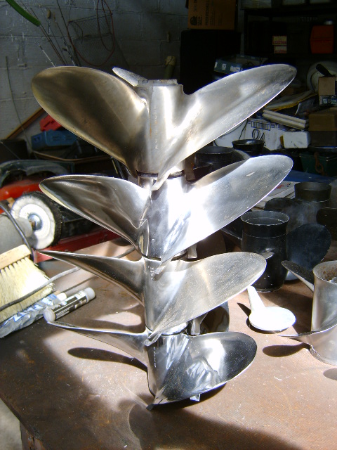

Oh and the bronze 2 blade in the first pic is a 12x26p, untried as of this time, but it sure looks cool

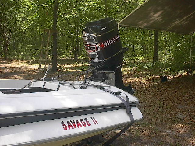

I have A 2-blade cupped brass prop that is either a 19" or a 21", not sure of the markings. WILL IT WORK on my "new" 1969 Merc 1000!!! :P
Jim Savage
Re:Prop Confusion--HEY PONY BOY!!! 15 years 1 month ago #46131
Jim Savage
Re:Prop Confusion--HEY PONY BOY!!! 15 years 1 month ago #46132
Jim Savage

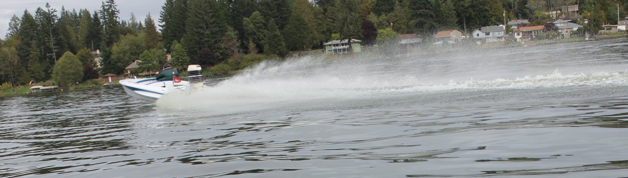

Well, I tried the 14x18 chopper... didnt like it. Boat was squirrelly when it was flying. In fact, when the boat was up out of the water it was crabbing (stern coming to port) so I had to hold the wheel to the left about 120 degrees to go straight. The first time I dropped the throttle and landed the boat back in the water... it jumped from side to side... I think it was due to the keel wasnt parallel to the direction of travel. Anyway, that prop is gone... did some horse trading with Dr. Frakenmerc. My next prop was a Quicksilver# 02036-17. What a difference! Handled great and beat my fastest speed by 3 mph on my GPS.
Bandit - 1959 Glasspar G3
Re:Prop Confusion 15 years 2 weeks ago #48230
If your running 49 mph with a 2:1 lower unit and under 5800RPM that prop has to be bigger than 17p.
More like 19-20pitch...
And yes the more you run out of the water the more it will crab. you have to be ready to straighten your wheel when you get out of it.
Good work It looks like it is riding very well! The bow is up nice, but your probably loosing a bit of speed due to being so far trimmed up. A prop with a bit more rake will hold the bow up without ecessive trim angle.
Thanks for the vid
Conrad

Re:Prop Confusion 15 years 3 days ago #49593
You tell Nut like it is!!! Thats good. He is alive, as he e-mailed me three times last night.
Sent him the video of the new mercs and he said it made him sick!!!! Too bad!!!
Here is a pic for him too!!!!
The only time a OMC engine has ever been that high was when they were flown out over the ocean and pushed out of the plane!!!!
Jim Savage
