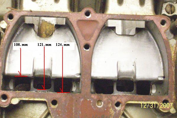

Yes, the Twister II and Twister IIx have a non power-ported block like the first edition 1400, but has (3) intake ports rather than the common (2) intake ports per cylinder.

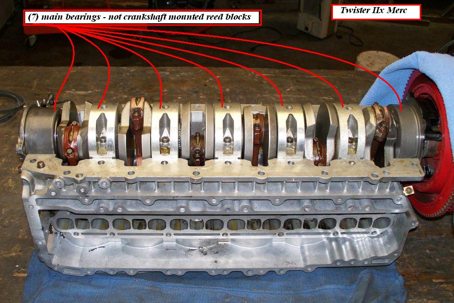

It also has a unique crankshaft & firing order that tunes (3) cylinders to the other (3) to give better performance.

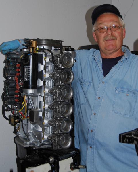

It also has a unique crankcase cover that has a set of (7) pedal 'pyrmid' style reeds (14 total) per cylinder, and (6) very large carburetors.
The carburetors are TC-3A and very similar to those carbs found on a large Force outboard motor.

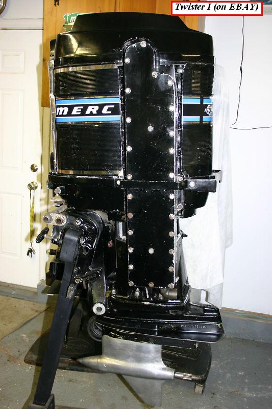

The T-1 was a 1350 with unique intake ports and a very unique exhaust system, DSH & SSM.

:laugh: Thanks Thom for clearing up the confusion, lol. Great info and didn't think there were so many versions. Thanks for the pic's also they always help:) This explains how the 6 carbs fit, no reed blocks...interesting! If you have a pic of the 'pyrmid' style reeds' would be interesting to see its design :)

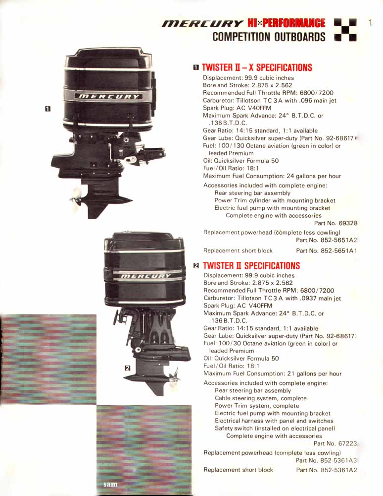

Here's some Mercury specs on the T-II and the T-II-X, can't recall where I gleaned this from but there it is. What I find interesting is that Merc doesn't state HP figures but if you look at the advertised fuel consumption for the T-II (21 GPH) and the T-II-X (23 GPH) and calculate using the Good Ol' Forumula of GPH/10=Crankshaft HP, 210HP and 230HP are some pretty incredible numbers!!!!
Couldn't say what, if any inefficiencies would have skewed those numbers but maybe one of the Old-Time Racing Guru's have dyno-run info. Definitely nasty motors and they're moving a ton more fuel-air mix thru them than a stock motor.
When the Good Dr. Thom gets his replica-racer in the water, we're gonna have to have the Hi-Test fuel truck standing by for a reload after just a few laps around the lake!!
