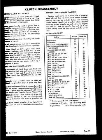

My 650 is a '69 and is a short shaft with the 5" extension.My driveshaft is a short shaft with the 5" extension.Actually my lower unit part number makes it a 1500 lower unit and as it turns out has the 2:1 gear ratio which explains why it was a little doggy out of the hole.I am running a 19" prop on it but I am rebuilding it with the proper 2:3.1 ratio which should liven it up a bit on the low end.Ron G

In the '65 and prior manual, it is 2:1 for a 650 and most of the larger motors? Think you want a 90ci. dont expect miracles from a 650. One of the best motors but is what it is. My g3 with a 19p takes off like a bullet if altitude and temps are correct. I used a 15p for water skiing and plan on getting a 17p for all around use, might get cupped?
