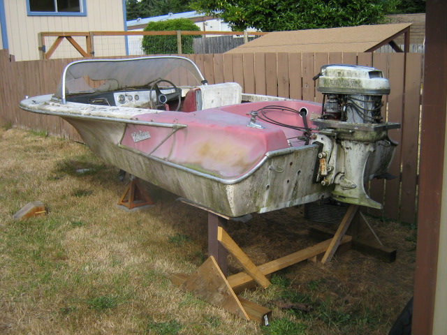

Picked up a Pacific Mariner Stiletto the other day with the original Merc 500. The problem is it's missing the lower unit. Was wondering if anybody can tell me what years and models will fit? Thanks for any information.
Re: 1961 Merc 500 15 years 2 months ago #43185
Any mark 50 55 58 55A 58A merc 300 350 400 450 500 non jet prop exhaust will work. 1 year 500 had larger studs but you can work aroun that been ther done that.basicly any 4cyl non JPE will work. nice rig.
