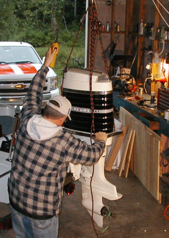

2 person grab the rear rail with one hand the other hand under the shock.
with a crane or hoist rope tied to the rear corner rail and go to the steering conector. makes a triangle over the top.

Re: How to lift a 58AE 15 years 2 months ago #42829
Up to 1964 you can list it like shown. Starting in 1965 the lower cowl is not actually attached to the midsection. It is actually floating. Not recommended lifting the 1965 and newer motor like this using the bottom cowl. Puts a lot of stress on the cowling framework.
Nice white merc!
