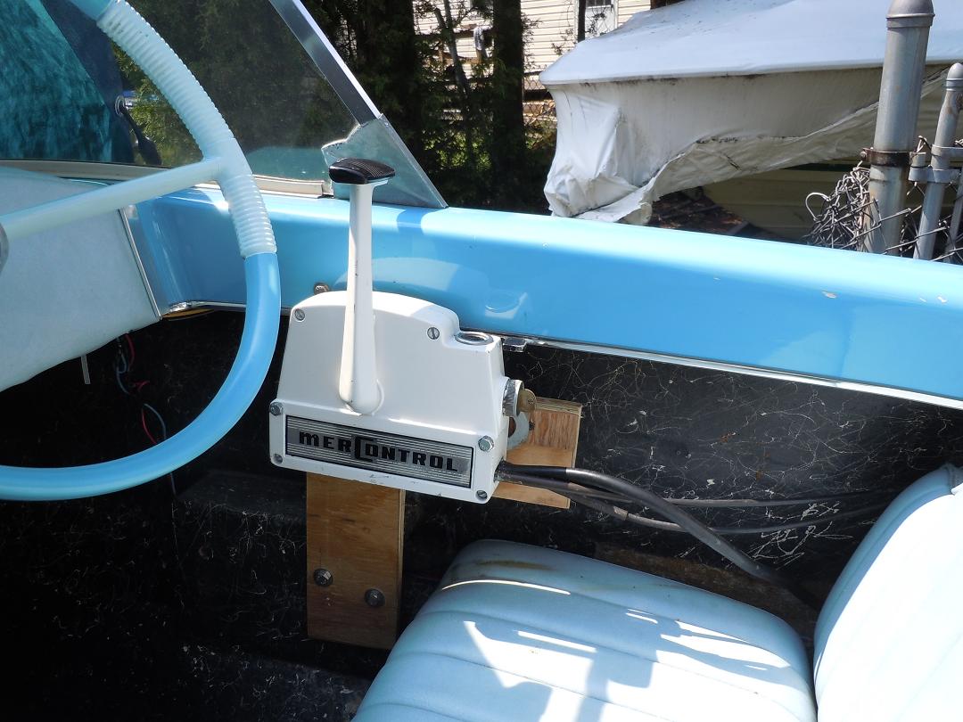

the mercontrol remote i installed doesn't work. only sound it makes is when i depress the black choke button on the remote. plug is in good and tight and remote ends that attach to the battery are clean as are the terminals. hooked the old remote
back up and the motor turns over but the battery died before i got it started. guess i should of tested it before i went thru all that trouble building the mount. also the positive battery terminal got real hot with the mercontrol, and sparked... but it didn't when i re-hooked up the original remote. any help greatly appreciated. ron

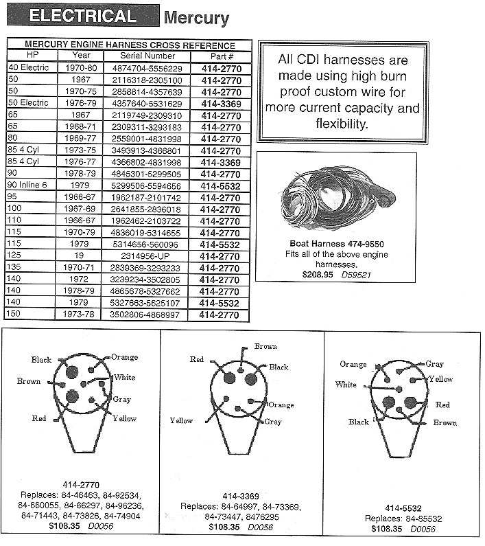

ron I just buttspliced longer battery cables a couple weeks ago and looked at the wiring chart I found some where and this was for different plug pins and found the positive & neg are OPPOSITE to the old style 7 pin that we use on the older mercs
see config on far right in the pic "red & black" thats opposite to what you need I believe and if cable have been swapped around
look into this the pos & neg maybe backwards :ohmy:
geez i wonder if tim accidentally reversed them.
