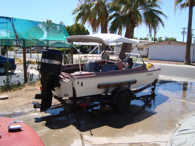

I run a 73 15 foot Marlin with a 90hp inline 6 and what a difference compared to my other 15 footer with a 85 hp merc.The 90 seems to have alot more torque (snappy).I dont know what RPM the 1965 90hp is but my 1978 runs @ 4500 to 5000rpm as for the 85hp runs @4800 to 5300 RPM.

fixitdaily. Your 90 looks to be the newer late model L-6 that was 99 cubes. yes even more torque than both the 66 cube 850 and the old 90 cube 900.
