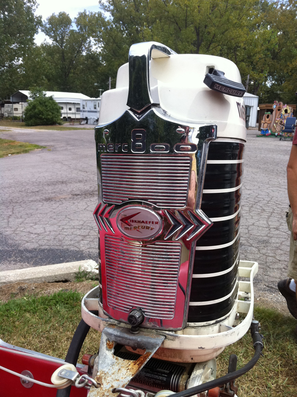

Hello FibreGlassics Forum Members,
Any idea what year this Merc800 Kiekhaefer is? It's on a 1958 Runabout (model unknown) that I'm thinking about buying. Any info would be fantastic. Cheers and thanks!

I wish I had the serial number... Thanks for the help though. Anyone have an engine similar to this?
Re: Merc800 Kiekhaefer Year? 15 years 2 months ago #41800
with the pic 60-61 i think 60.

Looks like a DockBuster (Direct Reversing):

Using the picture on the Main Forum, I would guess it is a 1960 Merc 600 with a 1960 Merc 800 front cowl. The changes could be a little more extensive without additional pictures to view.
The Merc 700 does appear to be a 1962 Merc 700 Full Gear Shift model. However, I am doubtful that the 1959 wiring harness shown will plug into the outboard unless it's harness has been modified or replaced.

I agree Joe, it looks like a 700 FGS, but my '62 had a different starter relay than the one pictured (I think there was a slight production change mid year?) The serial number isn't matching up though???.......
store.eastcoastmarineservice.com/category_s/2687.htm
Wonder if there's been more faceplate swapping going on with this one? Nice motor though!

The Merc 800 is a DR as it only has one cable BUT the top cowl should have raised chrome Mercury letters which this does not.
So without other pictures it's hard to say if it's an 800 with an incorrect top cowl or a different motor with the wrong faceplate.
Faceplates are interchangable.
The picture gallery does NOT show a 700 as the top cowl and lower cowl pan are the larger versions and white, which would indicate an 850 full gear shift wither a 62 or 63.

The crusty 700 (sorry :) ) is a 1963 850 FGS. 1963 I think is the first year they put chrome on the back vent of the top cowl. The 700 did not have that chrome trim. Plus the wrap looks like a faded out 850 cowl. And the ser # says so.
One quick way to tell a 1960 motor and a 1961 motor is in 1960 they had the screw down front face plate. In 1961 they started using the 1/4 turn fastner.
Now the 800 that is first pictred could be a 800, a 700 or a 600 I guess without further pictures to review. It is a 1960 for sure due to the way the front cowl is locked down with the screw type and it is a dockbuster due to the fact one cable is present.
I doubt its a 600 but who knows. If it has the old style lower unit like a MK 75 its a 600 If it has no shocks its a 600.
if it has shocks or thru hub exhaust its either a 700 or an 800.
I think its a 1960 700 DR with a 800 faceplate. The 800 DR had a fatter lower cowl (I think?). This one looks slender like the 700 should be.
So the 700 is a 850 1963
and the 800 is a 700 1960
Funny
Conrad
Joe has it . I looked on the main page and it its a 1960 600 with no shocks and old lower unit like a MK 75. Also the 700 used two white stripes close together around the wrap. The 600 used only one stripe around the wrap like in the photo posted here.
