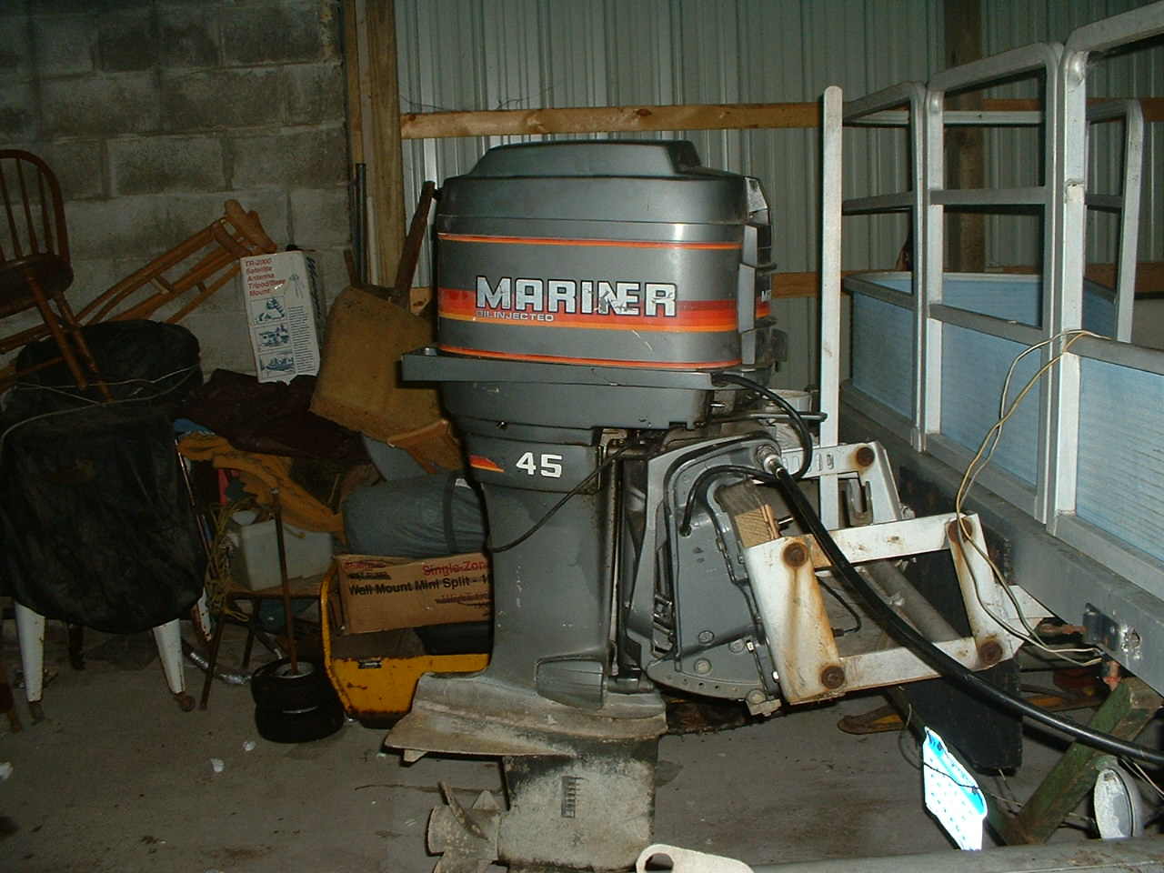

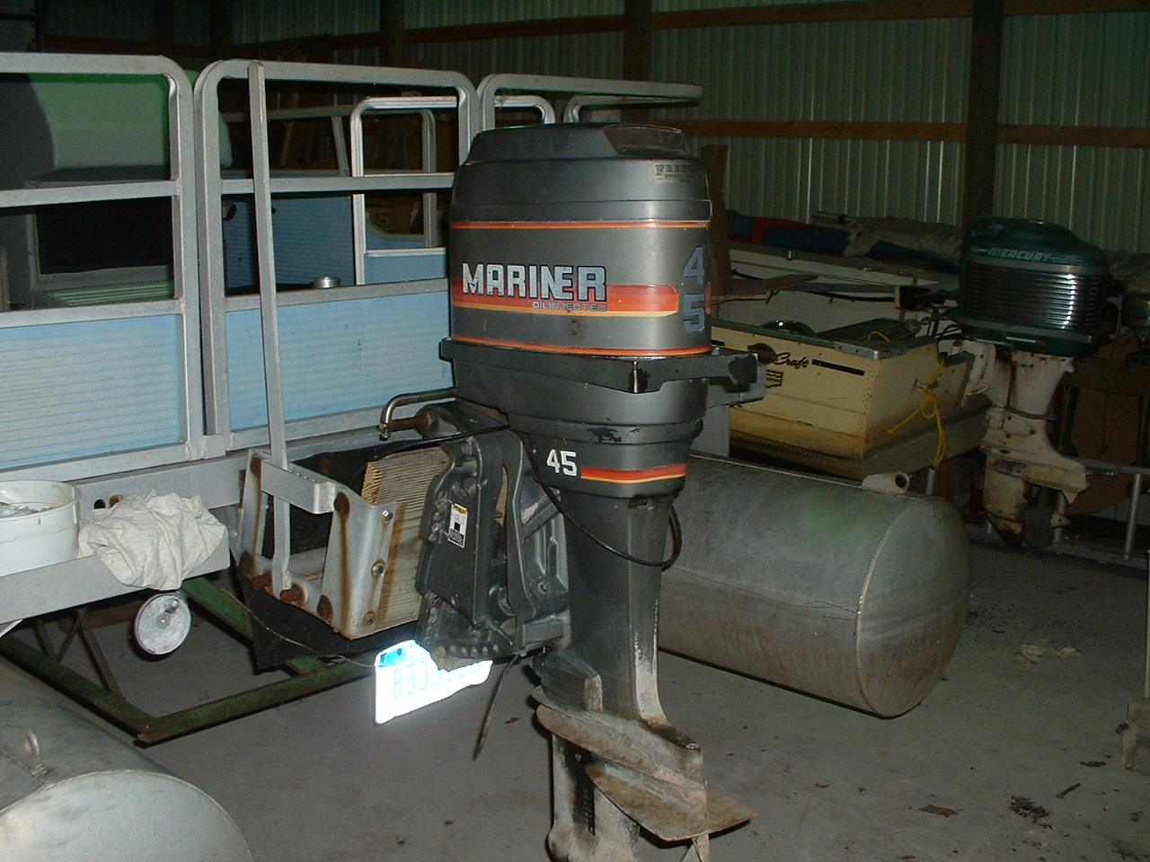

When I bypass my "Autoblend oil injection. Will the motor run OK with it unhooked?
Running 50/1 fuel direct to the engine. It is a Classic Mariner "45" same as a Merc 500. :laugh:

This is how my Autoblend is set up.
Gas tank with fuel line going to the Autoblend unit. Then from the Autoblend unit to the engine.
There is a cable that plugs into the engine from the Autoblend unit.
So my plan is to eliminate the Autoblend unit. run 50/1 fuel mix straight to the engine from the gas tank.
I just thought the engine would detect the Autoblend unit being unplugged from the engine. And not run right.
If it doesn't great.
And thanks again for all your help.
Dave

Just hooked up a direct line of 50/1 fuel to the Mariner. It started right up and run great. It doesn't know the Autoblend is unhooked. B)
That made my day. and she pumps water A-OK.!
Just got to clean up the leg and lower unit.. It has a little bit of scrunge on it.

The Mariner doesn't know it is running with out Autoblend.
I have run 2 tanks of 50/1 in it and it runs better than ever!
A lot less smoke!
Hope to have some photos of it in action soon! B)
