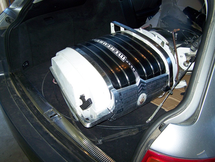

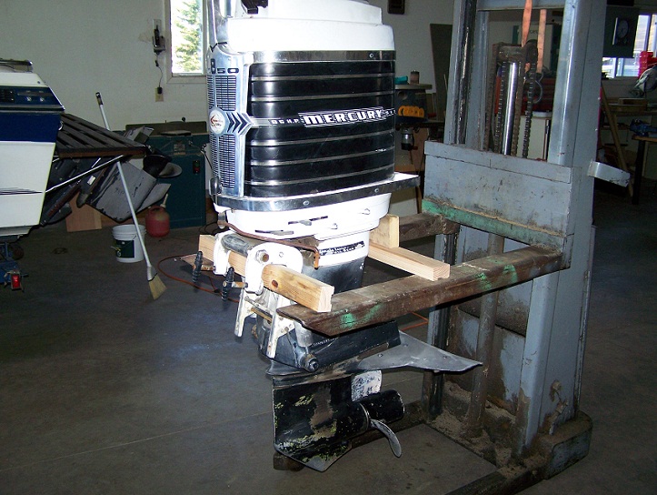

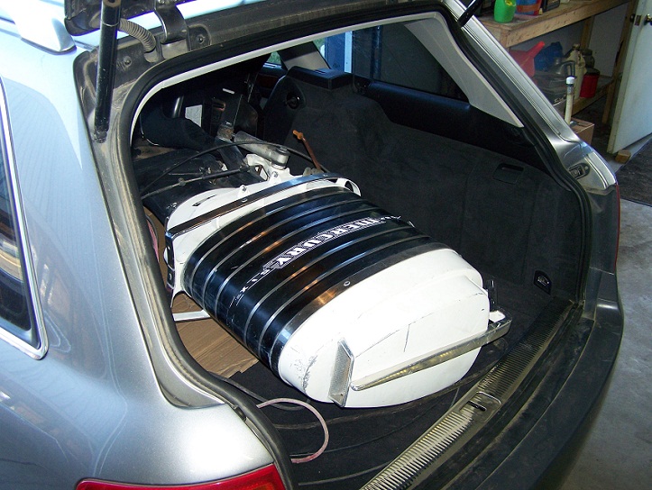

They took it off of the boat and layed it on top of the controls in a little trailer and them brought it into town, about 7 miles he said. Well, the wrap WAS perfect.(&%@)&%) He knocked $75 off of the price. It is a shorty.
Compression is 1-125, 2-140, 3-140, 4-145, 5- 135, 6-130.
Looks to be the candidate for the Kober Kat.
Neil and Mary Ousnamer
