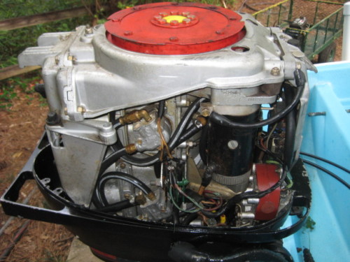

Ive got a 1971 Merc 500 .The coil tower somehow about burned off . What would do that ?? Old or Arcing ?? Its the type with the Big round coil with a black and green wires going to a switch box . Ive got a 1969 650 . According to some sites its suppose to have points But it looks like the same coil and box as the 500 only mounted different .Will all of these 4 cly Merc ignitions swap out between them . Can I use the 650 Cap and Rotor ?

dave bernard wrote:
i think your 500 has a lightning energizer ignition system. 650 is different. i have a complete lightning energizer system if needed.
I pulled the 650 apart tonight .on both the 500 and 650 distributors on the bottom it says Lightning Energizer . Both top Caps have the same parts number .I havnt pulled the coil on the 500 yet but it looks like the 650 .Both have the same 2 wires colored the same . I wonder if the 650 is newer .Pics ive seen of a 69 the motor wrap was a different color . This one has a red split stripe on it .
My 650 has the red round coil like the one in the picture .Did they use the same coil on some 500s but mounted them a different way ? I tell ya that 650 Doesnt want to give up its parts without a fight ..

Well I swapped out the coil , Distributor and wires from the 650 onto the 500 .Parts numbers were all the same .Cleaned the carbs while I had it apart and Adjusted the timing .I took it on the Scat Cat to the lake running a 19 pitch prop .Dang thing was hauling pretty good .I went back to the car and got my GPS .Took it back out and just got up on plane and hauling and the motor jerked hard and quit .Yes it had water coming out the pee hole I had put a new impeller in a couple of days ago .Hit the starter and it lagged then fired up .Jumped up on plane then another Violent jerk and died .I hit the starter and she was tight .I turned it over by hand but I could here something dragging inside like a broken ring , Busted reed cage or valve or a crank neadle bearing ..Something let louse or got sucked in .Crap ..I had decarboned it to when I put the Impeller in .Never had a Merc take a dump before .She had spent alot of years pushing a poontoon with a low pitch prop before .Oh Well still got alot of good parts left ..
