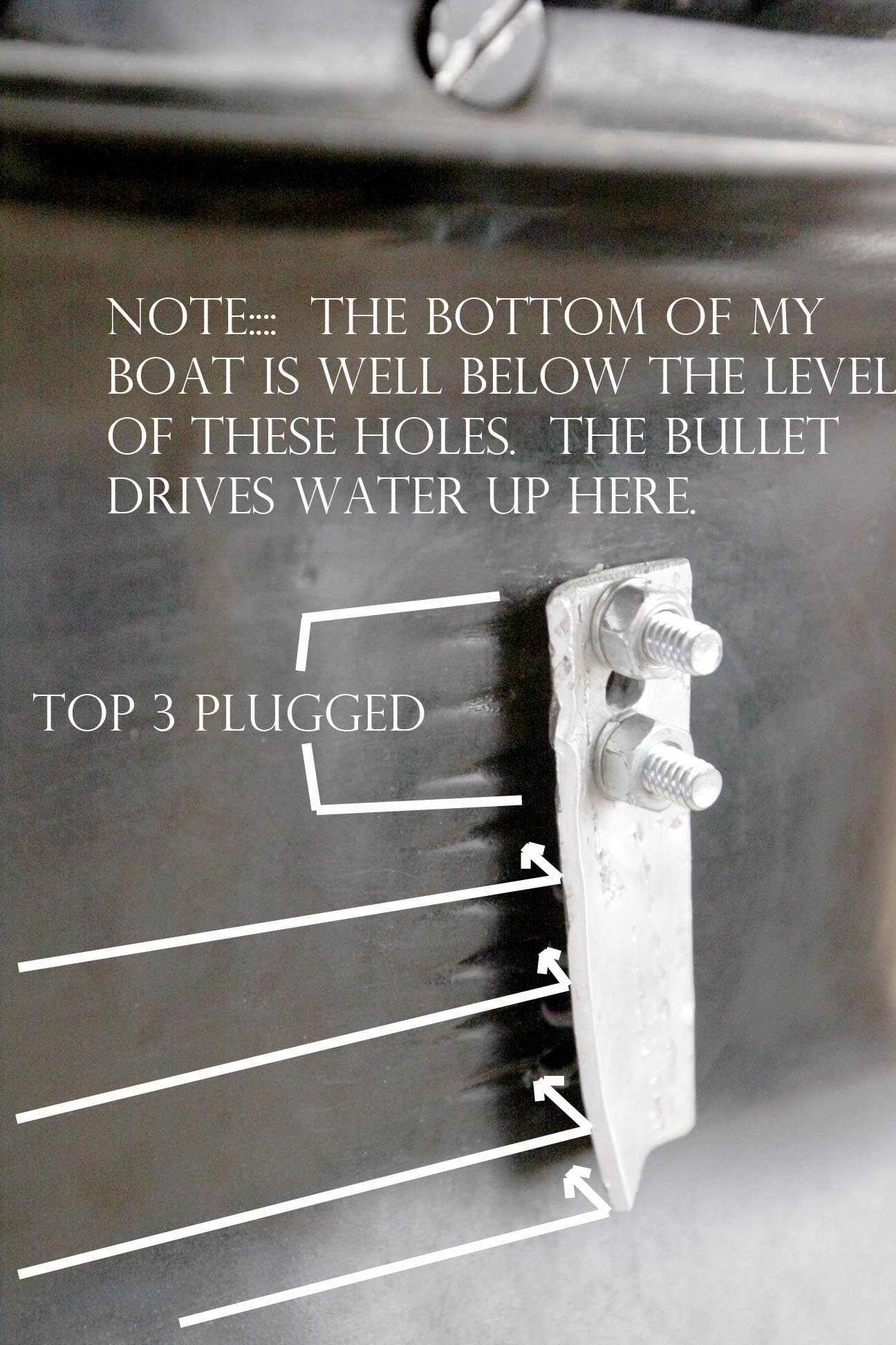

You will get water pressure as long as you keep the bullet of your gearcase under the bottom of your boat and you install water scoop on your standard gearcase. I have run my propshaft level with the bottom of my boat with a standard gearcase with water scoops added. Scoops are super easy to make and install. I plug the top two holes and put scoops on the bottom 6.Conrad
Wow! That is VERY cool Conrad. What is that, 3/16 or 1/4 aluminum plate? How did you shape it, just in a vice or what? Are those stainless bolts that go right through the lower unit? How long are they, and did you have to drill it out to get them in?

Frank. Its thin aluminum 1 inch by? must be 3/16. yes I just put it in the vise and made a very shallow angle iron out of it. Very shallow is best just have it com out 1/4 inch at most to grab water. This set up asctually tore off as shown @ 74 mph. I have since plugged the top 4 holes and made the scoop shorter and only working on 4 or 5 holes, so it does not get bent withe excess water pressure going by at high speeds.
When i was approaching 3-4 inches off the transom I experienced fluctuating PSI. It was very sensitive to trim angles and would drop at times to 5 psi at WOT. With the scoops Ive seen almost 20 PSI at WOT. it really works
I just used standard 1/4 inch bolts. They fit across fine if you clean the paint off the intake holes. I had to thin out the center portions of my bots to make them work past the exhaust tuner. Very easy to do and install. You could make your water scoops different. Mine is just a quick test and it worked so well I left it on.

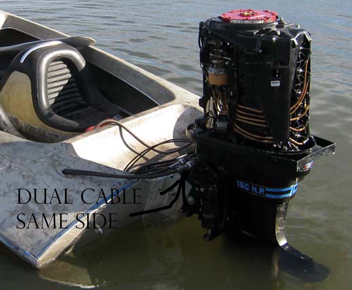

Re:How high?? 15 years 3 months ago #40405
I built mine out of 4 inch angle aluminum. But Id buy a ready made one next time. I didnt want 6 inches of set back but I think that would be fine. I would not get farther back than 6. I have to manually raise mine with a car jack on the trailer. Kinda slow :(
In the following photos the jack plate is down quite a ways. It will go up further.
A few photos of mine.
Conrad
