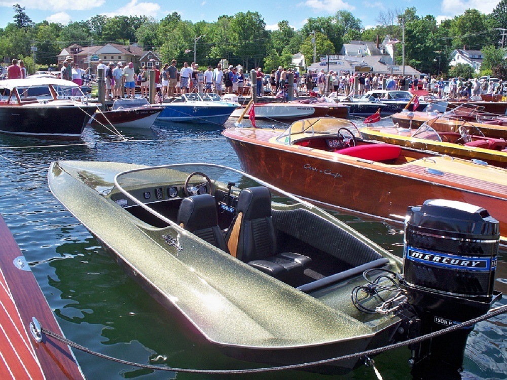

I would say the XS is a tweaked version of the vanilla 1500 rather than a decided departure for more performance like say a Twister or a B.P. motor was. It really jsut allowed higher transom heights with better handling of the stiffer mounts and a few tweaks to let it run at higher RPM for a few extra H.P.
So no doubt the XS is one cool motor, the apex of the non full race versions of 99 cu direct charge motor but not too different than the "pedestrian" 1500.
The Hydrostream I just completed has what I would call a long shaft version of the XS. I used all the XS stuff listed above except I went with a later swept back lower unit. The XS lowers were rumored to be weak using bow lifting props becasue of the slots for water intake weakened the area supporting the propshaft carrier. The transom is 23 1/2 inch high but still allows stock water intake location to supply a good flow of water.

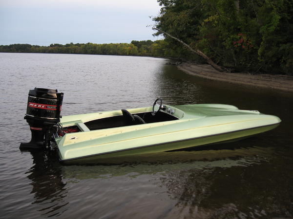

The Switzer I have runs a real XS but it runs a Super Speedmaster lower unit, a 1:1 direct drive with
a much smaller prop and above water exhaust.

That Hydro looks rel classy Randy. The Switzer looks fast. I like the color of it.
