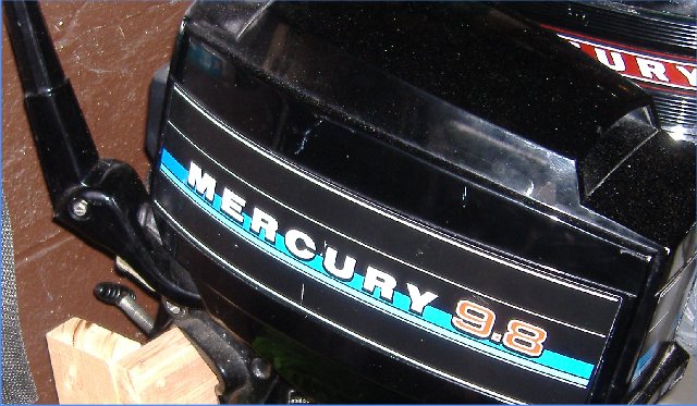

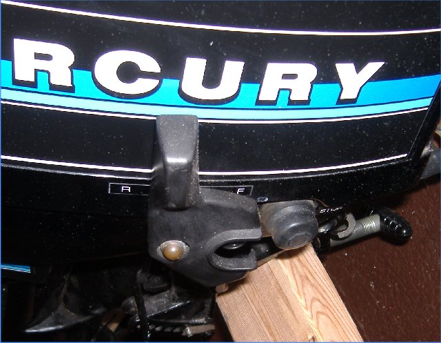

I have a '64 MFG (my first boat) that I am restoring and it came with 2 motors one an Evinrude 5hp and a merc 7.5hp both with controls. The boat I believe is a Corry Carefree and measures 12'6". Both of these motors are pull start and I wanted to put in an electric start so I bought a Merc 9.8 In the pics you can see that it has a tiller handle and a button on the side to start it with and two wires for the battery. I would like to hook it up to a key start. My question is do I have to take it to a shop to have it converted or is this something that I can do on my own? I guess I should ask if this can even be done? Are there any threads dealing with this issue? Also, will the controls work from the 7.5 to the 9.8? Thanks.

To answer your questions:
Yes you can do it on your own. No, there are no threads I am aware of. Yes the controls are the same.

Re:Questions about my Merc 9.8 15 years 3 months ago #39757
Does the control from the Merc 7.5 you'll be using have a harness? (The wiring running from the controls back to the motor.) If yes, you can tap into the motor using that, the "guru's" here can help with that. If no, you'll have to either;
1 - find a harness from a boat salvage yard, or someone who saves this stuff. Doubtful they're still available new.
2 - build your own harness from controls to motor - not hard at all, once again the good folks here will be glad to walk you through it I'm sure. You'll need a couple (5 maybe) lengths of marine grade wire long enough to go between the motor and the controls, and an ignition switch.
The two large wires in your pic of the 9.8 appear to be the positive (+) and negative (-) battery cables, self explanatory right? (Hook them to the battery terminals, red hot black ground. AFTER you're done with the rest of the wiring!)
Not sure about converting the choke to electric on the motor, someone more knowledgeable on that motor can help you with that.
Steering - you'll need a complete system, there are several companies that offer decent "push/pull" cable systems for just over $100. The tiller handle can be removed, I'd save all the old parts in case you decide to sell it later.
PS - The thread you're looking for is right here! LOL Let's get started. ;)

Just find an electric primer unit ( choke ) from an 80's OMC motor.----Follow wiring diagrams from other electric start motors to hook up a solenoid instead of the start button.

Do not really see why you would want to go to all this trouble just to install a key switch on a 12' boat. I would have guessed that it would not be that much of a reach from the helm to hit the starter button on the motor. If you really want to be able to start from helm, why not just remove starter button from motor, extend wires and install button where you want it?
Getting a good used harness for these older mercs will be hard as older Merc wires tend to be of poor quality and the insulation will be brittle and falling off most at this stage/age.
