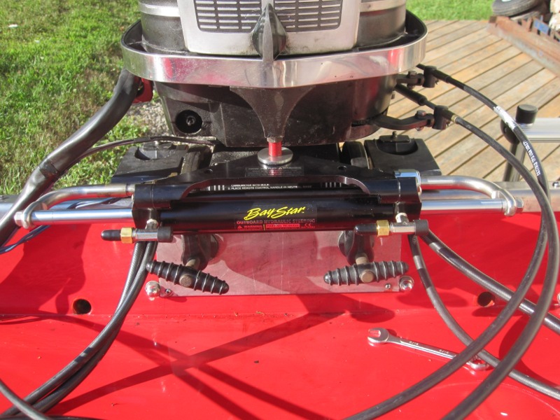

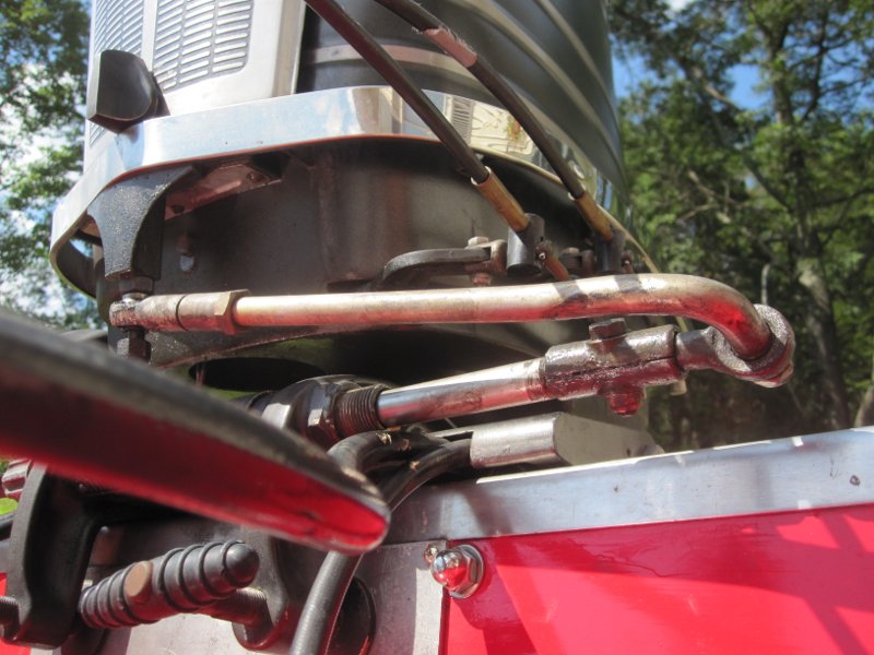

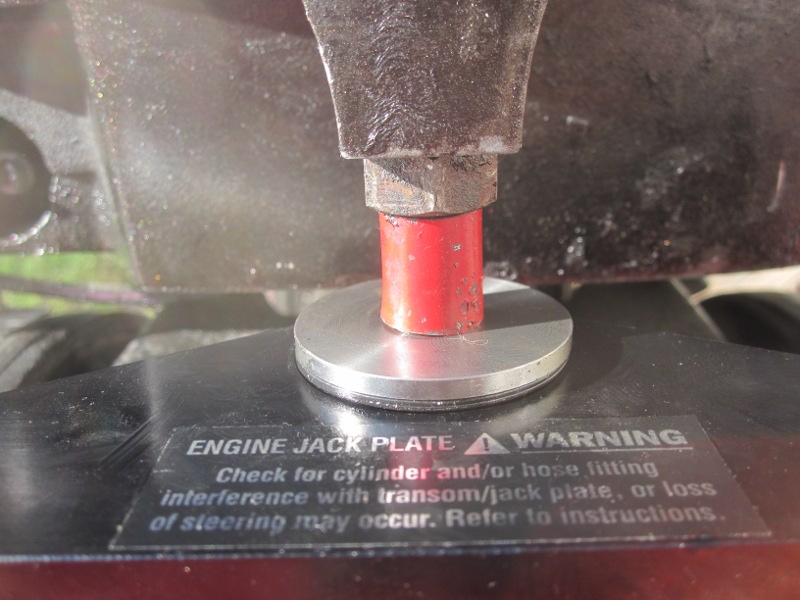

Conrad, got my new steering package in the mail when I got home, and got the business end hooked up to my old merc. This was the part I was worried about. Everything else will take time, but is straight forward and does not require fitting. All I believe needed to be done was space the mount a bit lower than higher, so I cut a piece of 3/8 i.d. steel tubing to act as a spacer. I think it will work fine, but any comments would be appreciated.

I dont have an exact motor like your with the steering hook up under the cowl like that. I have the older ones and the newer ones but not that style.
It looks to me like it will work. But the longer that bolt is the more leverage the motor will have on it. This can be potentially bad if you experience a lot of wheel torque.
That steering will fell like power steering when your done.

Any suggestions about what I could do about the 3/8 stud it mounts to ya think Conrad? That bothers me to. It's an original Ride Guide part and turns 7/16 where it mounts to the cowl. I was thinking about maybe a much larger spacer that is drilled so to fit very tight to replace that red colored piece of steel tubing I stuck in there, probably stainless. I will have to check around and see if I can find that kind of stock. I wish I knew what grade that existing stud was.
