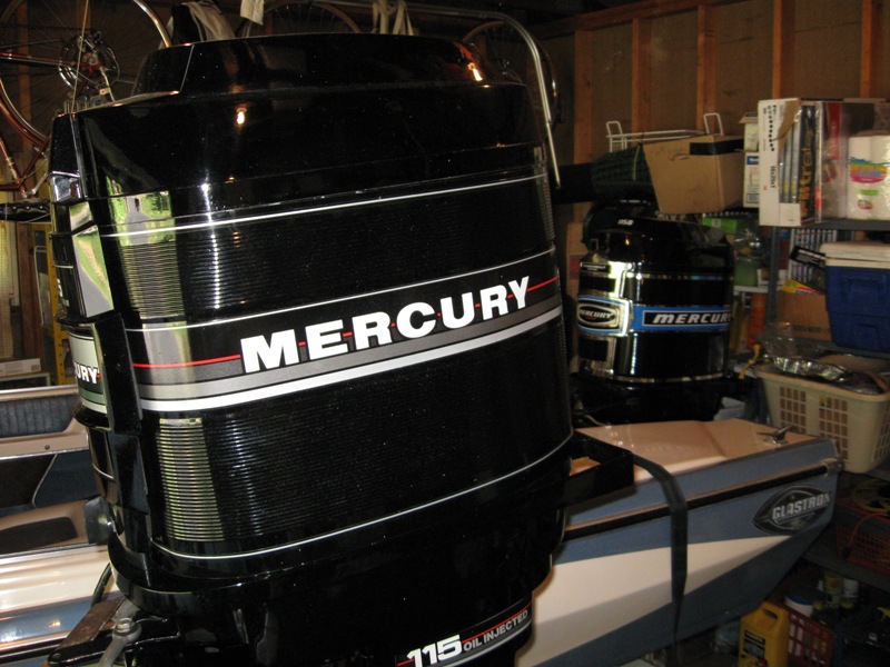

I may be switching from a 1974 to 1988 115 HP Mercury and wonder how the bolt patterns compare on these two motors. The top two bolts seem about the same distance apart at 12-3/4, but the bottom ones seem to go from 7-3/4 to 9-3/4 going from 74' to 88'.
Can the top two holes be used on the newer motor? Can the bottom holes be plugged and new ones drilled about 1" away without weakening the transom?
What is the best way to plug holes?

Nice looking motor. I cannot answer that but I have a question.!! What years was oil injection used on the inline 6's? Was it standard or an option.

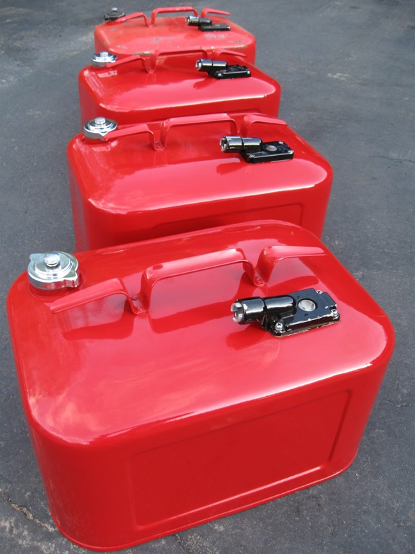

I do not mind mixing as I use three six gallon gas tanks. The first three tanks are powdercoated, and the fourth was what they looked like before.

Nice looking motor! I have one too, and mine also came with the Autoblend.
I lucked out on this one. Paid $150 for it as the owner said he took it in for a tuneup and mechanic told him compression was low so needed rebuild not tuneup. Well it had a bad starter solenoid but all cylinders 135ish compression. THey also said the tilt/trim was bad. But the manual release valve was.....released. Tightened it and she tilts/trims like a champ. Fired up and runs great on hose.
Hoping for a load test underway either this weekend or next. Will post some pics soon.
I have a rebuilt powerhead with all new pistons 20 over for a 115 adi also, and going to look at an 87 Mariner 115 with bad powerhead. If I get that one will install the new powerhead. I like the look of the gray/orange Mariners with the tall tophat. Frankenmerc thinks I'm nutz he don't care for the tall tophat!
