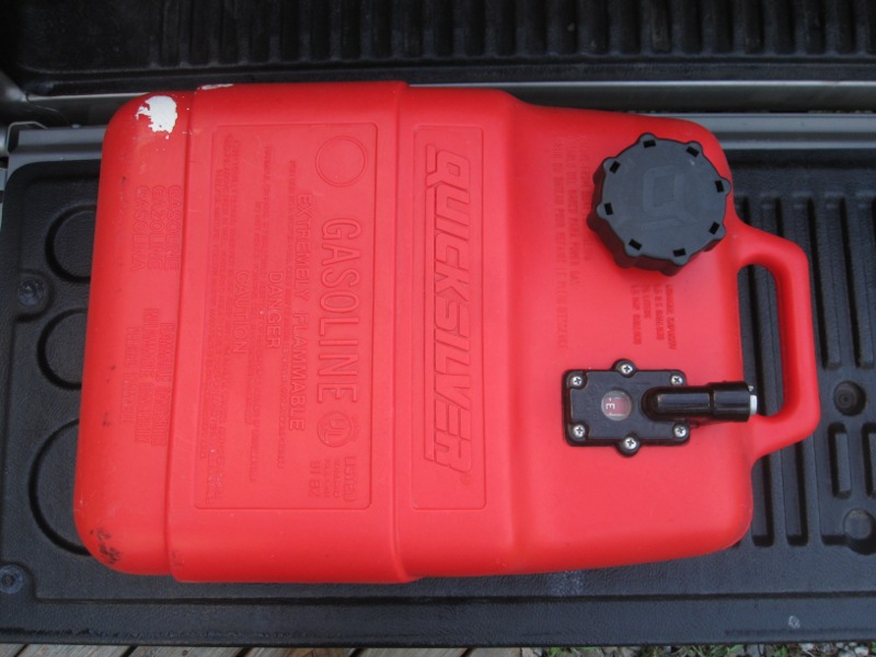

Any you fellows have experience with a merc tank like this:
I can't figure out how it vents. I showed it to Tim Calmes and he thought if you turned the cap all the way on, then backed off one click that would do it. Nope. Jesse (stashm2) gave me this tank and I sure would like to use it!
Could I add a vent somehow?

Re: How to vent merc plastic tank? 15 years 3 months ago #38938
I have not seen one of these newer tanks , but I am sure the factory folks have considered a vent of some type.-Automatic or manual.-Call the local dealer.

Re:How to vent merc plastic tank? 15 years 3 months ago #38941
Im sure that cap vents. Either has a one way flapper valve in it or it just has a direct vent built in. Probably vents thru the holes in the cap that are molded in.
Conrad
Re:How to vent merc plastic tank? 15 years 3 months ago #38942
That's exactly what I thought Conrad, but no matter what I do, the tank blows up and I can only relieve gas build up by unscrewing the cap. Trust me, we've tried everything we can think of. I'll take it to a dealer and see what they say. Maybe the cap is the deal, but it's not working?

Re:How to vent merc plastic tank? 15 years 3 months ago #38954
I beleive they are just a one way vent - to allow air in as gas is used.
I also do not like the look of these plastic tanks when they bulge from heat, so what I do when not using the boat is to just crack open the cap a little, then tighten it up when in use. No issues so far

Re:How to vent merc plastic tank? 15 years 3 months ago #39038
I bet its like I said earlier one way. Ive seen a few of these new ones blow way up like a balloon. Should give you good fuel pressure :) You would think it would build too much and push past the needle valve and flood all over the place.

I have a 6 Gallon plastic tank form west marine that does the same thing, so I always leave it cracked open a little if not it will do the opposite and cave in. so far its never been an issue but I would think that after a while the tanks would fatigue and tear or crack. I thought that merc tank looked a lot more rugged I am kind of surprised it distorts.
Re:How to vent merc plastic tank? 15 years 3 months ago #39068
Hi Frank,
It has the incorrect cap on it. The one on it is intended for another version they had which vented when the fuel line was connected, or a snap-on cap was installed on the pick-up. This tank should have the cap with the center screw type vent.

Re:How to vent merc plastic tank? 15 years 3 months ago #39103
Hi Joe,
Aha! Thanks for the tip Joe. I brought it to the local marina after work last night and asked the tech guy there, he had no clue, and was gonna ask their head guy when he got back. I left the tank there so he could see it. I know the head guy there pretty well, and will call today and see if he figured it out. Then I should be able to just get a new cap I wonder?

Re:How to vent merc plastic tank? 15 years 3 months ago #39119
Frank,
An older book states the number as 36-816976A 1. It may supersede.

Re:How to vent merc plastic tank? 15 years 3 months ago #39387
Thanks Joe. I didn't see your post till just now, but the merc guy at the marina knew what the problem was and ordered me a new cap. Frank
