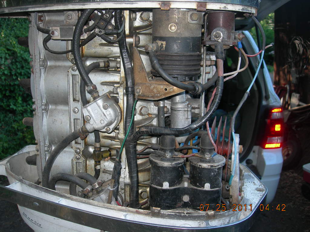

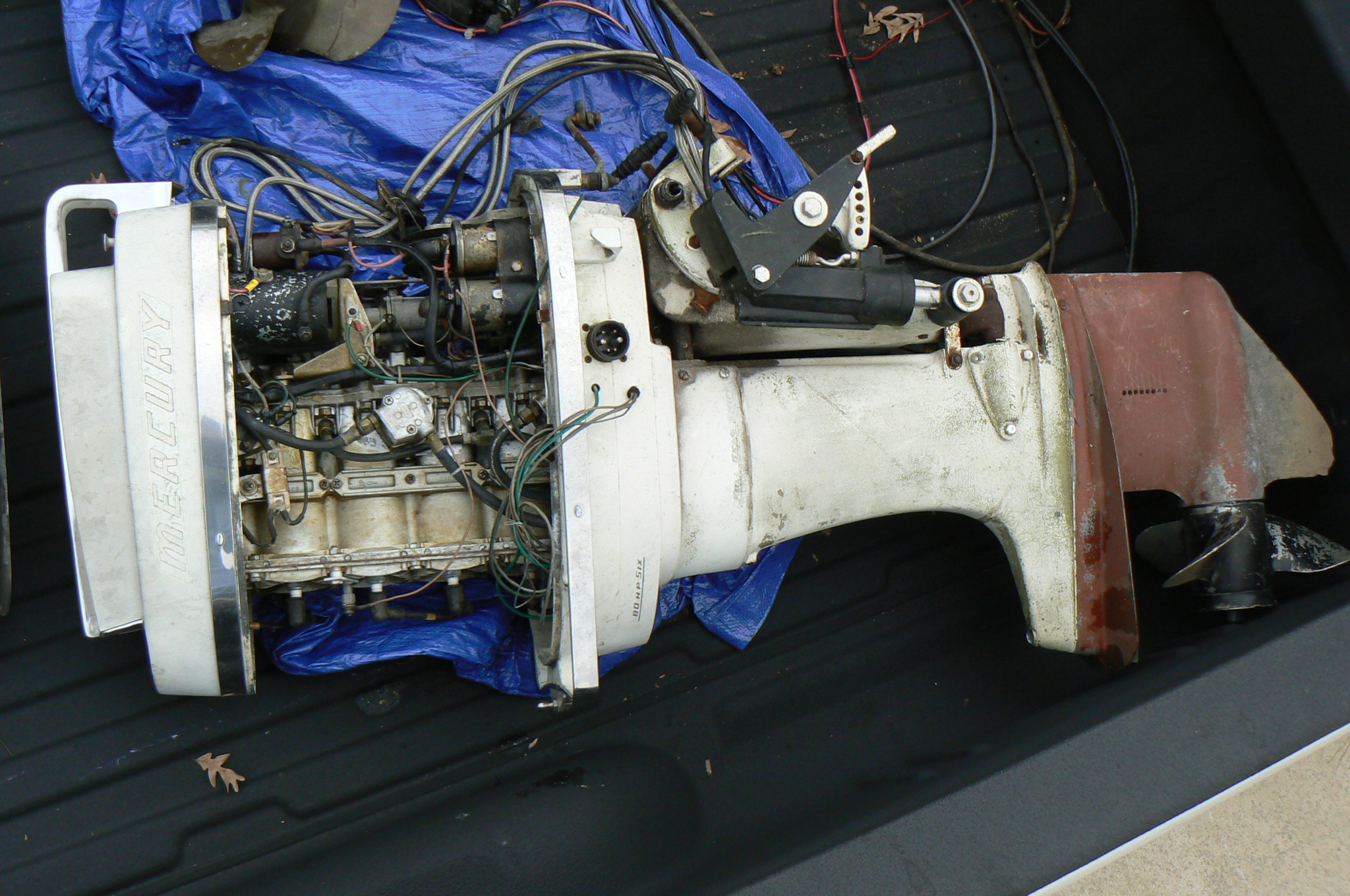

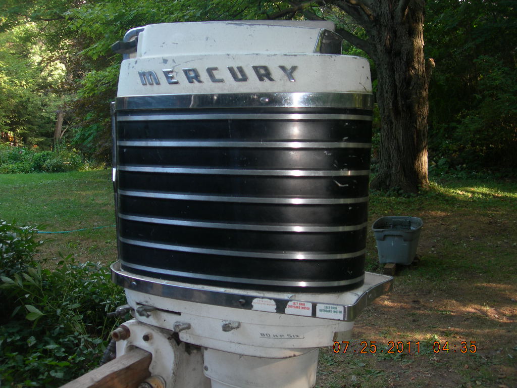

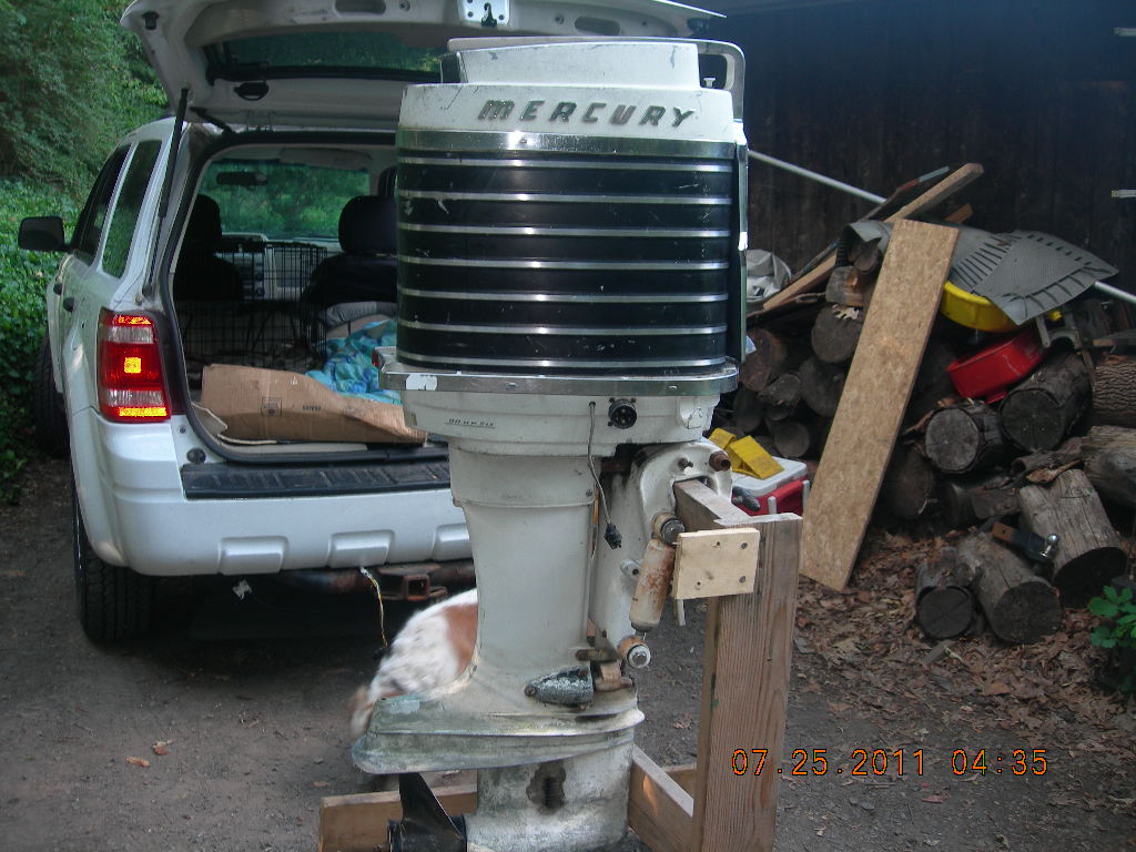

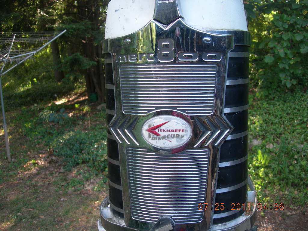

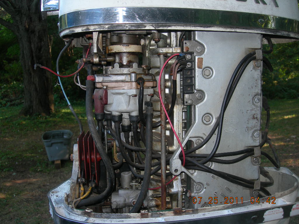

Finally today we got it onto the stand and I got to have a look at it.
Don't know much history other than it ran at one time before the last owner bought it and it is not frozen. Got controls with it but no key.
It appears someone started to take the carbs apart and the screws were missing on all three of the strainer covers of the carbs(found them though...one in the pan and two on the floor of the truck lol)
Cosmetically decent and internally seems like a restore candidate. I have lots of experience with old Mercs but nothing bigger than a 4 cyl so the learning continues.
I will continue to document progress as I continue but this is a start....and I am going to be relying on all of you Merc guys to help me thru this new and exciting process of revival. I won't sleep well anticipating hearing the beautiful sound(and smell) of Merc inline roar again.

Well my excitement has quickly turned to disappointment. Looks like I have a $150 worth of scrap aluminum.
Pulled the plugs and squirted pre-mix and whatever marvel I could get into the cyls and started cranking by jumping the starter.
First test was spark and got none on a few wires. No biggy I'm thinking...pull the mag and clean or replace points/condensors etc. like I have done many times before.
Second test compression.
Results: 1: 120 (looking good)
2: ZERO ...uh oh
3: 120
4: 85 (bad to worse)
5: 120 (why bother continuing?)
6: 120
So now I am trying to console myself thinking oh well get my money back on the lower unit right? Oh dear....can't get it to engage into neutral manually.
Anybody looking for parts? Guess I'll have to get the wrenches out and start tearing it down and continue my search for my next white merc.
That's what I get for buying something sight unseen without a compression check(first and last time I will do that I assure you).
Boo Hoo......

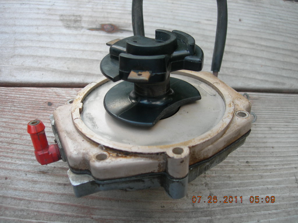

Ok ...while I have it vertical and the pistons(2 and 4) soaking in seafoam and Marvs, I thought I would go at a couple of other issues just to verify condition. I pulled the lower off of it(what a bitch getting the two side 5/8's that were rusted bad.....heat and pblaster and I got them broke just before they were to stripped to even get the wrench on. First indication is too much play in the drive shaft so I guess it will need to be torn apart. Not sure how I am going to get the prop off because someone put a bolt/pin thru it (show u pics later).
Next I pulled off the mag preparing to clean and set the points again and clean distrib cap etc. Now I have a question. This Mag is different than any others I have worked on including the 60 Merc 300.
How do I get these two parts ..apart? Looks like someone else had the idea of prying and broke a chunk out of the plastic whatchamacallit that goes inside the cap.

Yup, been there, broke that! Here's a link to the thread where the guys addressed this problem for me Tim, it takes a special tool to properly remove the rotor.
www.fiberglassics.com/glassic-forums/17-mercury-outpost/28297-63-merc-1000-distignition-problem.html#28321
It probably can be done without the tool, but I managed to drop mine and break it anyway. :ohmy:

Awesome....thanks Mark. Special Tool...should be the alias for Merc.

Re:61 Merc 800 FNR - Finally out of the truck 14 years 8 months ago #38959
  • Thank you received: 5
It ended there (temporarily) because that was about the time I struck a deal on the GT-150, and focused on the road trip to get her home. The Merc got "back-burnered" 'cause I can work on it during the winter months, trying to get all my glass work done before the end of the warm weather season...?
My cap, rotor, and plug/coil wires were all suspect, so I have procured some serviceable replacements. (Thanks Thom!) Just haven't taken time to mess with it much lately. I plan to get back to her soon, I can see the "light at the end of the tunnel" on the glass work. :P

Ok after further investigation the #2 cyl/piston is hosed. I am continuing to evaluate the rest of it. I know starter/solenoid is fine and am working on mag to get spark. Lower is suspect.
As much as I would love to see this old beauty back on a boat, reality of it is that to me right now it is just parts that I can
recover for cash that I can use to hopefully find another. The hard to find parts will also be good to have when I am working on the inevitable restores I will have in the future.
