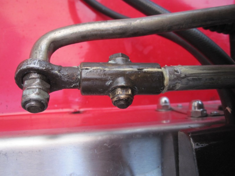

After more than 100 miles on the boat on vacation and after a nearly 300 mile trip trailering it home with nary a problem, I get home, and it's weird the engine is turned. Usually when I trailer, I keep it straight ahead with the transom saver on. Turns out the steering isn't working. Steering wheel works, you can see it turns behind, but it will only move at the end of turning the wheel to the right. Move the motor back & forth, no turning of the steering wheel. What could happen on a trailered ride to make my steering screwed up?

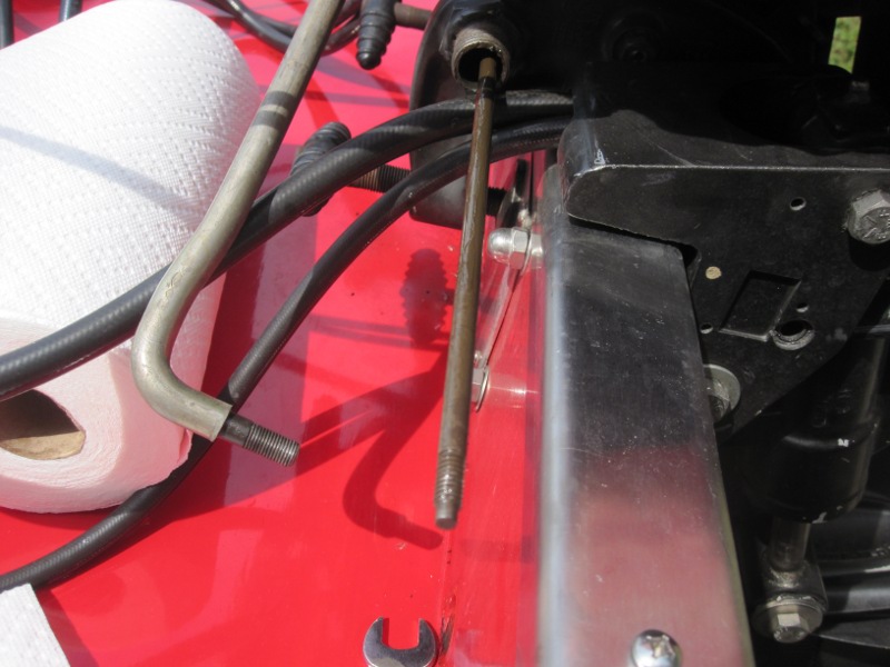

So I figure I might as well take it apart and see if I can fix it. Well isn't this interesting? The long part that goes on the end of the cable and ties to the motor apparently has internal threads that match up with the external threads at the end of the cable!
Apparently it shook apart on the trip home. Why would that happen, and how do I insure it does not happen again? Very scary deal, especially seeing how my youngest son and I were in a 5 mile regatta last weekend going flat out...

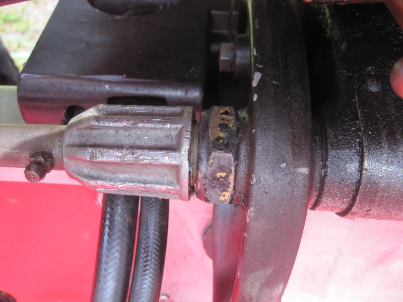

Also, on the starboard side, I tightened the large nut, but now the steering cable end won't screw any farther on. Back the nut off and try and get them to match up?

I have never seen it come apart either. But Power Trim going up and down a lot can put some wear on things. Its possible it came loose over time and when you trimmed up it was backing the end off the threds. A 1/16 of a turn at a time over time and it came apart.
You are very lucky indeed! Get a new cable. Or at the very least if you use it again Drill a small hole thru when assembled and put a locking wire thru it so it cannot back out again. And a lot of locktite for extra measure.

Conrad, thanks for the ideas. I need to fix it, not necessarily because I can't afford a new cable, they are just like finding hen's teeth anymore, especially this short. And when you do find one, it's more than what I paid for the boat! So blue loctite? I would have to clean everything very well to use it wouldn't I? Then just oil and grease stuff best I could? Drill through it, cotter pin okay? Not sure what a locking wire is.
Did you see my 3rd pic? I should back the nut off enough for the screw on part of the cable to meet it, then tighten both at the same time?

Okay folks, found my loose steering problem. This coupling between the steering link from the motor and the end of the cable was on so tight as to not allow the system to work as intended. As the motor was trimmed back and forth, over time, it unscrewed the end of the cable. After much experimentation and work, it is now set up so it will NOT unscrew the end of the cable.
I'm glad I figured this out. What else do I need to know about where this system can come apart? By the way, I'm still saving my pennies for a hydraulic system, but I have decided against increasing hp.
