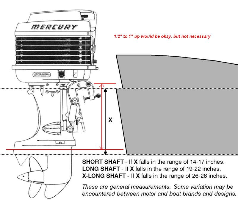

whats the def of a short shaft motir? 20" mid section? get'n a bit confused here?

Re:In-line 6's 15 years 3 months ago #38253
  • Neil
  • Neil's Avatar
  • Posts: 1997
  • Karma: 65
Here you go Matt.

Re:In-line 6's 15 years 3 months ago #38301
  • Matt
  • Matt's Avatar
  • Posts: 586
  • Karma: 3
thanks Neil ...have to add this to my memory storage!
