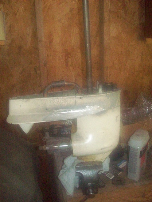

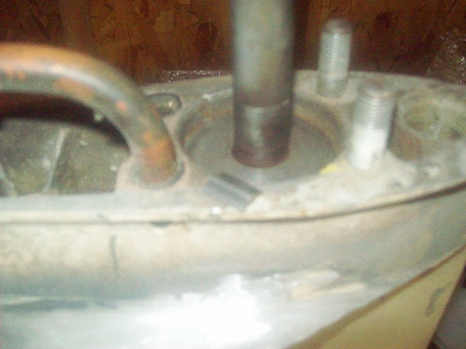

I lost my impeller key and ordered a new one. The 1 I rec'd is the same that was on my MK78 where it goes on flat spot of shaft. My 58 doesn't have a flat spot and am wondering if that's correct. Supplier doesn't think I have correct l/u? I have no clue!!! Seems to me I might have had a smaller key when I put it where I wouldn't lose it!!!
Re:Mark 58 Help 15 years 3 months ago #37470
Joe there should be a flatty can you post s pic of both the key sent and the shaft where the flat should be
and what kind/shape key was in there before it ran away

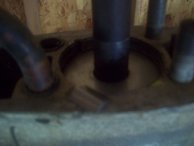

Re:Mark 58 Help 15 years 3 months ago #37484
it is the same style, hard to tell from the pics but it does look bigger
got a part number on the reciept?
Re:Mark 58 Help 15 years 3 months ago #37485
Joe not to overstate the obvious ...but did you remove the stainless waterpump plate...it just lays in pace & clocked by a notch
the flat spot on the shaft and impeller reside under that stainless plate....
in the pics the plate is in place

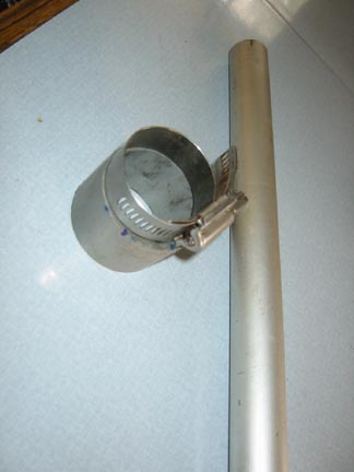

Joe
Place gearfoot in vice at 45 degree angle grease the flat spot on the drive shaft and place the key in place
the piece gray PVC electrical conduit is the flared end and the ID is 1 5/8" (anything with a 1 5/8" inside dia will work) I use this to keep the impeller blades compressed to fit in the cartridge
get a hose clamp to compress the impeller.... place the compressed impeller over the PVC electrical conduit and with your fingers push the impeller into the PVC electrical conduit I spray WD40 on both pieces to slide easier....now mark the position of the keyway on the PVC electrical conduit to clock it
now slide the loaded PVC electrical conduit with the impeller down the driveshaft...and clock the the keyway mark to 12:00 to match the key laying on the shaft
now use the second pipe (PVC water pipe works fine)down the drive shaft as shown and with a quick sharp blow drive the impeller into position in the cartridge

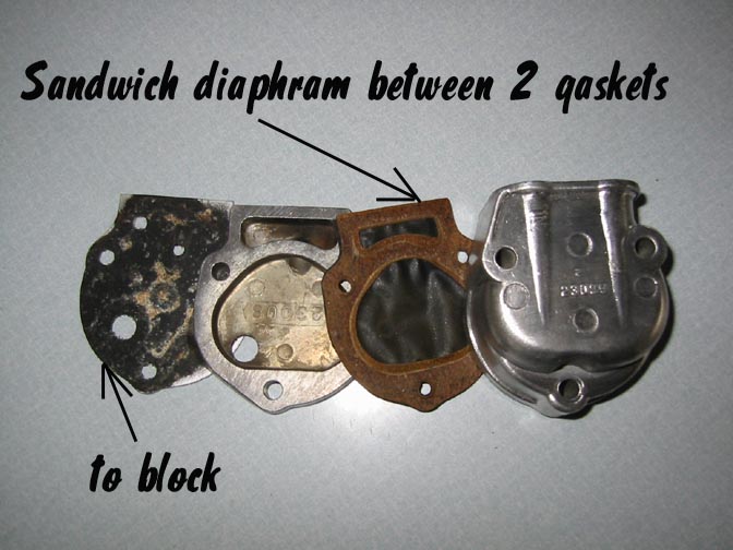

Next ques. fuel pump re-do. I already did it and just looked at exploded view in manual. I went gasket diaghram gasket then a spacer like plate and then black gasket. View doesn't show the last 2???? Thx, Joe
Re:Mark 58 Help 15 years 3 months ago #37509
no problem
