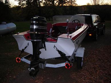

Nice looking motor and Glastron. Very similar to mine, as I have a 65 Merc 500 and 70 Glastron SkiFlite. Wish my 65 Merc was a true longshaft like yours. (Has 5" extension)
