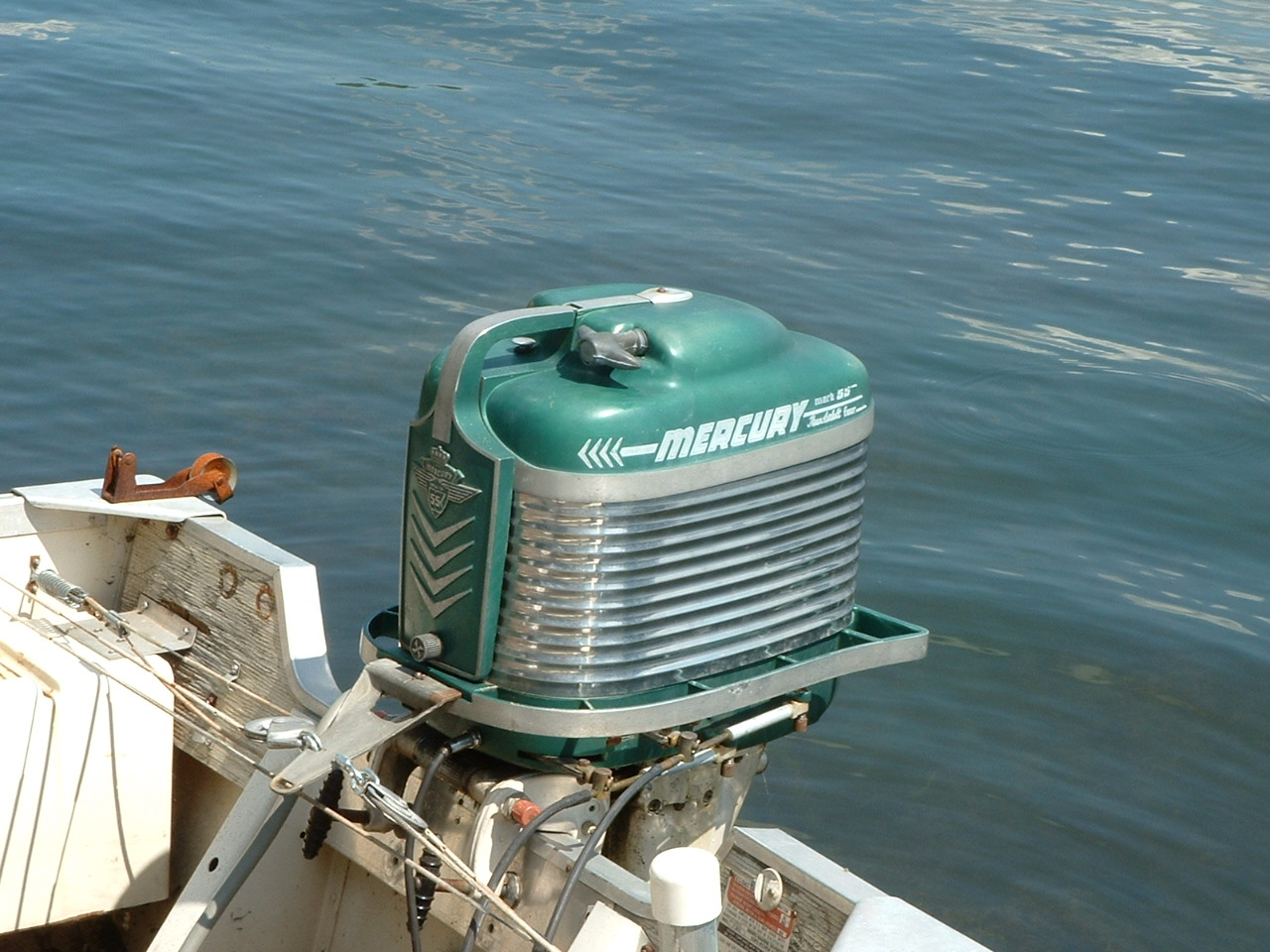

Re:Merc MK 55 Floats and Recoil Starter Lube 16 years 7 months ago #3722
That is a real sweet looking Mark55!

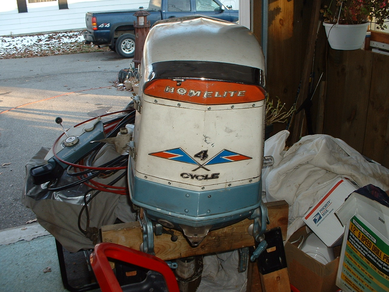

I'm also working on my 62 Homelite. Bill Roberts is helping me with that. Parts and advice.

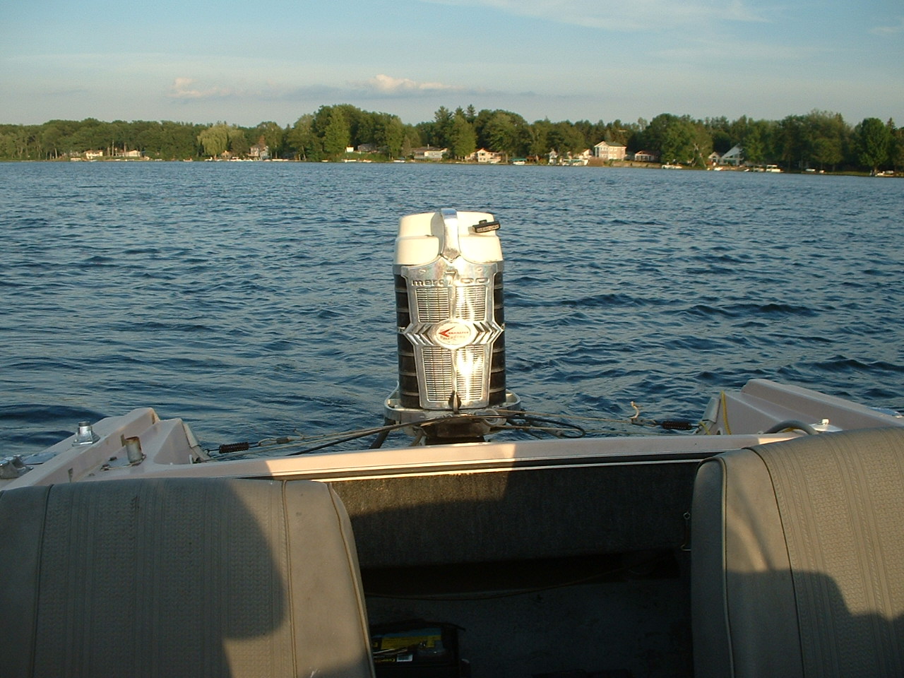

I'll look into that also. I got a nice 14" pitch prop I want to try on it. Right now there is a 12" on it. But I think the 14" will work fine on the Mirror Craft. Also got a nice 9" 3 blade brass that would work if I put it on a big heavy boat or ponton.

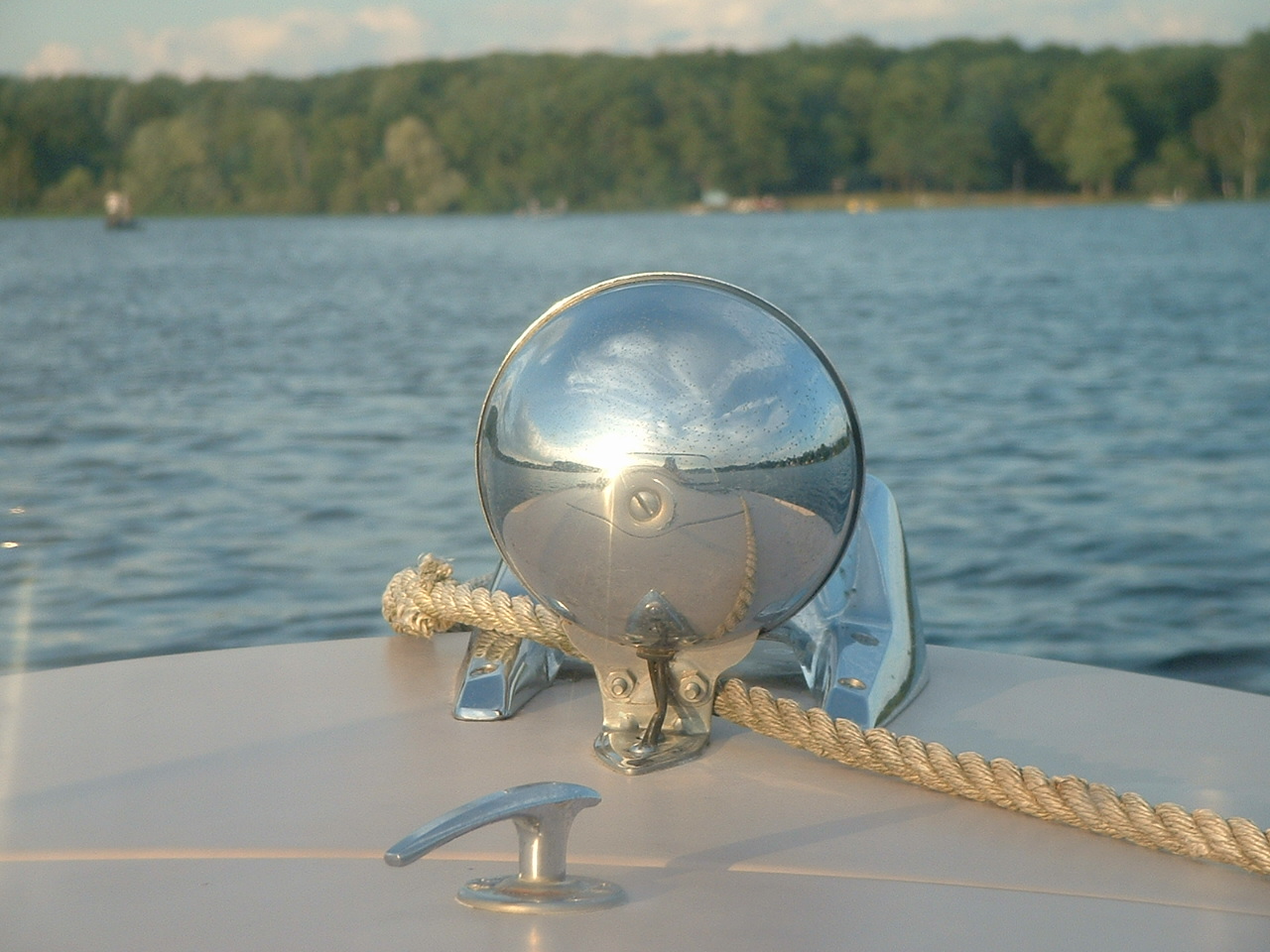

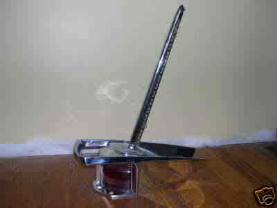

Riiight now I use that for decor in my living room along with a nice vintage bow light illuminated with a night light. Flag staff and all. Like this one. I have a Lone Star Flag on it

Love the bow light, that's awesome! I've got a period correct stern light I'll give you if you ever want to sail your coffee table at night. :P

I have a clamp on stern light for the coffee table. LOL
Runs on a D" battery.

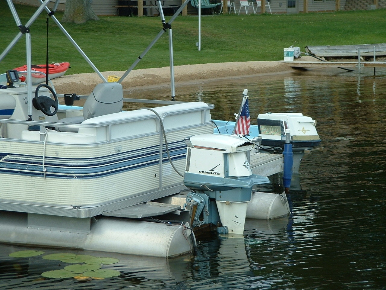

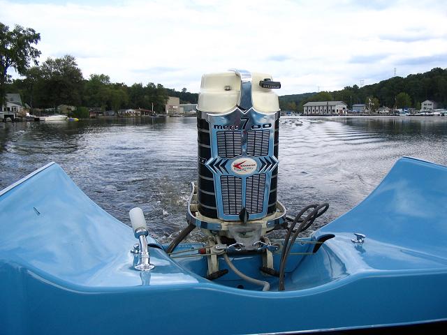

I have a 62 700 FGS on my Lone Star Fleetwood.
Re:Merc MK 55 Floats and Recoil Starter Lube 16 years 7 months ago #3798
love the 700. even though i don't use it much it has never failed me. when i got it back in 2004 all i did was install new fuel pumps, plugs,and water pump. have not had to change the plugs yet. ron

I love my 700 also.
I got mine in 2005. Had to put water pump impeller and lower seals.
Ran great until I was playing with different pitch props and blew a rotor by too much RPM. Still working on that problem. Back together now but spark on only 3 cylinders. Points or something. Just have to tear back into it.

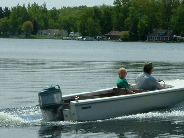

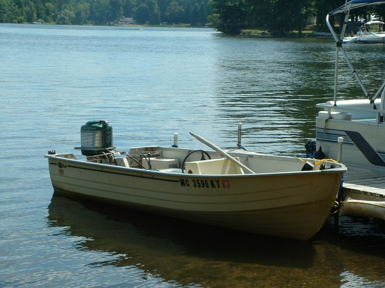

Got the Mirror Craft with the MK55 on the lake and running. She runs pretty good with the 14" pitch prop. RPMS up there nice.
Just got to tweek the carbs a little more. Can't do it Solo.
The old girl is doing just fine. Running Quart of oil to 6 gals.
Also got the 62 Homelite up and running this evening on the test stand.
I was nervous about it until I heard her start up and purr. Will put it back on the pontoon the 1st of May.
Had to replace the distributor drive key (cam) and a distributor.
My old distributor come apart and jammed up. Resulting in a broken drive key. Hence cam work. While it was apart I rechecked the valve clearances and made the proper adjustments also a cam spacer. B) Happy Camper, got alot done.
