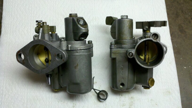

OK - so had to pull the flywheel, starter and distributor. Not so bad getting it all off - just everything's in cramped quarters. Putting it back together shouldn't be too bad - took pictures beforehand to help me out if I get stuck with the reassembly, but seems pretty straightforward.
Carbs weren't in bad shape - expected worse, bowls had a little bit of gunk in them and everything got a good cleaning with gumout. But I did notice the strainer cover on the bottom carb was loose which may explain some of the problems I was having.
Should have everything back together tomorrow night or Saturday and hopefully I'll be back in the water this weekend!
Carbs cleaned up and ready to go...
Flywheel, distributor and starter removed to access carbs...

Everything's put back together and up and running. Started right up. Let it sit for a while, fires right back up this time. Thanks again for everyone's help. As some of you have said - it's not that hard once you know what you're doing - given this was my first time doing this kind of work on a Merc, I'd say it was a success - with you guys getting much of the credit.
Some video of its first run:
Couple of questions - I'm not having to choke the engine at all to start it. Idle speed is a bit high, maybe it's a moot point once it's in the water - but the idle stop screw is backed off all the way. Mixture screws are both one full turn out.
Anything else I need to be paying attention to?
