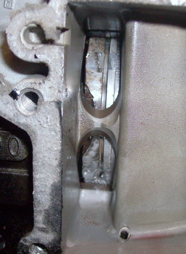

Re: Merc800 #2 way low compression 15 years 4 months ago #36637
  • Matt
  • Matt's Avatar Topic Author
  • Posts: 586
  • Karma: 3
well did as asked....an I'm quite certain I know what the problem is...now have to decide to do a tear down or perhaps...start pulling parts and do a little parting out??? :unsure:
Matt in Illinois
Re: Merc800 #2 way low compression 15 years 4 months ago #36651
Yup, you found the problem. Not an unusual problem. The rest of the engine is likely fine. It could be put back in use by replacing the piston and cleaning the aluminum deposits from the cyl walls with acid. Light hone and re assemble. Or part out if you wish.
Re: Merc800 #2 way low compression 15 years 4 months ago #36661
If you repair / replace the piston , you must determine / find / corect the cause of the damage.
If not you will just be doing this again.
Bleed insert still in that wee hole ????

Re:Merc800 #2 way low compression 15 years 3 months ago #38245
  • Matt
  • Posts: 586
  • Karma: 3
so i pulled it apart tonight...got crank assem. out and 2&4 are bad...2 the worse 4 not sure how it held compresssion..bad lower ring..
no contimplating what avenue do I go? look for used pistons or buy 2 new and re-ring others? #2 cyclinder wasn;t scored but piston show some seird marring wondering if i can't see the bad on the cyclinder?
