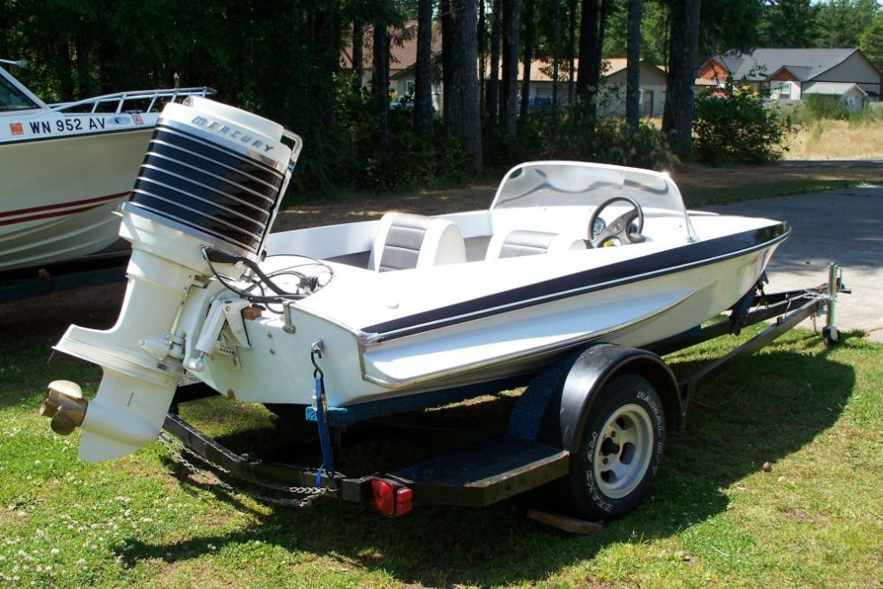

Attached is a picture of my G3 with a true Frankenmerc on it.
The Merc has a 1961 800FGS top hat and cowl wrap.
The powerhead is a 76ci inline-6 850FGS with mid'70s solid state ignition installed.
The lower pan is 1961 800FGS, and the same pan that was used for the 800FGS, 850FGS, and the early 90ci TIGER blocks like the 850 TIGER through the 1100 TIGER. (the 1100 is a TIGER block like the 90ci TIGERs, but is a 93ci due to larger sleeves.
The mid-housing - or - drive shaft housing is a shorty (for 15" transoms) and is the same housing used on the 700FGS thru the early TIGERs that didn't have a separate exhaust extension plete under the powerhead.
The power trim is off a mid'70s inline-6 - like an 1150 through 1500, etc. Many 4 cyl Mercs also used this trim system.
The lower unit is off a 1963 1000.
So,...I am safe in saying,...It is a true Frankenmerc!!
Unless your local fish cops or neighborhood lake watch are Merc experts - - - a 100hp is just a couple inches taller and a decal away from appearing to be a 70 hp.
:laugh:
Thom
