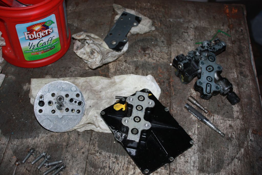

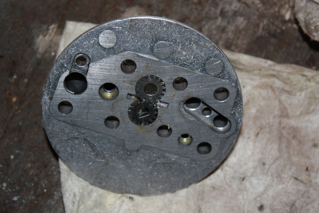

I don't mean to steal the thread, but I just disassembled my pump and shimmed my armature to get better bite in the pump gear. One pump body screw snapped (I even used a micro-torch on it to try to break it free!). There obviously was once an o-ring at the pump body mating surface, but mine had been re-sealed with silicon sealer. There was a LOT of sludge in the valve body, and now I need an exploded diagram of how the valve body components go back together. Anyone got one you can e-mail me?

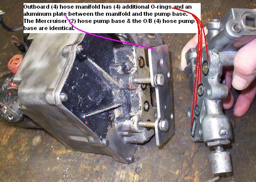

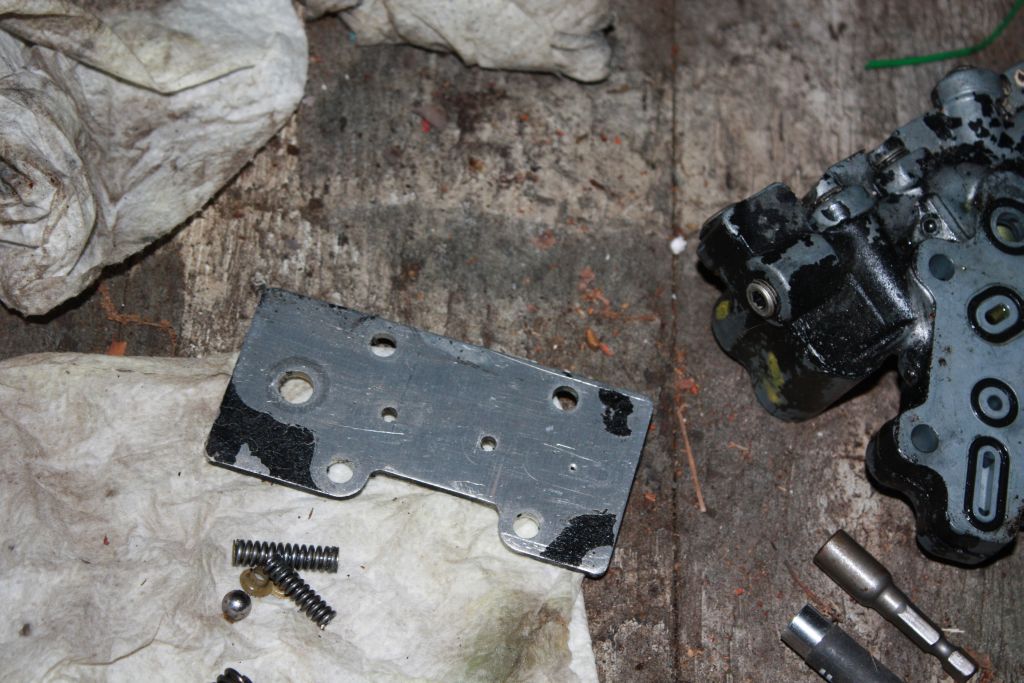

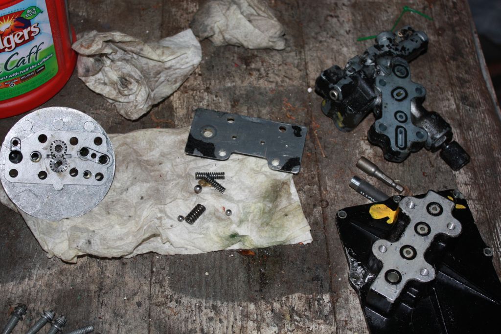

Thom, I received your hose manifold and it looks just like my hose manifold. But I miscommunicated my problem. I have NOT disassembled my bhose manifold. I HAVE removed my hose manifold, and that's when the three springs and three check balls fell out. My question regards the reassembly of the manifold and plate to the pump body and SPECIFICALLY the orientation of the springs and check balls.

I have NOT disassembles the manifold which has the adjustments. But I HAVE removed the manifold from the pump body, and that's when the springs and check balls fell out, depriving me of the visual orientation of the springs and check balls.

Here's what I've got:
