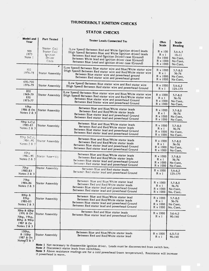

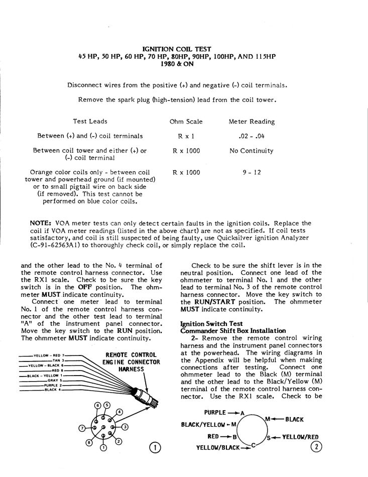

Bobo,
When the beast starts acting up - does it do any good to manually squeeze the prime bulb?
Sounds like this gremlin is really giving you the runaround.
Yes,...A component of this ignition could cause these symtoms.
I have attached the tests required to test the stator, trigger, & coils.
Hope these help.
If any of these tests suggest even a hint of possible cause - there are peak voltage tests as well that require a DVA meter and further spec sheets to test.
Thom

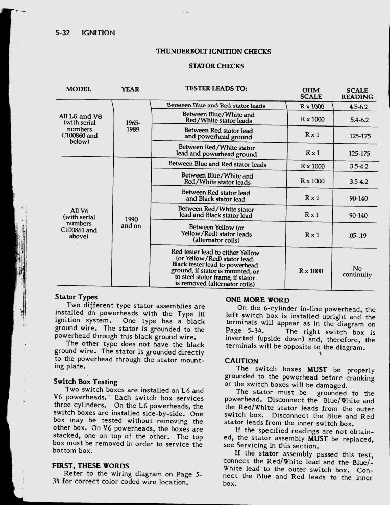

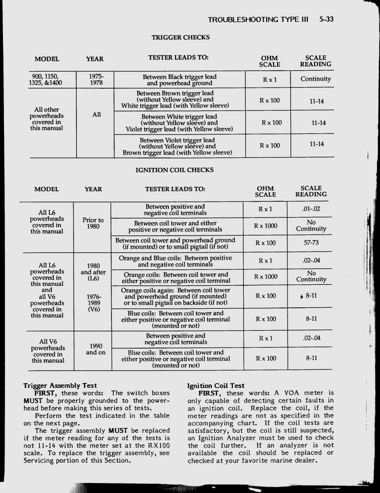

The Dr is in ... L.O.L..Thanks much ..Squeezeing the ball doesnt help .I thought it might be a fuel problem so I tried that .When I hit the choke when she was stammering it flooded it .So Im pretty sure ive got the gas getting to her .I was a GM mechanic for 10 years and a Body Man for another 8 .Outboards are a whole Different ball game for me .Same only Different ..L.O.L..This motor has given us Countless hours of Boating Pleasure Never a Problem . Still has Great Comprestion to .The only thing it did in the recent few years was sometimes after you started it for the first time of the day It would Stammer for maybe 5 to 7 seconds Then hit and be fine for rest of the day without problems .It wouldnt do it every time I took it out Just sometimes .So what happens here ?? When your stator coils line up it sends voltage to the Boxs then they basically Dump Juice to the coils ??
Re:Dam Maintainice Now What ? 15 years 4 months ago #36312
  • bobo
  • bobo's Avatar Topic Author
  • Posts: 549
  • Karma: 22
I didnt see the 115 6 clyinder on the chart unless im Reading it wroung .I should look up the year to .Its a Blue Band with No distributor , 6 coils and 2 Boxs ..
Re:Dam Maintainice Now What ? 15 years 4 months ago #36338
Sorry 'bout that,...I sent the 3-4 cyl pages.
Here are the inline-6, etc pages.
Thom
