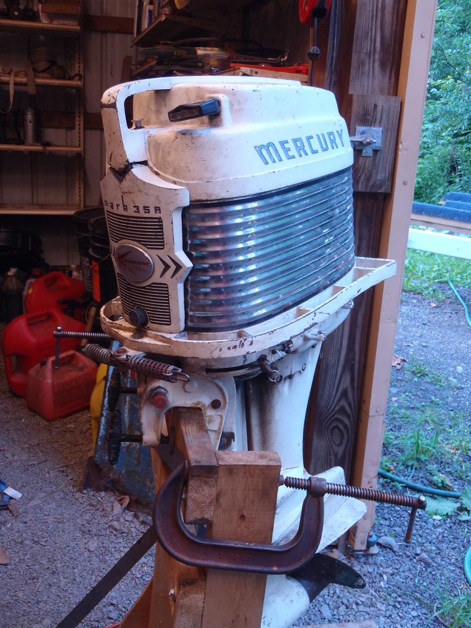

Ok yup I am Jesse And I am an addict...

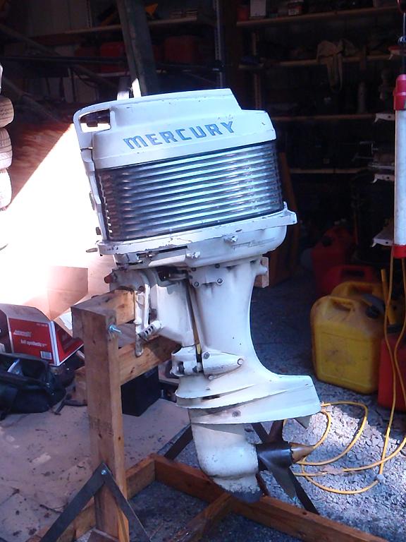

Mark 35a, no spark yet but 90 psi on all cylinders was an electric start at some point but is manual only now. No time to work on it now more latter....

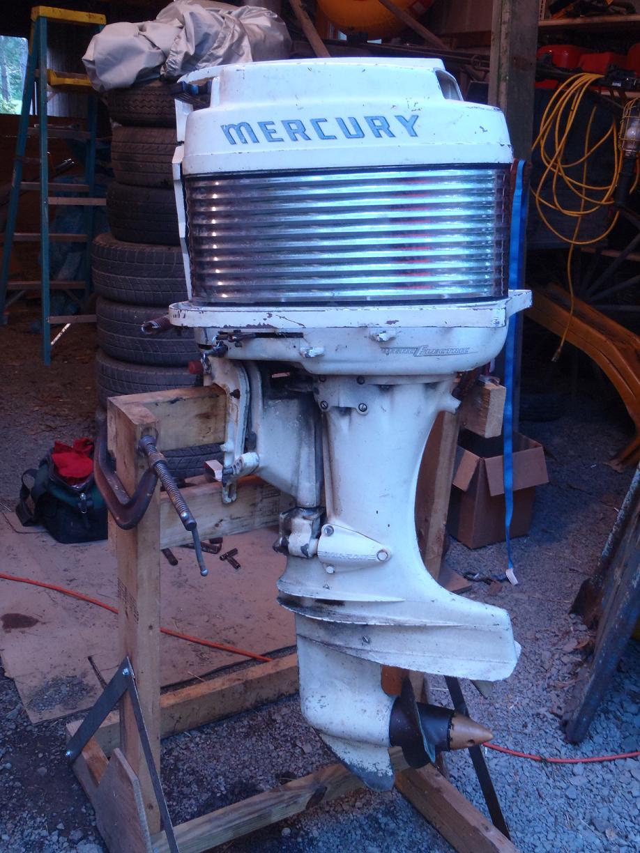

Well its all torn apart... Got spark finally, but cant get the water pump apart.... its one that needs a spanner with 4 lobes and is set into the LU... any suggestions... what direction to turn it to take it apart? etc... also the water tube came out with the lower.... cant seem to see the hole it goes in from below any ideas on how to get it back where it belongs?
Re:New ponny in the stable.... another one... 15 years 4 months ago #35610
it is towards the rear you have to feel for it or pull the powerhead.
Re:New ponny in the stable.... another one... 15 years 4 months ago #35614
  • Neil
  • Neil's Avatar
  • Posts: 1997
  • Karma: 65
Soak that waterpump cover with penetrating oil for a time and it screws off counterclockwise.

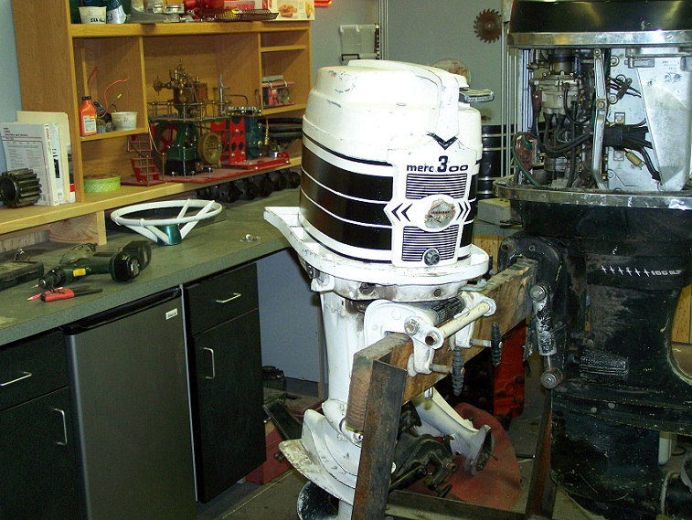

Jesse
Did the controls come with it?
Is the prop nut/cone plastic or metal?
I have both and am not sure what the plastic actually came on.
Looks like the cav. plate is still intact. These little guys that I have been finding have all had holes from po's putting the stabilizers on them.
Kinda odd that the steering springs are at the motor.
Any ways, keep us posted with this little Merc.
It really wants to run again, I can hear it whispering!! ;)
Here is my latest little guy with the all white faceplate.
It has a broken front emblem. It has an extra tube in the front to accept the larger diameter steering rod.
I got it and controls for $38 bucks. You may have seen the post here.

Jesse,
I didn't have the special Merc tool when I restored my little white 300 so I simply resorted to using a large punch and hammer alternating notches to get it turning. I didn't end up hurting it much.

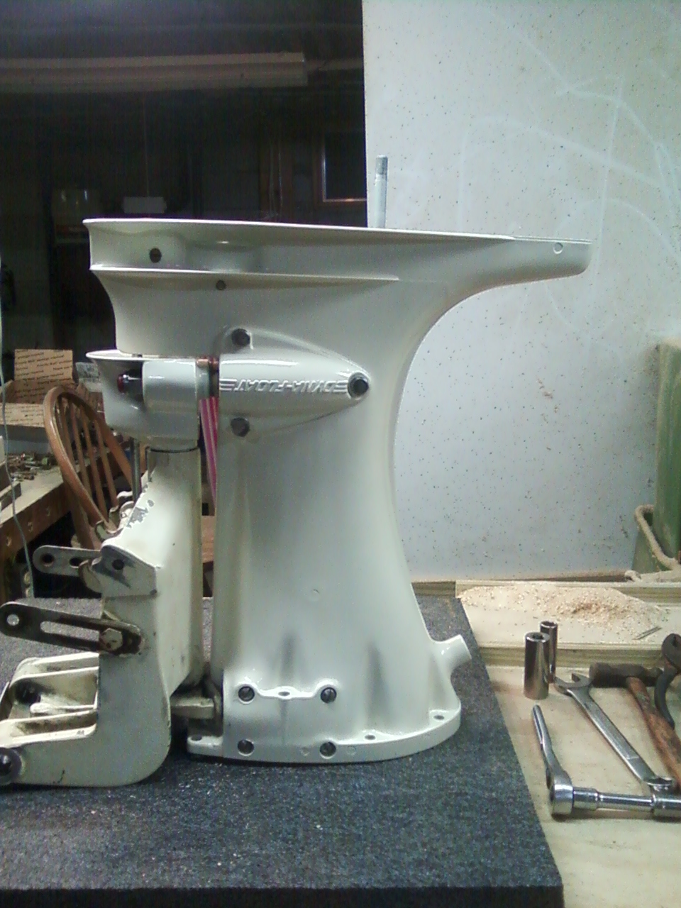

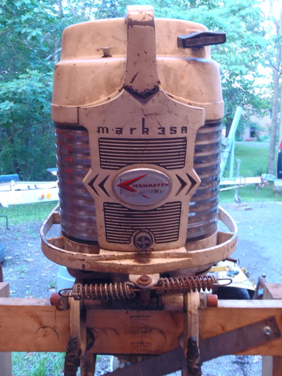

Neils, Work on his 55 got me thinking.. I have this little guy apart as I needed to clean out the telltale and I should repaint the old girl. Now I was not sure is a Mark 35A a color match to be a ford wimbeldon white? Could some one chime in and let me know the proper color to paint the old girl? its going to go on my utility racer I think..
Re:New ponny in the stable.... another one... 14 years 11 months ago #50341
Here's a source for correct colors: www.nymarine.ca/colours.html
Re:New ponny in the stable.... another one... 14 years 11 months ago #50351
cloud white is the merc color..
Re:New ponny in the stable.... another one... 14 years 11 months ago #50356
Early 60's
Ford
Whimbledon White is a good match.
Re:New ponny in the stable.... another one... 14 years 11 months ago #50357
  • stashm2
  • stashm2's Avatar Topic Author
  • Posts: 666
  • Karma: 25
Thank you All, Professor that seems to be an easy readily available color on a quick search. Does any one know the actual paint code? for Cloud white if I were to try to get it mixed? Its easy enough to say cloud white on the container but it may not be the same company to company. I will likely just go with the 60's ford whimbledon.

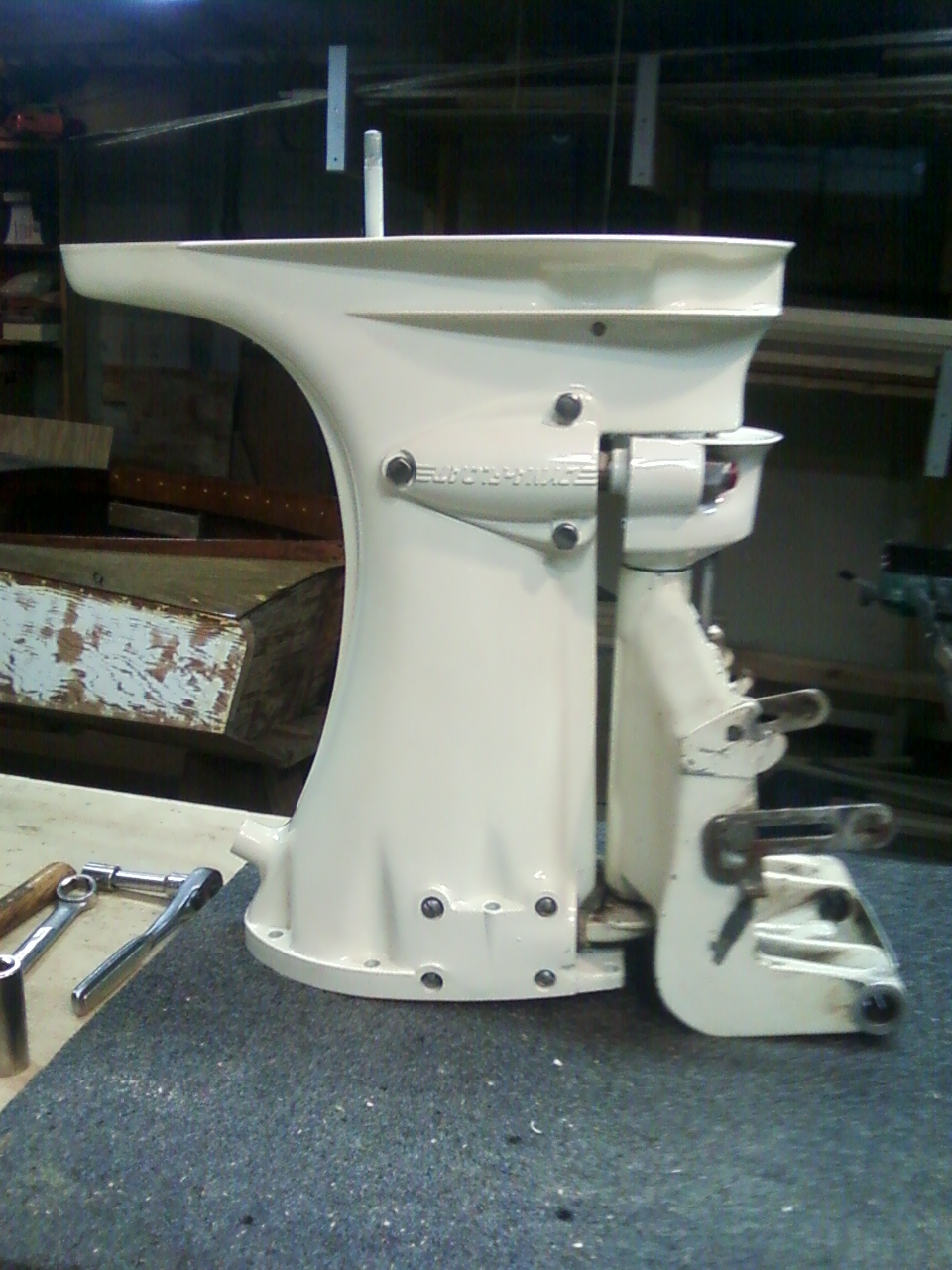

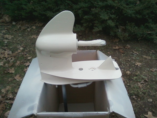

So not perfect but not bad, I didnt paint the portion of the mount with the ID tag as I didnt want to try to mask that off while stripping paint or trying to rerivet it if I took it off.. Looking ok for my first repaint on a white Merc. Used the Duplicolor Whimbelton White.
Now if my gaskets come I can reassemble the rest of the motor and store it away for the spring.. B)

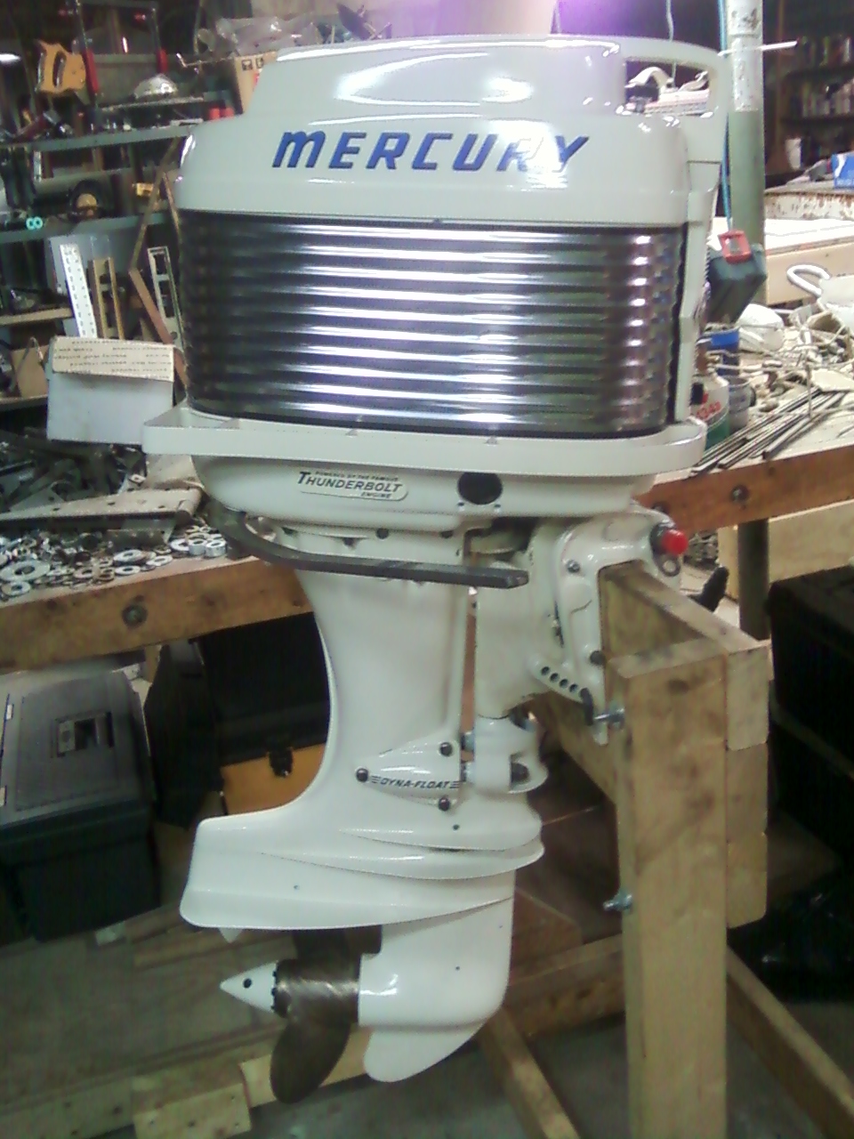

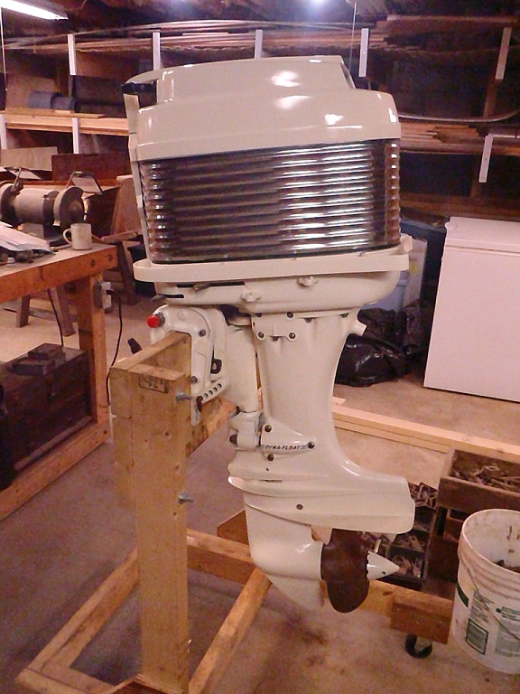

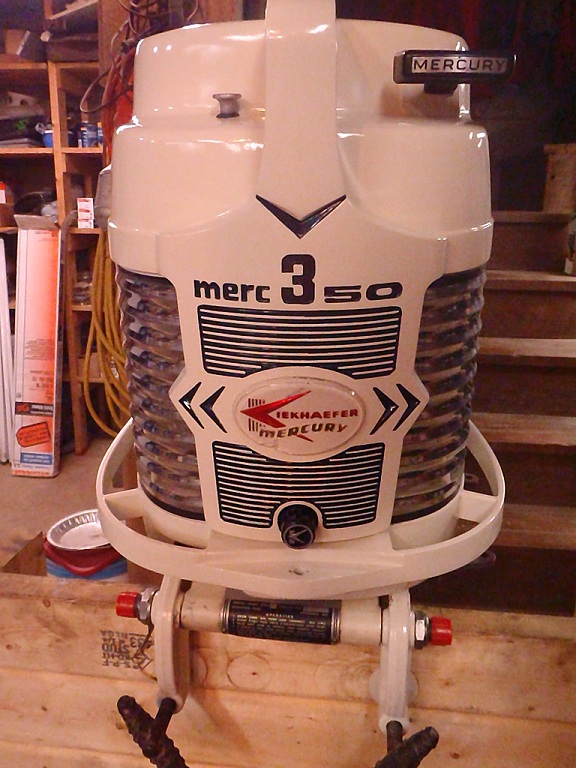

Well I finished most of the painting and just need decals!
Thanks for all of the input. I will repaint the 35a faceplate when I get a chance.
Re:Mercury 35A 14 years 9 months ago #54762
Great looking job on the motor. The color came out really nice. It's gonna look sweet hanging on the back of a boat. Skip.

Re:Mercury 35A 14 years 8 months ago #56088
  • stashm2
  • Posts: 666
  • Karma: 25
Ok Really Done now! Decals and all.
