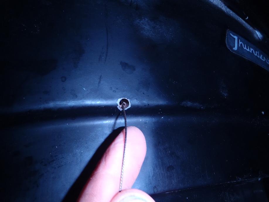

I wish someone could do a shot of where I stick this wire, or a diagram or give me a more detailed explanation. I'm still at a loss, and eager to try something. Once I get it, I will not bug anyone again, honest, just need some directions.

Re:pee tube - no pee! 15 years 4 months ago #35608
  • stashm2
  • stashm2's Avatar
  • Posts: 666
  • Karma: 25
Hi Frank, I was out working on the 35A all evening. Here's where the Tel tale is on my 125.and what I use to clear it.
