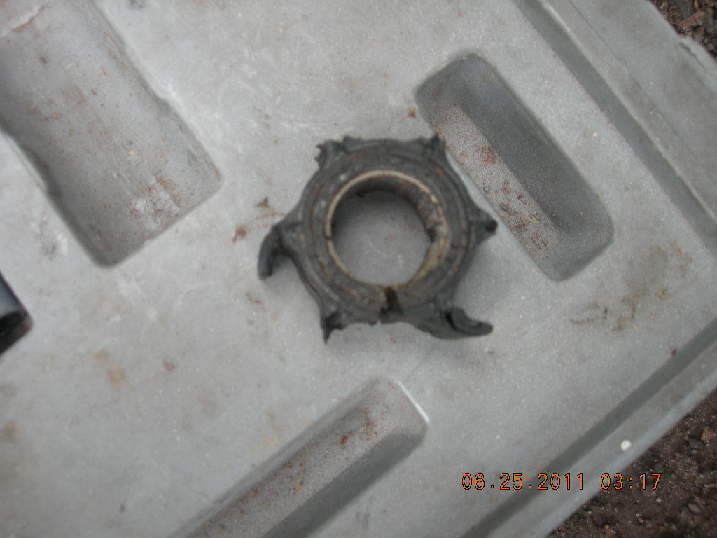

In the mean time. This is exactly why you always replace the impeller on a used motor you buy.
Of course besides the two small pieces I found in the pump I was concerned that the rest of the fins were blocking up passages in the water jacket and tell tale etc. But when I put it back together with a new impeller and fired it up....it didn't initially start pumping but after a few reams with a 12 guage electrical wire it started to flow and then a steady stream.

the impeller was run dry as you said earlier 15-20 seconds will destroy them that way.set idle screws at 1 1/2 out from seated to start cough is lean so out is richer. turn them in slowly till it starts to slow then back out 1/2 to 3/4 turn then do it again in the water in gear.

Dave.... actually I did not say it ran dry and I certainly did not run it dry...every time I cranked it I had water on btw.... I know better. It was toast before I got my hands on it.
Pumping great now though.
