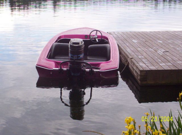

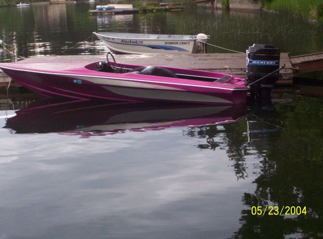

I attached pictures of my old Tahiti and 1400. Great combination!!!

Great pics, just like my boat, I would love to know more about the tahitis.
