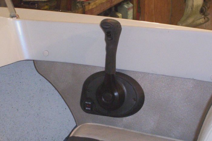

Re: Still trying to understand, controls for 1969 Merc 15 years 4 months ago #34878
If you can't find a sweet original style controller you can always identify the specific components inside that are worn out and I can send you nice good condition used parts.
If you are interested in a much later style controller with potentially less wear time, etc,...They do show up on eBay.
I have attached the one I use.
I run an early '60s 800FGS and an '87 115 with this control box so it will work with with many Mercs.
I believe it is called a Series 4000. It requires your wiring harness go to the dash rather than the controller though.
No big deal though.
Just purchase an ignition with a push-in-the-key to CHOKE and you'll only need to drill one small hole in the dash for the ignition.
The power trim is in the handle, and it comes equipped with a ssafety shut-off switch used with a lanyard.
Thom

Re: Still trying to understand, controls for 1969 Merc 15 years 4 months ago #34949
So the cables will hook up to this controller that I have already, or will I have to purchase different ones? Thanks for all your help! This is more in line with what I would like to do!

Re: Still trying to understand, controls for 1969 Merc 15 years 4 months ago #34987
Ahhh I misread the quote "this controller I have already" I see what you mean now.
Thom will have to answer if that controller works with standard old merc cables.
