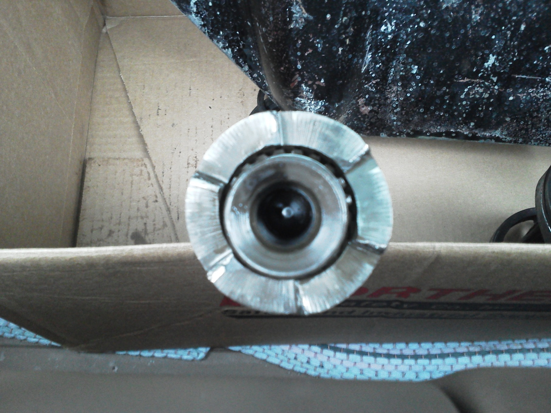

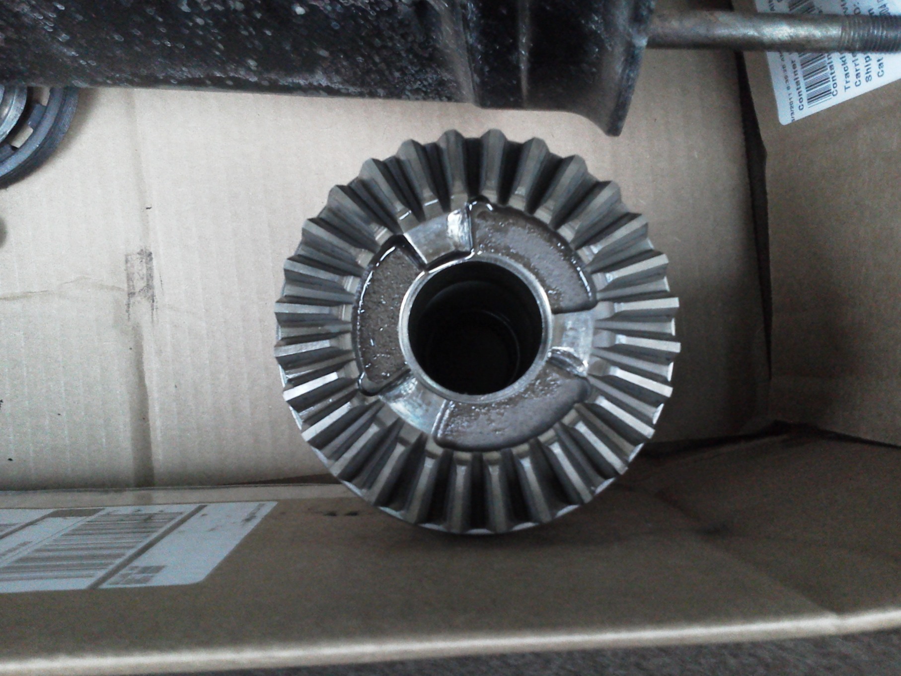

Doc thanks so much for writing that out. I tried all that you said and it was right on. I then tore down the lower unit and found the shift cogs on the gears very rounded. This would explain why it would, at low speed work, and then apply more torque it lets it spin by the cogs. If you have, and wanna sell a shift cog and forward gear for a 4 inch housing with 2 to 1 gears I am all ears.
I am not to worried about reverse it worked ok. I doesn't look good from where I am sitting LOL :laugh: One more question anyone every re machine the cog to square them again?

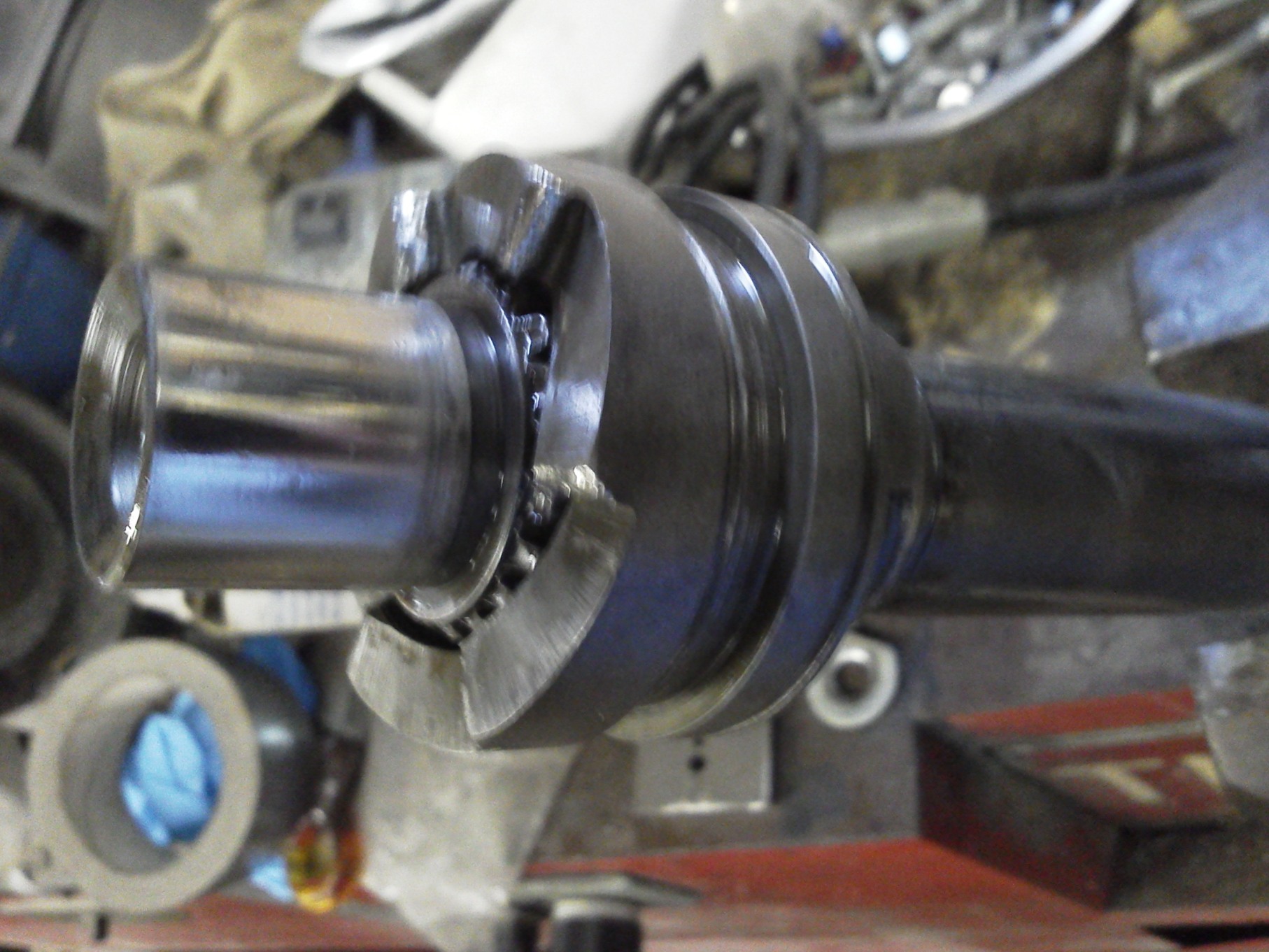

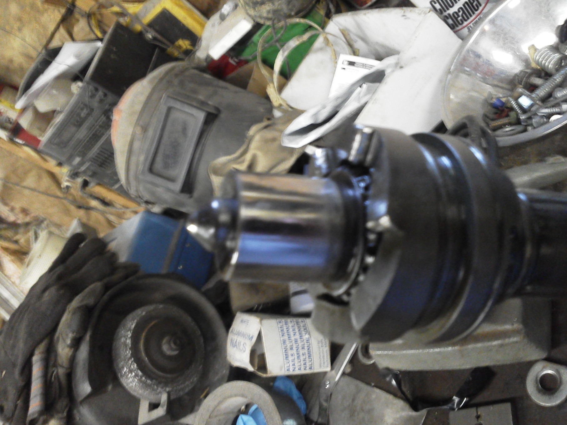

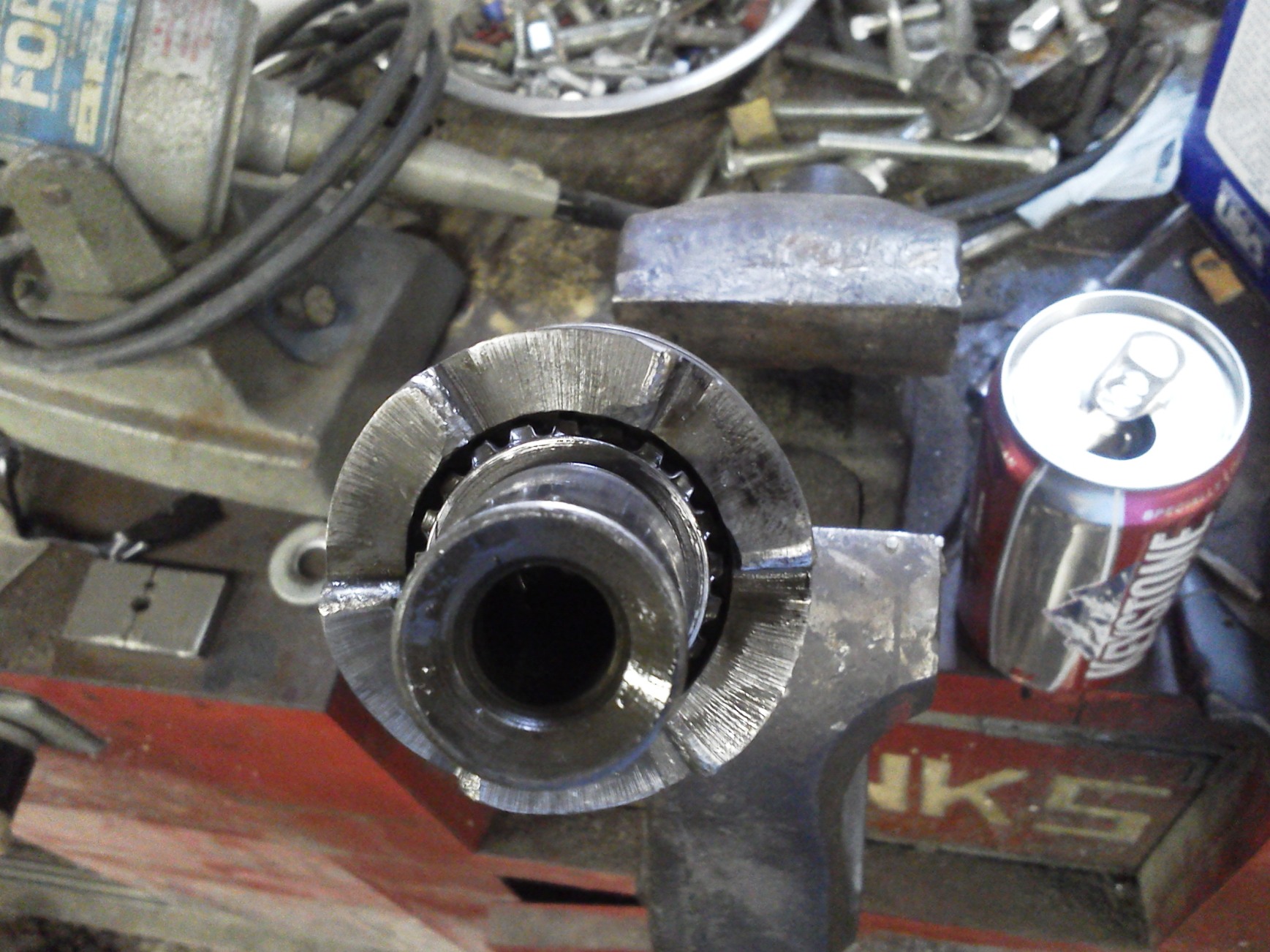

Has this lower unit recently been disassembled? Perhaps during re-assembly the propshaft and bearing carrier were properly seated, or perhaps something got left out of the ratchet assembly that allows the cam follower to be so deeply sunken into the fore end of the propshaft??
It's not unusual for the Reverse gear dogs to get thrashed due to a worn shift cam, etc, but it is unusual for the Forward gear to loose its dogs.
How does the Forward gear's main roller bearing and race look?
How does the needle bearing look at the front end of the propshaft?
Can you take a picture or two of the propshaft from the side so I can get a better look at the cam follower.
It looks like is is way too far into the propshaft.
Is the cam follower spring still in the propshaft?
Is there still a pin loading the sliding clutch?
Is the cross pin retainer spring still in place on the outside of the sliding ratchet?
How do the driveshaft bearings look??

everything is still on the prop shaft the drive shaft is giving me fits to remove, but I haven't had much time lately. The shift cam looks marked up pretty bad maybe some binding.
