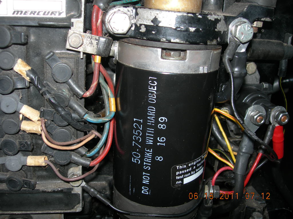

I picked up a nice Blue Stripe(late 70's I suppose) Merc 50 hp today for a song. The starter was removed for another use but luckily I have one from a 89 40 Classic that I am parting out after the oil injection failed and fried the pistons etc. Problem is I am not sure where to connect 5 wires from the motor side harness.
The starter has 3 posts...top, near bottom, and slightly above bottom. I figure that the top post is negative and connected to the block on one of the top starter mounting nuts. The very bottom one is the Neg cable to the battery. The third near the bottom is Positive and has the red cable to battery.

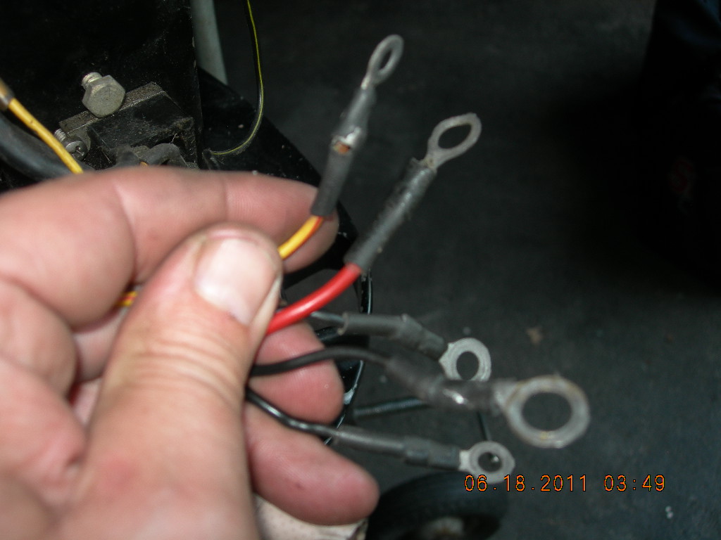

Now where do these 5 little wires from the harness connect?
There are 3 black(one has a very small connector on it) one red(I assume goes to positive post on starter, and one yellow with a red stripe(choke solenoid maybe?).
Have a look and hopefully give me some hints. Thanks, Tim

Now the big question.... I have two small black wires out of harness(one connector smaller than the other) left over. I am betting at least one is grounded but where would they go.

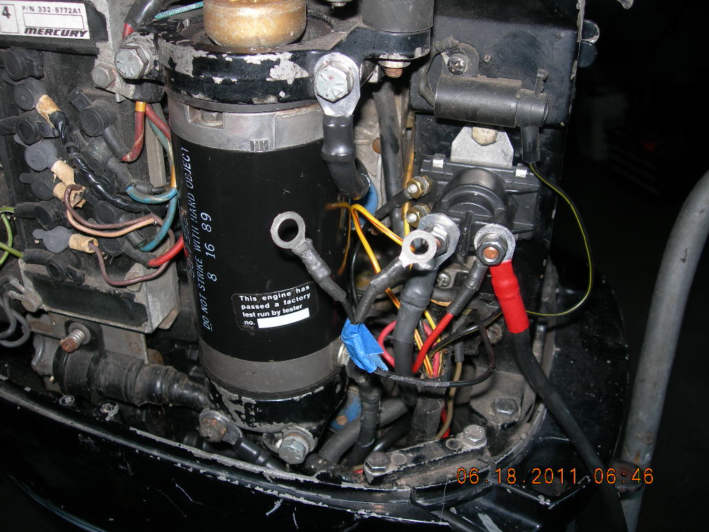

Here is a few pics.

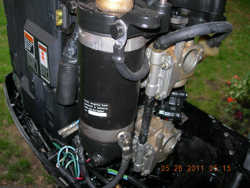

THis is the starter still in the newer 40 classic"
Here is the starter in the 50. At the bottom of the starter the neg to the batter is connected to the left lower mounting bolt. The upper right bracket mounting bolt is connected to the upper post on the starter(behind you cant see). The positive from the battery connects to the right side solenoid big post and the left side big post goes from solenoid to starter lower in pic.
The two left over blacks out of the harness are taped with painters blue tape. Where do they connect?

Starter has two posts....top and near bottom. Top is ground which has a cable running to one of the upper starter bracked mounting bolts. Bottom is hot(+) which connects to one side of the solenoid. ***YES YOU ARE CORRECT***
Solenoid has two main larger posts and two small. Battery + connects to one of the large and starter lower connects to the other solenoid main right? ***YES***Now for the wiring harness connections. Heavier gauge red goes to one of the solenoid main posts for + connection to key/switch.(I assume on the battery side of the solenoid right? ***YES***
Yellow with red line goes to one of the small posts on the solenoid and a black wire(with very small connector) goes on the other small post on solenoid. ***YES YOU ARE CORRECT***
***The black with the larger lug connector will go to a 1/4 x 20 bolt nearest to it*** The black wire with the smaller lug will go to the switch box plate. You may need to extend it or simply find a spot for it to connect to. ***Are you sure it is not a black wire with a yellow stripe?***

Ok Jim how's this look? I connected one of the blacks with the bigger connector to the upper right starter bracket and the other one with the small end across the starter to the lower right mounting bolt on what I assume is the switch plate(where the coil wires run into?)
Tim

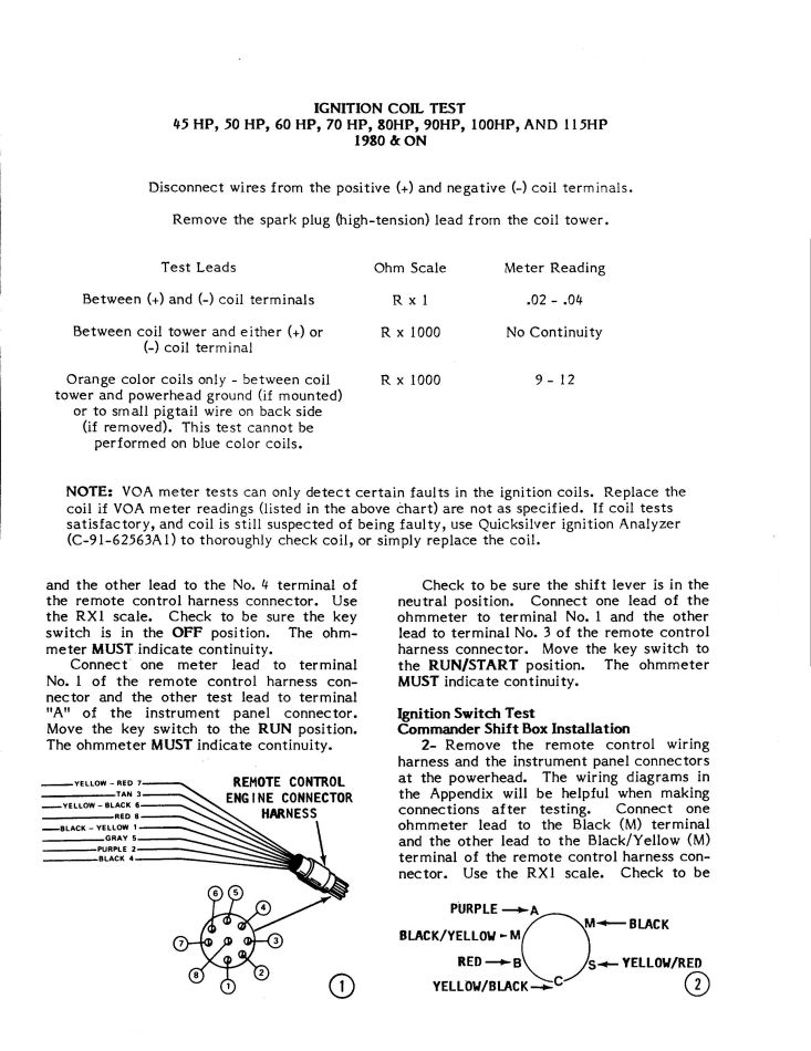

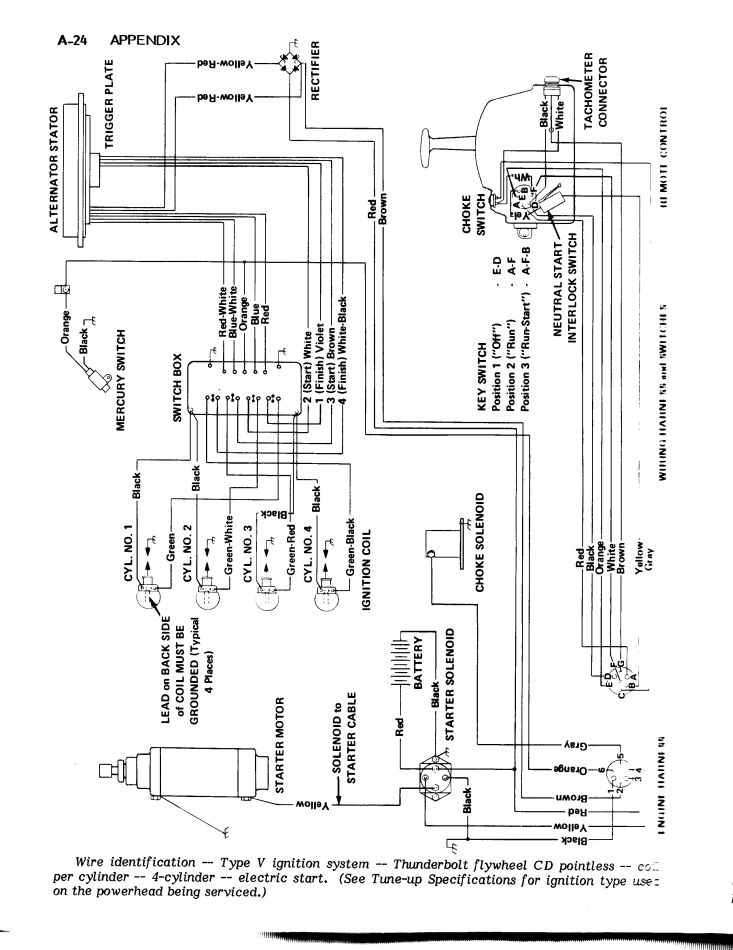

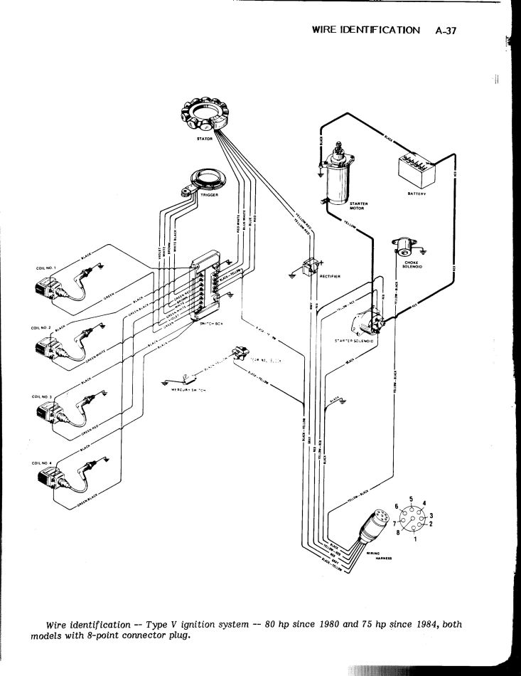

Re:Help Installing Starter on Blue Stripe 50 Merc 15 years 4 months ago #34746
Tim,
I couldn't find a wiring diagram specific to your 4 cyl unless it originally had an internal harness that went through the side of the lower pan and plugged into a cobra-head type external harness.
I have attached copies of several wiring diagrams of the type of ignition you are working with.
The yellow with red stripe solenoid wire suggests the internal harness you are using is the type with an eight pin in a circle plug-in that mounts inside the cowlings and has the 'industry standard' wiring colors that were different from the earlier cobra-head type harnesses.
Anyway - I'm sure that if you study the attached harnesses you'll be able to identify which one is closest to what you're working with.

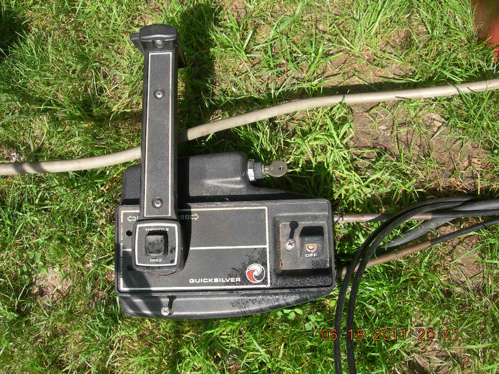

From the SN (5799264) I figure it is a 1981 btw.
The wiring harness connector is not the older cobra that connects on outside of cowl but rather a smaller round 8-pin that goes inside the cover and connects to the female connector under the starter. Here it is just connected outside for testing.
And here are the controls:
Here is a list of the 8 wires on the motor side of the harness and what they are connected to:
These I found connected already:
1) Red => Rectifier
2) Grey => Rectifier
3) Black/Yell => Switch Box
4) Yellow/Black => Choke Solenoid
5) Black/Yellow => Mercury Switch I believe
These were dangling with no starter or solenoid in motor and
where I connected them:
6) Red => Large terminal on Solenoid (battery side )
7) Black => Small terminal on Solenoid
8) Black => Gnd on starter motor bracket bolt
9) Black => Gnd on switch box bolt.
10) Yellow/red => 2nd Small terminal on Solenoid

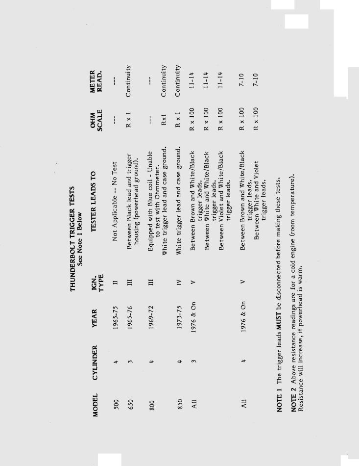

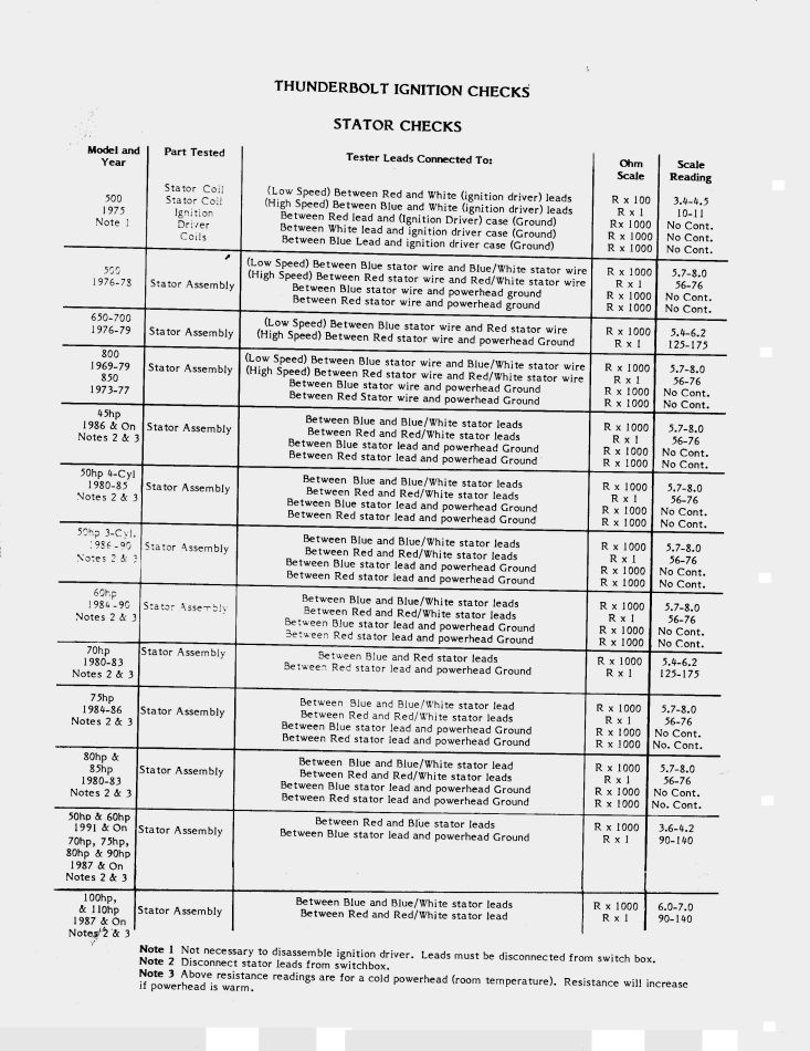

Re:Help Installing Starter on Blue Stripe 50 Merc 15 years 4 months ago #34788
As you probably know by now - this ignition creates its own electricity and does not need a 12vdc battery electricity to create the spark.
If the control box is attached and the key is in the 'ON' or 'START' position and you don't have any spark, try these (2) tests before proceeding to individual tests of the switchbox, coils, and trigger.
1) Disconnect the white with black stripe wire from the switchbox to identify whether or not the 'BIAS' ciruit has failed & test for spark.
2) Dis-connect the black with yellow stripe wire from the switchbox and test for spark. Be aware that while this black with yellow stripe wire is disconnected the Merc can start and continue to run until the black with yellow wire's terminal on the switchbox is shorted to ground (-).
After these tests, since you don't have spark on any of the (4) cylinders, I would suggest begin component testing on the low side of the stator as per the manual.
See below. (if you can't read the attachments due to size - write direct and I'll send them to you larger and easy to review.
Thom

Ok Thom I finally got back to trying some more of your diagnostics. I started with the Trigger figuring that since I had no spark it was unlikely all coils bad, and stators are usually pretty hardy.
The first set of pairs White and Violet showed continuity acceptable at 8.4(between the 7-10 range)
The second pair Brown and White/BLK failed.. no continuity. Remember that this white/black was also the wire that had its insulation pretty much disintigrated and I wrapped it. I even double checked on the spare trigger I have and yes they are both within range as described.
So while I wait for my flywheel puller to be delivered, I'll check the Stator wires while I am at it.
