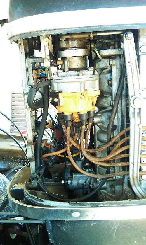

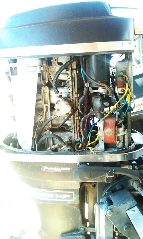

have it tested at a dealer . ebay has them. can you send me a pic of the mag daveb409@ hotmail.com.so i know which one you have.
Re:I need help...... 1969 merc 1000 ran great til i 15 years 4 months ago #34682
Thanks for the help I just sent the pictures. Let me know if you need a better angle

Take a photo of the motor is best. You probably need something like this...
cgi.ebay.com/ebaymotors/Switch-Box-332-2986-outboard-mercury-/230633138598?pt=Boat_Parts_Accessories_Gear&hash=item35b2ce69a6
It is possible but you may have toasted the distributor but who knows. The rectifier is the smaller looking switch box (typically mounted under the larger switch box like in the ebay link) unless it has been modified with the small black 3 post rectifier.
Start with the switch box though. I have them but I am sure many others also have them out here and on ebay as well.

thanks here are some. also how much do you want for yours and do you gaurantee it to work? i prefer to buy from board members or vendors to help everyone involved out as long as i can afford it.
edit sorry i have to figure out how to resize them
Re:I need help...... 1969 merc 1000 ran great til i 15 years 4 months ago #34688
other side

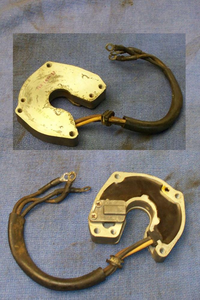

Haven't had time to work on this thing until today. I've been working a lot lately. I got the distributor cap off, went to pull the rotor off and it crumbled, and the shaft stayed in. I'm trying to figure out how to get the trigger off. Any help please? Do you have or know where to find a service manual for sale? 817 471 7827 call me please.
