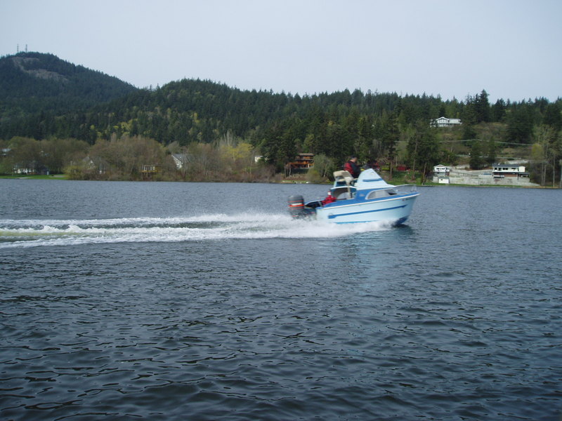

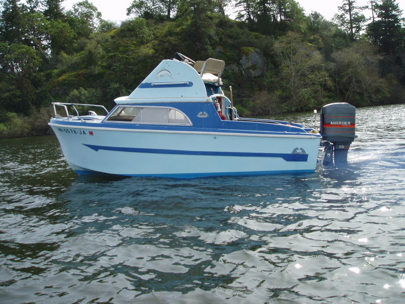

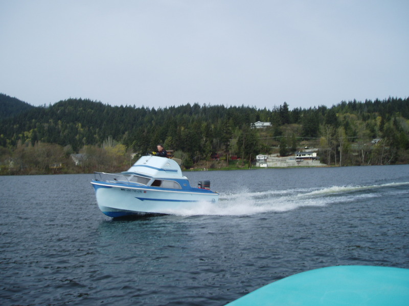

I just launched my rebuilt Mariner.
Ran excellent, although I need to tweak the idle up a bit for next breakin run. Put about 12 gallons of 25:1 through her, first 10 below 3500rpm.
