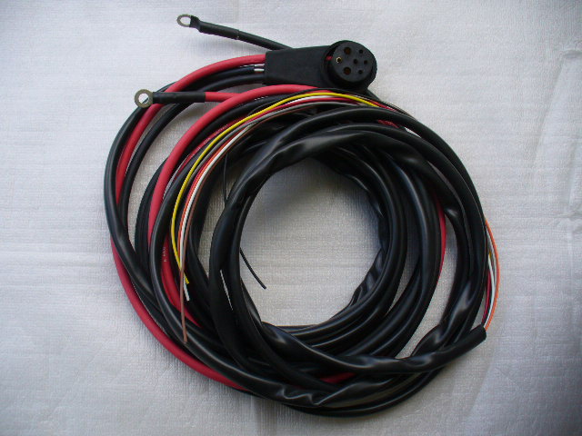

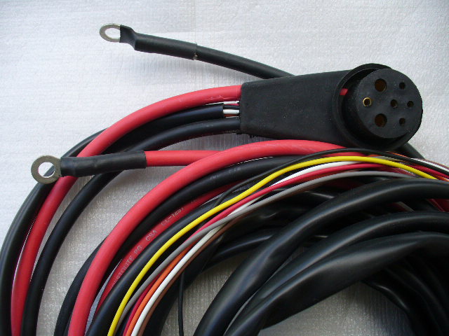

Here are a couple of pictures of a new aftermarket 20' wiring harness that we sold to a customer fairly recently.
Joe

Re:new controls for 1969 Merc 1000-100HP, 15 years 4 months ago #34675
THat is the same one on my friends boat. I just put a new ignition switch in yesterday and the wires were shot. I re routed the cable and it gave me an extra foot to work with I cut it back and the wire was much better. Just to be safe I put shrink wrap on each wire and one big piece on the set to support it. Then re soldered everything. If you can do the same maybe you can get to good wires to work with.
