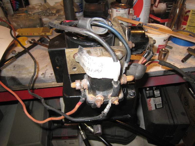

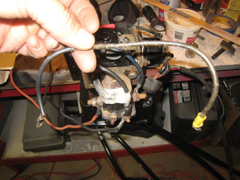

Got everything ready to go, but am afraid to touch power in large part because I got a jumper wire I can't figure out where it goes, and do I need power to the dash switch?

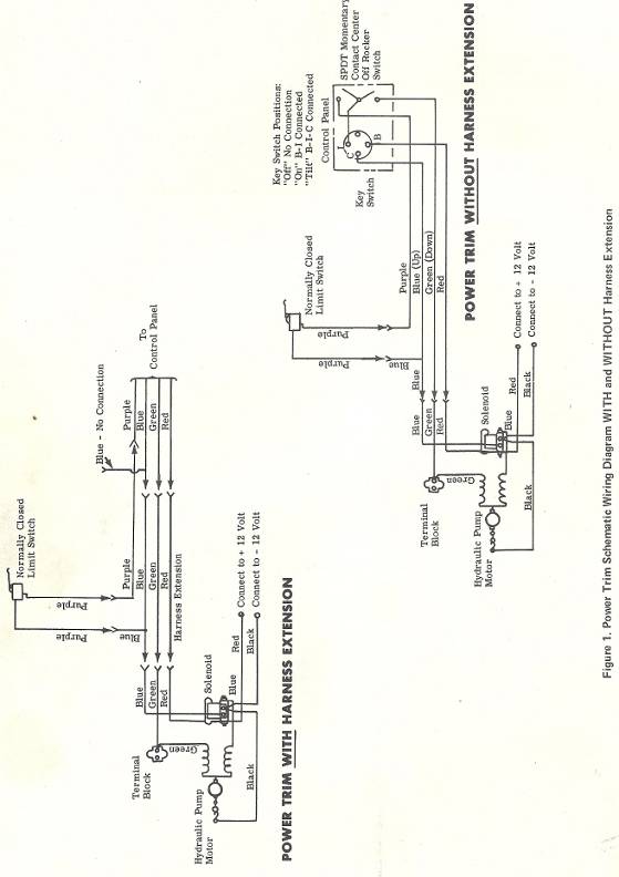

I could really use some good pics of wiring for one of these dual solenoid trim set-ups. All I want to do is bench test it, but I'm afraid I'll just burn it up if it's not right. I've already screwed up enough on this stuff without making it even worse! Factory wiring diagram seems to be of little use.

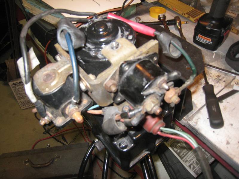

Got everything hooked up, filled the oil reservoir, hooked up power, motor tilts up! Woo hoo! Ooops, supposed to go down too, right? Nope, can't get it to go down.
Frank
Re:Help with trim wiring 16 years 7 months ago #3437
Got it to go down by bringing direct battery + power to the green wire coming out of the electric motor. I think I need a new solenoid.

Re:Help with trim wiring 16 years 7 months ago #3439
Yup.
To confirm, swap the solenoids.
Re:Help with trim wiring 16 years 7 months ago #3443
They're two different part #s Chris, but I think they both work the same. Looks like the one I need is Sierra 18-5815. The other one looks to be 18-5836. I was planning to replace them anyways. I'll replace those and go from there.
