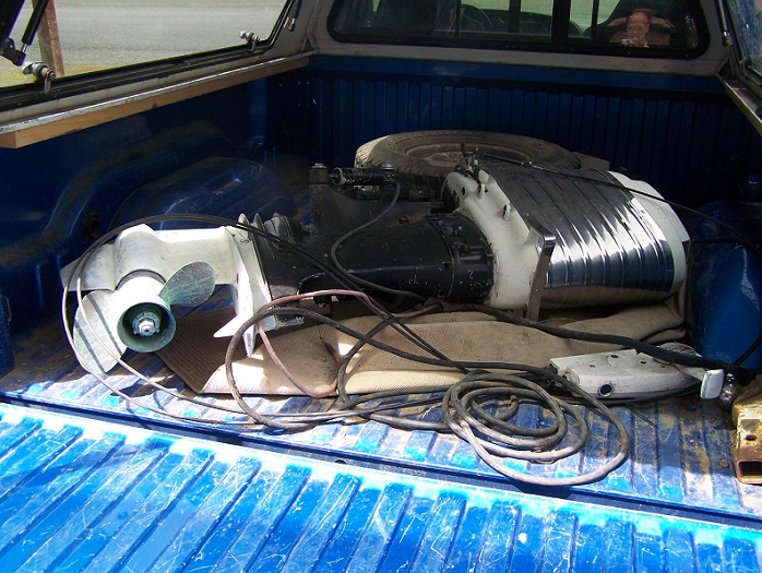

Got her home and put in the shop.
This is the first time I have seen a trim tab like this one.
Any thoughts on it?

That's where the water pickup is located Neil, there will (should) be a gasket between it and the gearcase housing. I used to have a '62 700FGS - great motor! (That black DSH has gotta go, though. LOL)

Question to Mark... I cannot imagine how the heck some holes drilled thru the anode tab (or whatever that thing is that both acts as an anode to avoid corrosion of metal in the motor and at the same time compensate for side pull of the prop wash. (terms are not important much less correct I am sure)....have anything to do with picking up water?

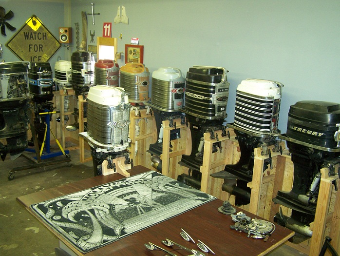

On another note.... Neil...you are the MercFinder but it looks like you already have some combo whites and blacks in your inventory so this should fit in till you get to them all right?.

I indeed do have a couple that are original white motors that the previous owners have taken the liberty of changing colors on.

I just picked one of these up a couple weeks ago...mine's a 1961 700 "E" full gear shift... and I was just as confused about the trim tab holes. I ended up needing a new water pump base which meant switching to the 700 E-1 pump style because it was all I could find...still picks up through the trim tab but the hose (which you'll soon find) goes into the pump base instead of the housing. Suffice it to say I'm quickly becoming familiar with this beast.
Tim - That trim tab doesn't have any anode capabilities, it's painted aluminum from the factory. It serves to counteract torque steer just fine, didn't have any issues with that. (Guess there's enough "non-holed" material to do the job?) When the lower is bolted up to the DSH it forms a "cavity" or "chamber" for the water, and as apson stated there is a pickup tube that comes from the water pump base down to the cavity to suck the water up into. (Maybe the pressure of being submerged pushes it up there, not sure about the sucking part.) I was lucky and didn't have to pull the wp base, just replaced the insert (liner), plate, and impeller, and of course the gaskets and seals on mine.

The fin is NOT an anode it is the water pick up and trim tab only

In other words that trim tab is hollow inside. Water goes into it then into a tube then that feeds the water pump. There are no water inlet holes on the side of the gear case. And there is not water inlet hole under the cave plate like a MK 55. The trim tab is it.
What you cannot see in the photo, is that the leading edge of that trim tab is completely full of holes to suck water in. The side holes were added later I believe. Ive never seen the side holes from factory.

later ones came factory with the side holes don't break any of the water pump part are hard to find. impeller is the same as the later big 4's and 6's

merc 450 had that water pickup also
