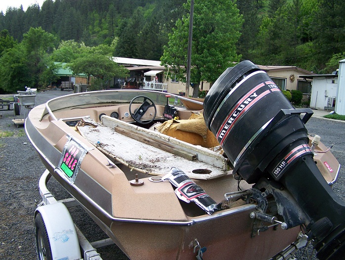

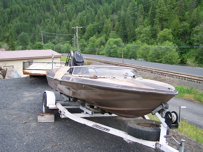

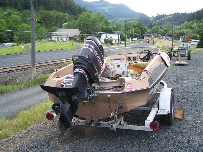

I found this guy needing a new home.
Motor alone, $200.
Motor and boat, $350.
Trailer, $300

that is a gnarly merc. nice combo on that boat.
Re:1350 15 years 4 months ago #34061
That is a nice motor! Id buy it for 200. The boat is nice too! Very nice trailer!

Guys
Seriel # says this is a 1970.
Is 70 and 71 the only two years for the 1350?
Any thing in particular special or different with these?
Thanks.
Neil
Neil and Mary Ousnamer
Re:1350 15 years 4 months ago #34064
Hi Neil, yup just two years. The exhaust portion of the block is different(oval)than the later inlines so the powerhead is not interchangeable outside the 70, 71,72 era. The 1150 shares the same design in 72/

Sixteen foot Sidewinder???
Re:1350 15 years 4 months ago #34087
Sidewinder or a clone, of which there were many. I'd guess it's a clone. Wish it had been nearer NJ. I'd love another Sidewinder.

I always thought 1965-1971 mids were interchangeable? Ive got several up on top of the garage, Ill have to look at today.
The 1350 is the first direct charge motor. It has the newer style piston design. Only without the power port.
The 1350 had a small exhaust baffle added to the exhaust tube to split the exhaust as it entered the tube.
The 1350 is the only motor that came with a tall 1.78 gear ratio from factory. The rest of the inlines have a standard 2-1 lower unit.
The 1250 shares the same design in 72
1250 was 1968-69
Thats all I can think of right now

neil,
wondering what make of sidewinder that is?
ran across a few in my area? they look to be a good boats for big Mercs.
this one interior looks a bit rough...
so you scored everything for $200 nice ;)
wondering how do you fall onto these deals dang!

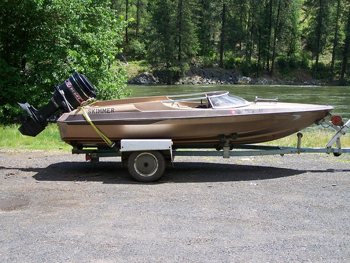

Well guys, I drug it home this morning.
It is a 16'.
Plate says Sunset Boat Co. Silverton, Ore. then the seriel.

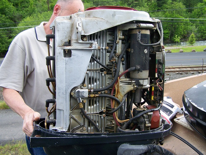

I did the compression this morning.
1. 125
2. 124
3. 118
4. 125
5. 128
6. 125
Looks like I will keep it.
It is the big kid on the block.
The boat? Well I have a long shaft 650 that needs a test rip.
Gonna shoot for the 4th of July weekend. My friend has a 17 foot Reinell that I need to show my transom to and I told him I wouldn't need one of my "Big Block Mercs" to get that done.

Nice looking rig!!!! one note tho. From 1965 and newer that lower cowling is free floating and is held on by rubber mounts at the top of the motor. Lifting on the lower cowl can be a problem. (ive done it too :O ) But the safest way is to lift them via the flywheel. You can tear your rubber mounts up lifting it like that.
Conrad
Re:1350 15 years 4 months ago #34458
  • Neil
  • Neil's Avatar Topic Author
  • Posts: 1997
  • Karma: 65
Thanks Conrad
You may have just saved me a headache.

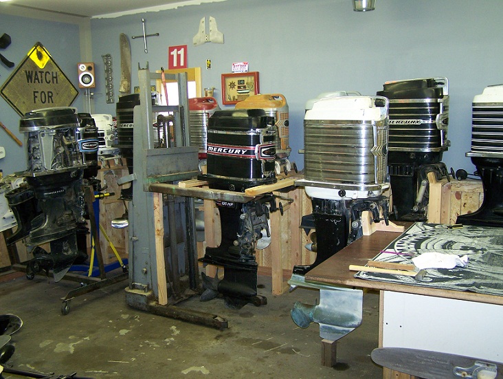

Funny thing is that I was always an OMC guy having grown up learning to first ski behind my dads cedar strip boat with a "red" Johnson 10 hp...yea I was small and young. Then later he swapped it out for a "green" 25 Johnson and then we were flying on the old planks. Fast forward to later teenage and my dad got a nice aluminum Springbok(we were in Canada) 16' with a nice Johnson 50 that seemed to fly way down the lake to the bay we fished in.
But ever since I found an old 60's little Boston Whaler that I restored and then found a 60 Merc 300 in a barn and woke it up and the found my baby ... a mid fifties cold molded mahogany ply runabout ...all original with a nice red/white Mark 55... I have been a Merc convert and big fan since. Found and restored several others since and the inlines sure work nice when tweaked.
So...after that diatribe.... needless to say I am in complete envy of not only your great collection but also of your shop set-up. I do not have that luxury but maybe some day?
My dream is to someday have a nice big heated building with lots of room for several boats, tools, and of course motors. For now I just stay above water every year by finding and restoring and selling boats and motors and trailers destined for death and try very hard not to dwell on the nice things I have resurected and then let go,
