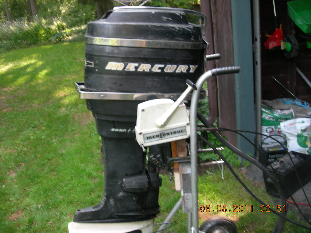

Did you try it with the throttle lever in neutral Tim? In the pic it appears to be pushed forward, or if defective it could be the neutral safety switch preventing spark? Just a thought, hope it's something simple. Nice find, BTW!

Throttle and shift are not connected(only harness) and it is in neutral. I read one of Chinewalker's posts on I-boats and he explained that the points had to be 100% clean so I will remove mag and do it again. Also I should have the coil checked while I have it off I guess. I'll post a picture of insides when I get it apart.

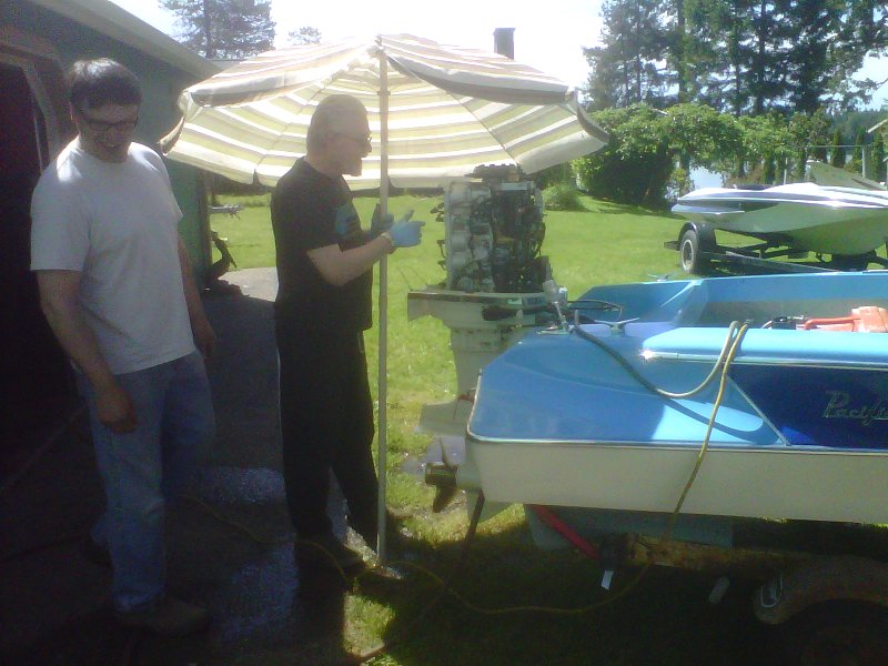

Last weekend, Dr. Frankenmerc was helping a friend light off an 800FGS that had been sitting for some time. Water wasnt coming out the telltale hole properly... so he grabbed a good sized tie wrap and fished it around inside the hole and it started peeing like it should.

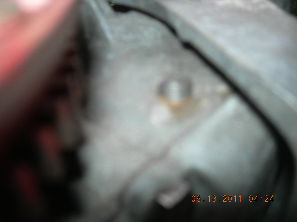

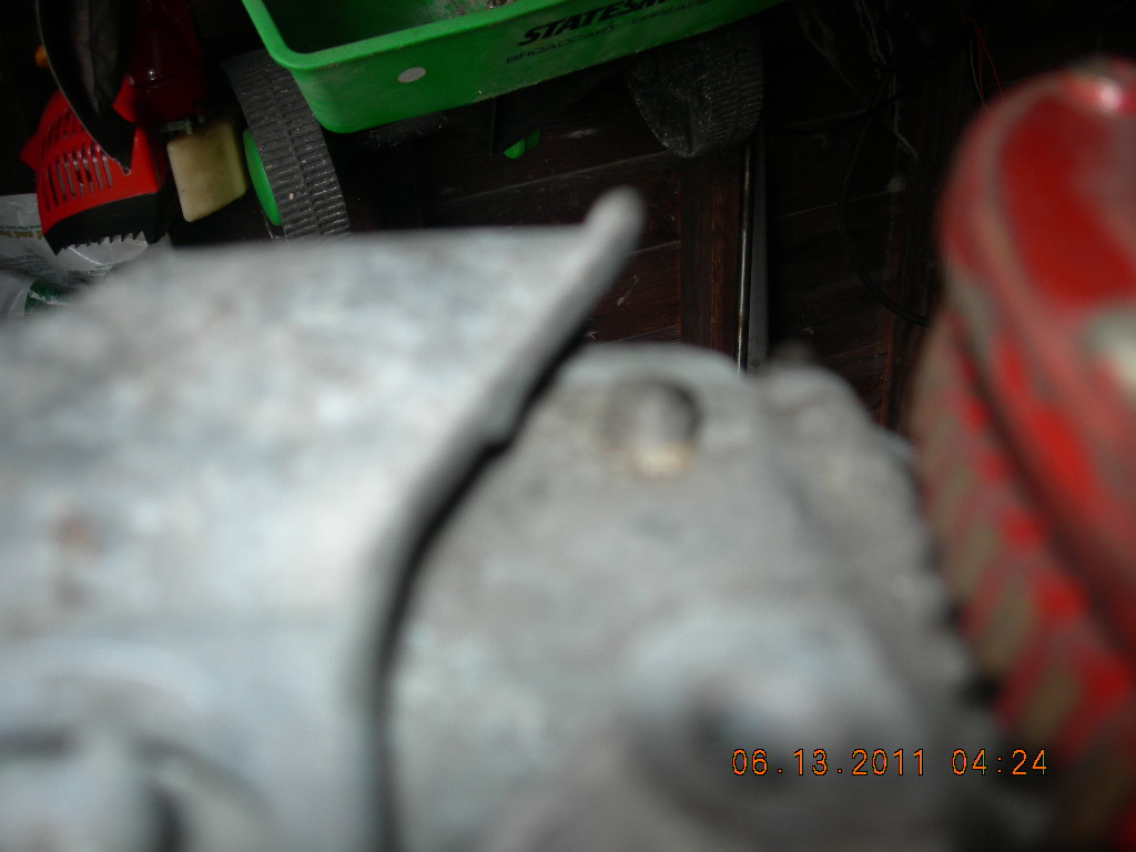

Hang on now... I just noticed what appears to be a screw/plug with a slotted head already in the top of the block. It may be spot welded or soldered though on the one side. Gonna take a pic and add it here shortly. Hopefully I can use it to tap into and re-route the tell tale?

Re:Merc 500 - No spark 15 years 4 months ago #34044
that plug is used with a sealer. remove it and replace it with a elbow for a tell tale if needed
