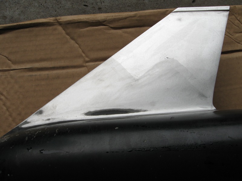

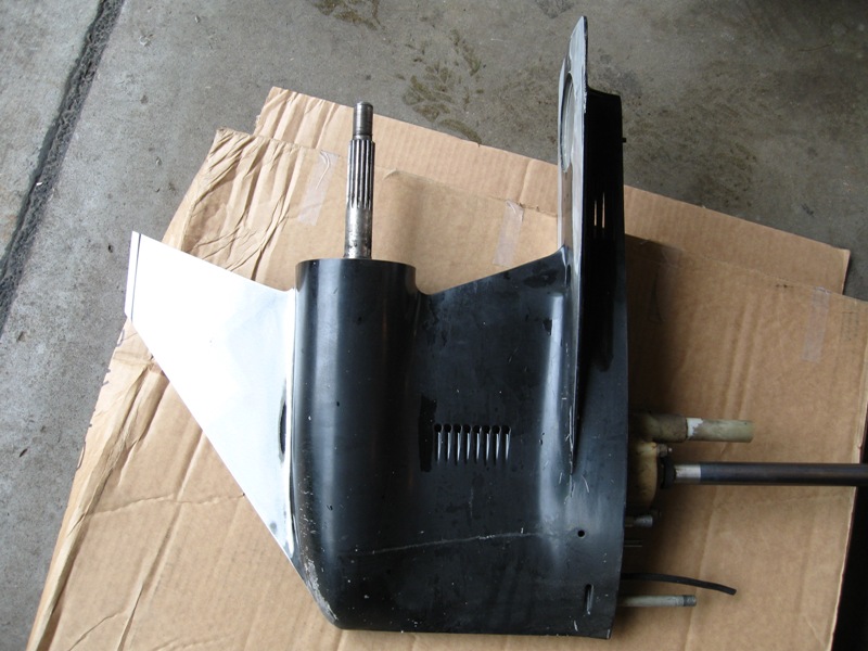

The welder zigzagged a new bottom half to the aluminum skeg. Better than disturbing the weld at the top of the skeg or joining it in a straight line. Skeg from 1988 Merc 115 HP.
Re:Solid Way to Weld a Skeg 15 years 5 months ago #33027
Nice to see a structural repair. Im guessing your welder grew up in the aircraft welding field. Not too many backyard welders that are confident enough of their weld penetration to grind off the bead.
Re:Solid Way to Weld a Skeg 15 years 5 months ago #33039
  • Robby321
  • Robby321's Avatar
  • Posts: 902
  • Karma: 42
  • Thank you received: 10
That guy knows what he's doing...excellent work!

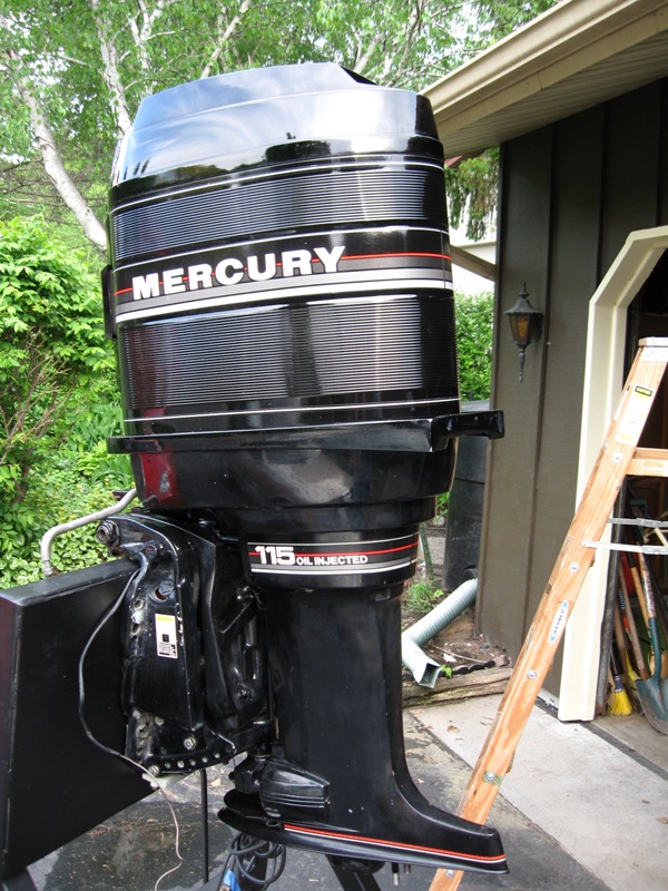

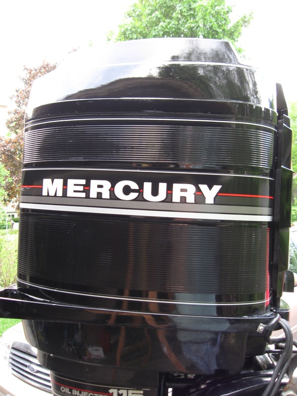

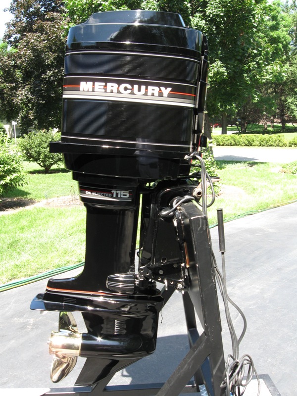

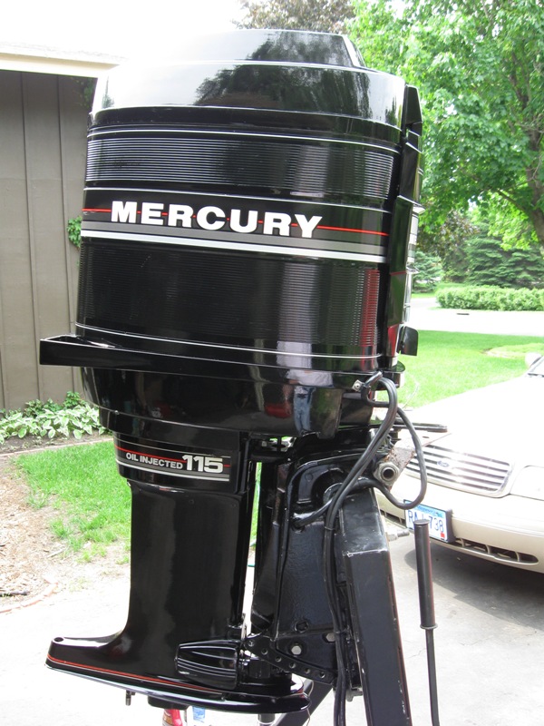

Skeg will go on this motor.
Touched up small scratches and nicks in more than 100 places with a small artist's paint brush dipped in paint sprayed into the plastic spray cap of Mercury Phanton. Touched up the top, cowl and front panel. One side of the cowl is specked with small white spots which I will have to live with.

Re:Solid Way to Weld a Skeg 15 years 4 months ago #33881
  • dpanky
  • dpanky's Avatar Topic Author
  • Junior Boarder
  • Junior Boarder
  • Posts: 109
  • Karma: 11
Midsection touched up and buffed and waxed. Lower unit is at paint shop.

My advice is to find an experienced aluminum welder. Welders can be good at steel or stainless steel, but have no experience with aluminum. The best person would be a prop or marine welder who has done this very thing. There are tricks to the trade gained from experience.

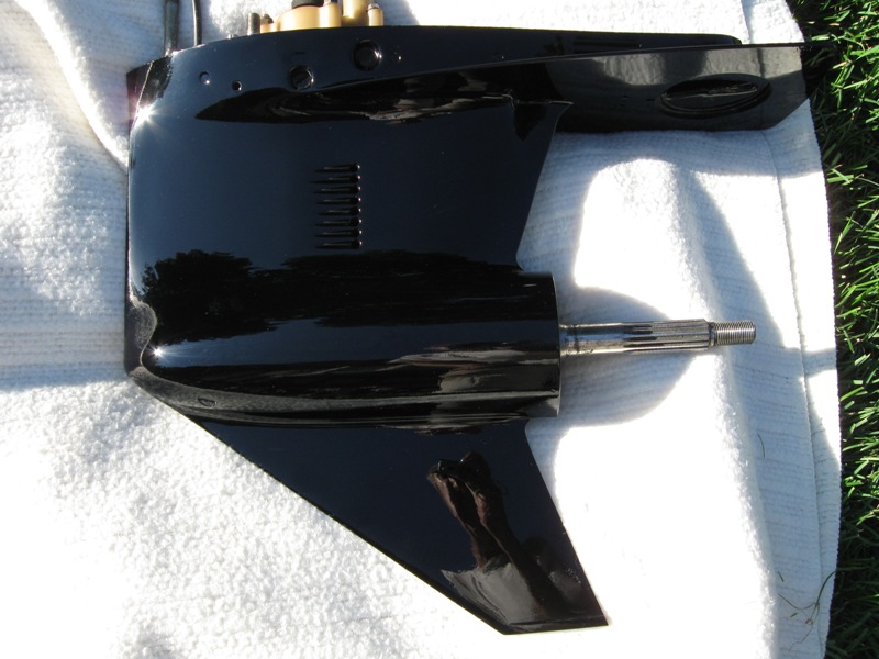

Re:Solid Way to Weld a Skeg 15 years 3 months ago #38227
  • dpanky
  • Junior Boarder
  • Junior Boarder
  • Posts: 109
  • Karma: 11

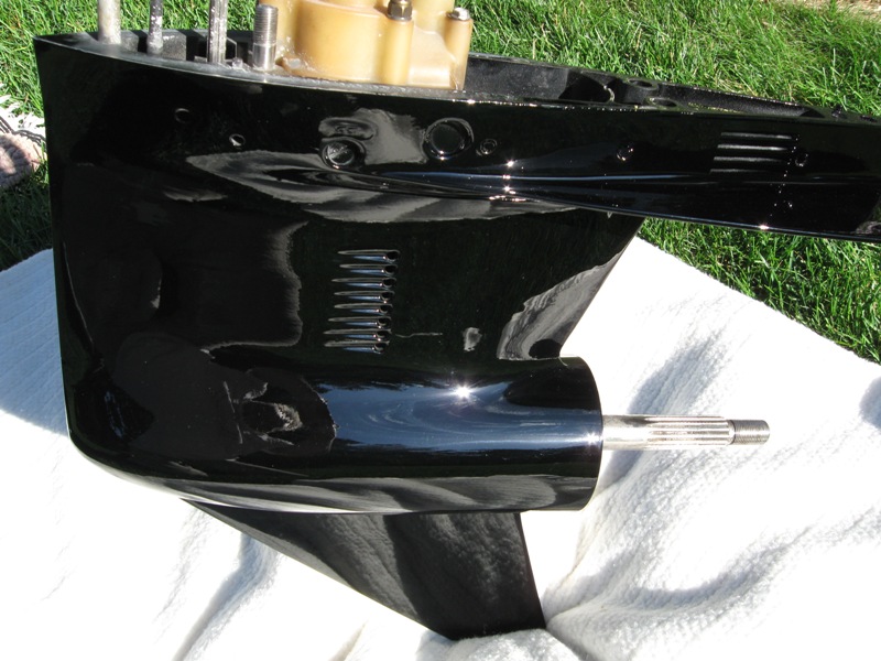

Lower unit back from paint shop with three coats of paint. Next is to install on motor, connect controls, battary, and start the motor on the motor stand.

Re:Solid Way to Weld a Skeg 15 years 3 months ago #38256
I agree.
Plus, there are slightly different consumables involved.
Beyond that, you get what you pay for.
Expect to pay more for a guy that "knows his stuff."
BTW
The skeg weld pictured above is pure art.
plus, the welder knew to spread the load and stress points over multiple surfaces; not likely to break under any impact.
Great Job
lar

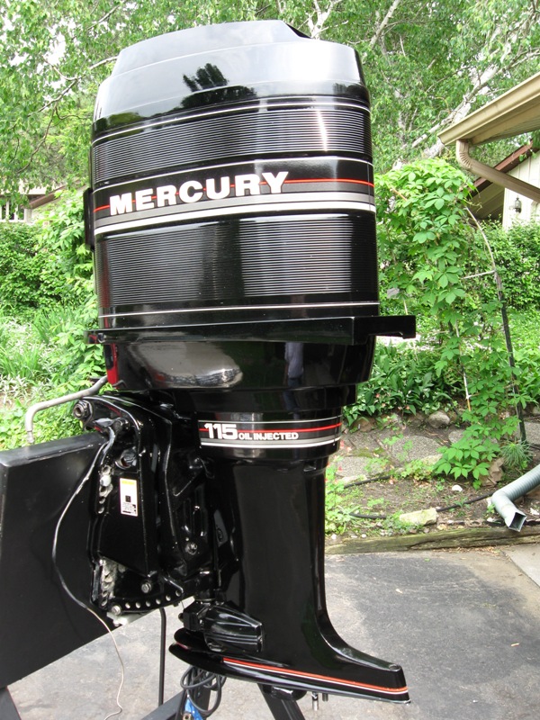

Re:Solid Way to Weld a Skeg 15 years 3 months ago #38552
  • dpanky
  • Junior Boarder
  • Junior Boarder
  • Posts: 109
  • Karma: 11

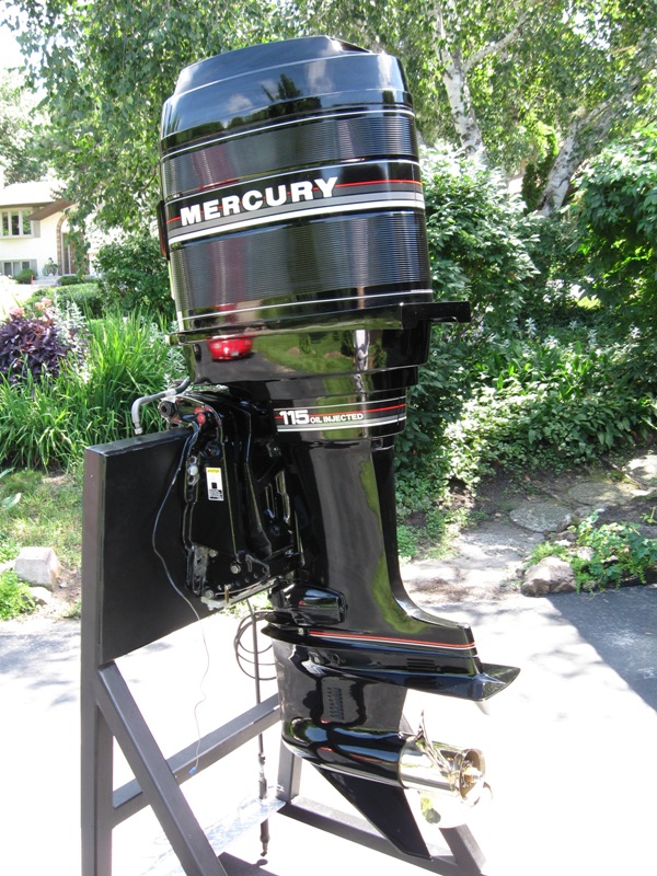

Painted lower unit installed on 1988 Mercury.
Re:Solid Way to Weld a Skeg 15 years 3 months ago #38554
Beautiful!
